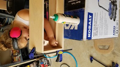

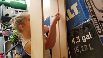

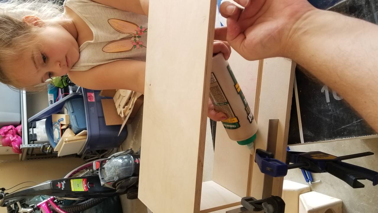

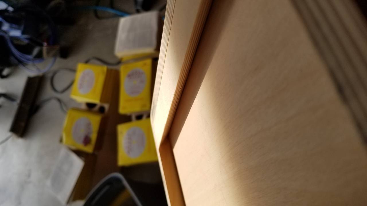

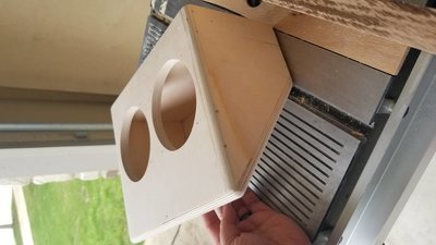

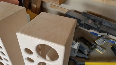

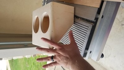

A little more progress today, got the SLAs assembled, still need to round over the edges and fix any blemishes. Had my littlest one out helping me today. She loves working out in the shop with me. For some reason, she LOVES spreading glue......at least I dont have to do it

More pics of today's progress.
Here are the surrounds, sanded and French cleats attached.

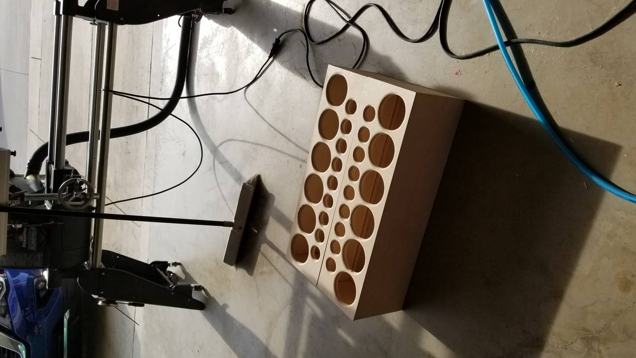

Last pics for today. SLAs glued up and waiting for the router to finish em off.

Thanks guys! Yeah, I had to round over the entire surround, because the way my movie room is laid out, these will be just above shoulder height. Didn’t want anyone going to the ER if the whacked em in the dark.
Plus, I think it gives a more organic feel to them, but that’s just my .02.

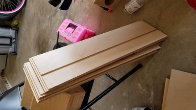

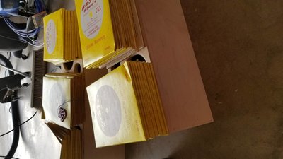

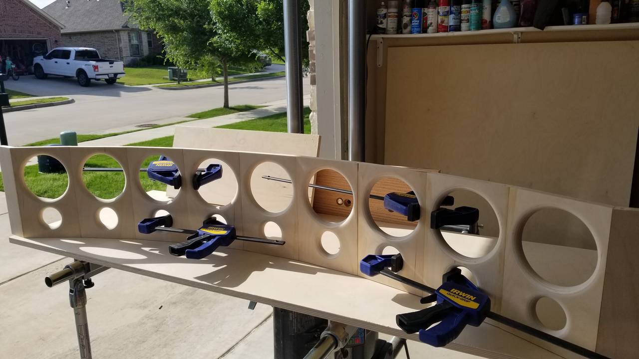

I went out to work on the SLAs some more and my glue monkey wanted to help prep the curve baffle. So I showed her how to use the random orbit sander and sent her to town. After that, I took the SLAs to the router table and rounded over all the edges. I did get some tear out from between the plys and off the top ply, but some sanding started to tame it down. Tomorrow will be some DIY putty and fill in the low spots and brad holes. Then it's time to sand and set those aside for priming and painting. Next was the glue up for the curve baffle. That was a challenge in and of itself. I ended up using brad nails to get them in groups of 2. After that I was able to just use clamps and glue. I found that if I set them on the ground smeared with glue, then lined them up top to bottom, I was able to then just clamp the holes together and it raised them up nice and flush. Wish I had done that first, woulda saved me the aggravation of sanding down the brads. I noticed that my top and bottom are narrower than the baffle. I will have to bend it a good 1/4 in to get the end segments to line up. This will create quite a sprung arch. Is this normal? Or should I cut another top and bottom?

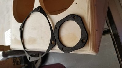

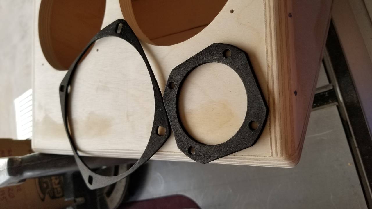

And last but not least, my neighbor bought himself a GlowForge and agreed to laser cut all my gaskets for me. For every single speaker. Took him 45 minutes. Saved me gobs of time, but they all fit like a glove and now I dont have to mess with tape for those.
