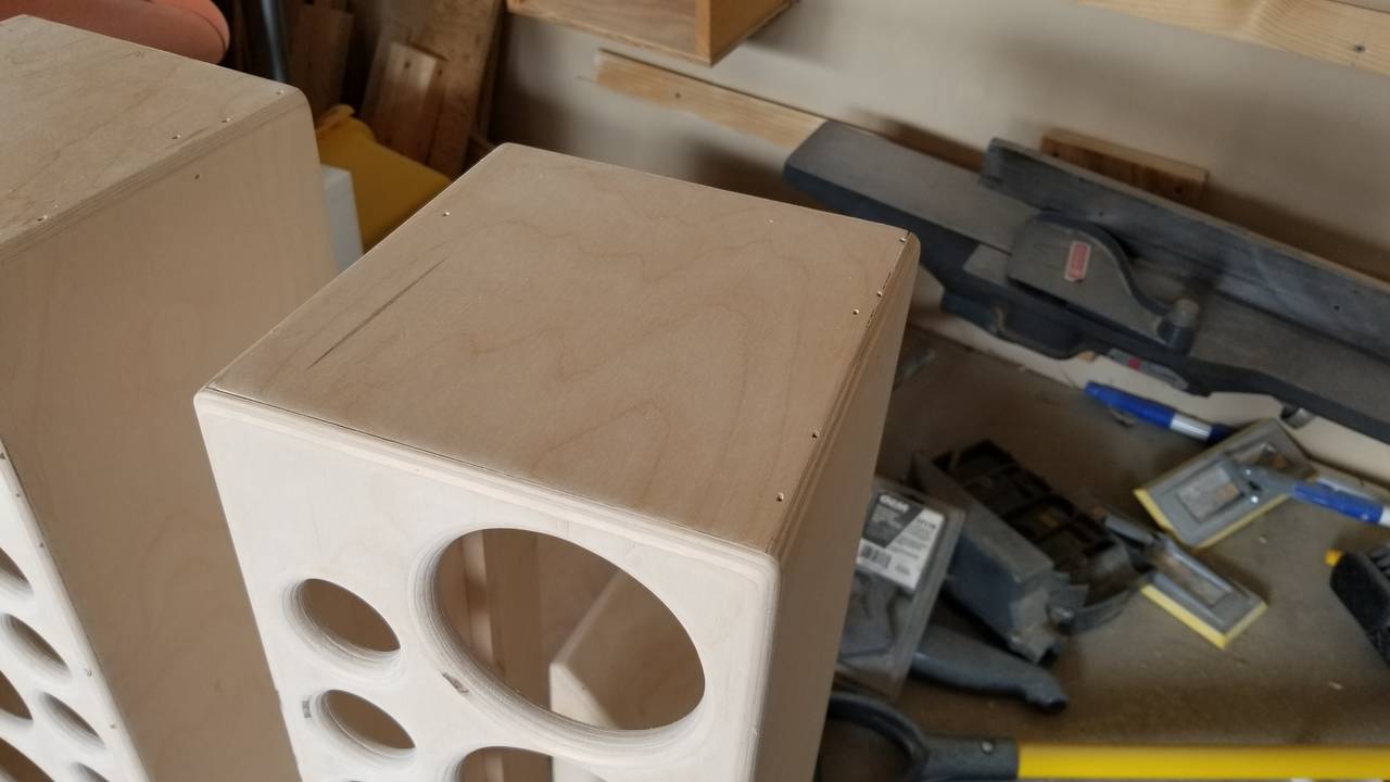

Last pics for today. SLAs glued up and waiting for the router to finish em off.
Sides together, baffles fit waiting for glue.

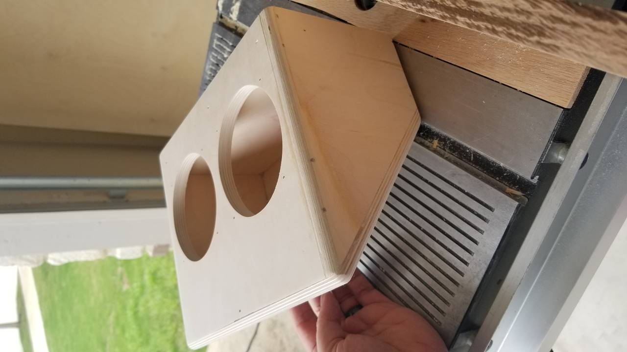

After that, I took the SLAs to the router table and rounded over all the edges. I did get some tear out from between the plys and off the top ply, but some sanding started to tame it down. Tomorrow will be some DIY putty and fill in the low spots and brad holes. Then it's time to sand and set those aside for priming and painting.

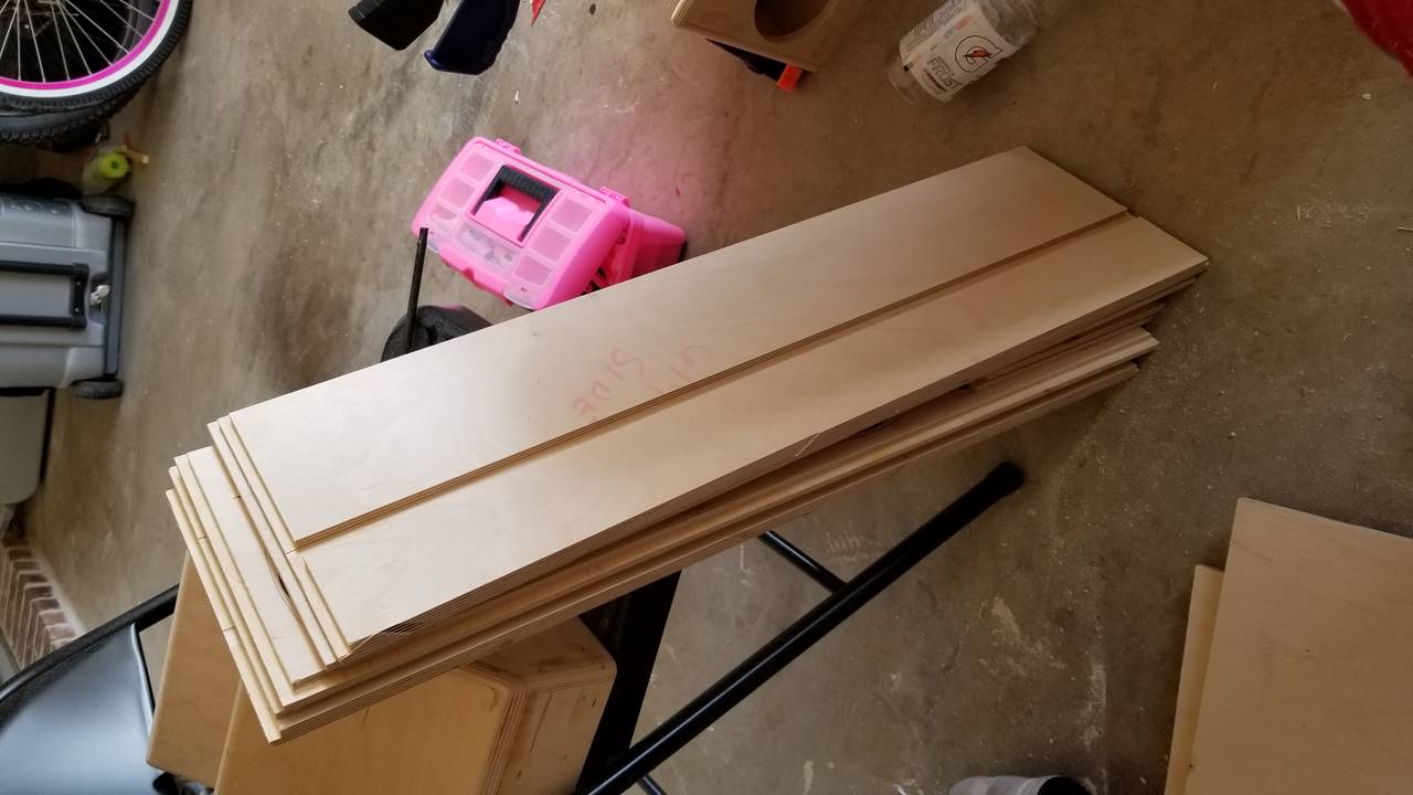

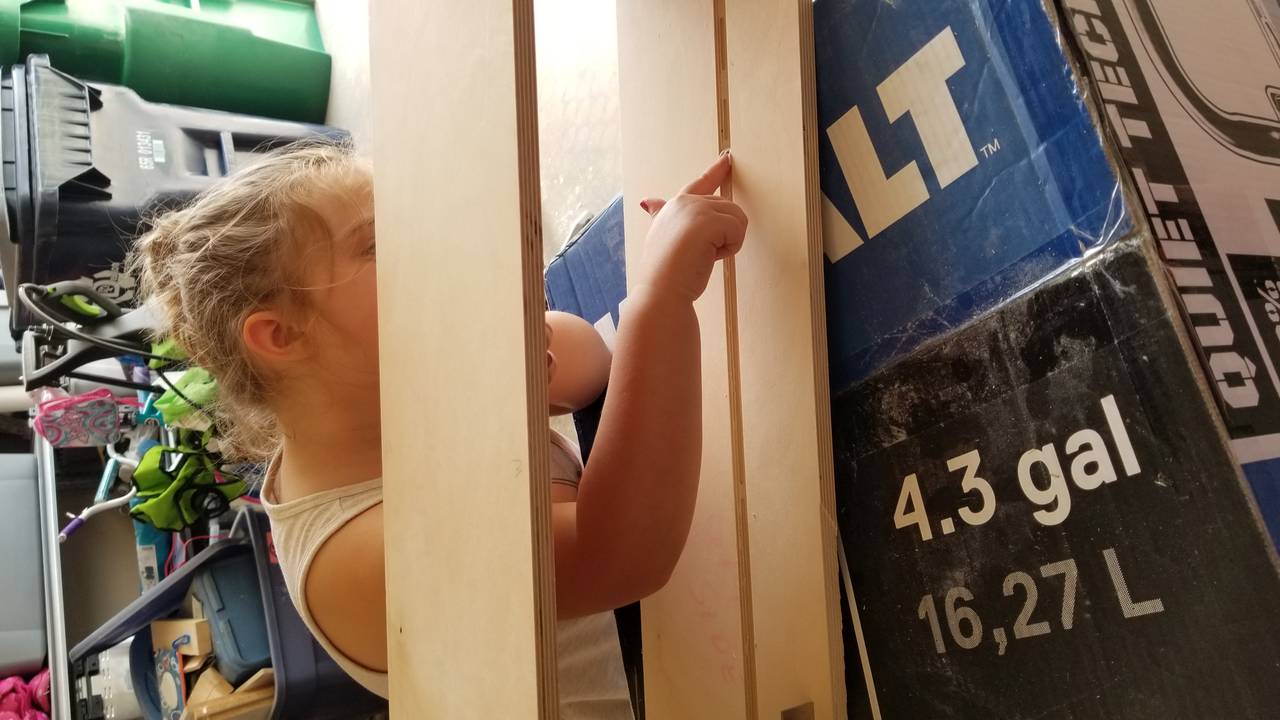

Next was the glue up for the curve baffle. That was a challenge in and of itself. I ended up using brad nails to get them in groups of 2. After that I was able to just use clamps and glue. I found that if I set them on the ground smeared with glue, then lined them up top to bottom, I was able to then just clamp the holes together and it raised them up nice and flush. Wish I had done that first, woulda saved me the aggravation of sanding down the brads.
I noticed that my top and bottom are narrower than the baffle. I will have to bend it a good 1/4 in to get the end segments to line up. This will create quite a sprung arch. Is this normal? Or should I cut another top and bottom?
