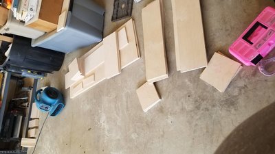

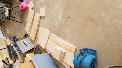

I never realized that ripping down a 5x5 sheet would be so tedious. I didnt have the real estate for ripping it on my table saw, so I had to knock up a quick straight guide for my ancient Black n Decker circular saw. Once that was done, I was able to rip em down fairly easily.
I ripped the pieces to the center baffle about 2 inches wider than necessary. I plan on cutting them to final dimensions after cutting the holes. This way will be less cumbersome than trying to alternate bevel on a longer piece of stock. Next, holes.....lots and lots of holes.

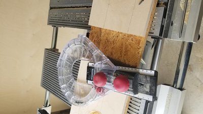

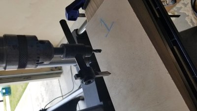

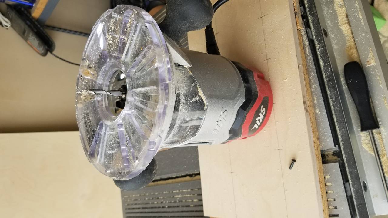

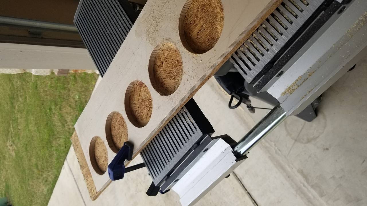

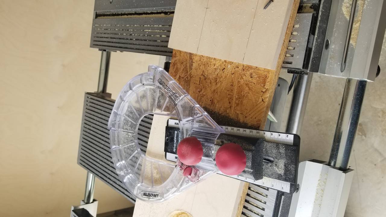

Started off using this cutter. It took me an hour to cut 3 holes. Even after pulling the blade and sharpening it to chisel sharp, it just would not make it through the BB in a timely fashion. I dont have a handheld router, so I had to ask my grandfather to borrow his. Went to Blue Box store and snagged this jig for $40 bucks. Made the process much easier. Not without issues though. First off, I wish it had a pin system, instead after every hole, I have to unscrew the pivot screw to move on. Overall, not bad but still more time consuming than a jasper jig. Having a plunge router would be a great help as well. Using this fixed base router works, I just have to stop the router completely before adjusting for the final cut of the hole. Plunging would eliminate this step. Still faster than what I had. Once I get in a rhythm it just seems to progress on autopilot.

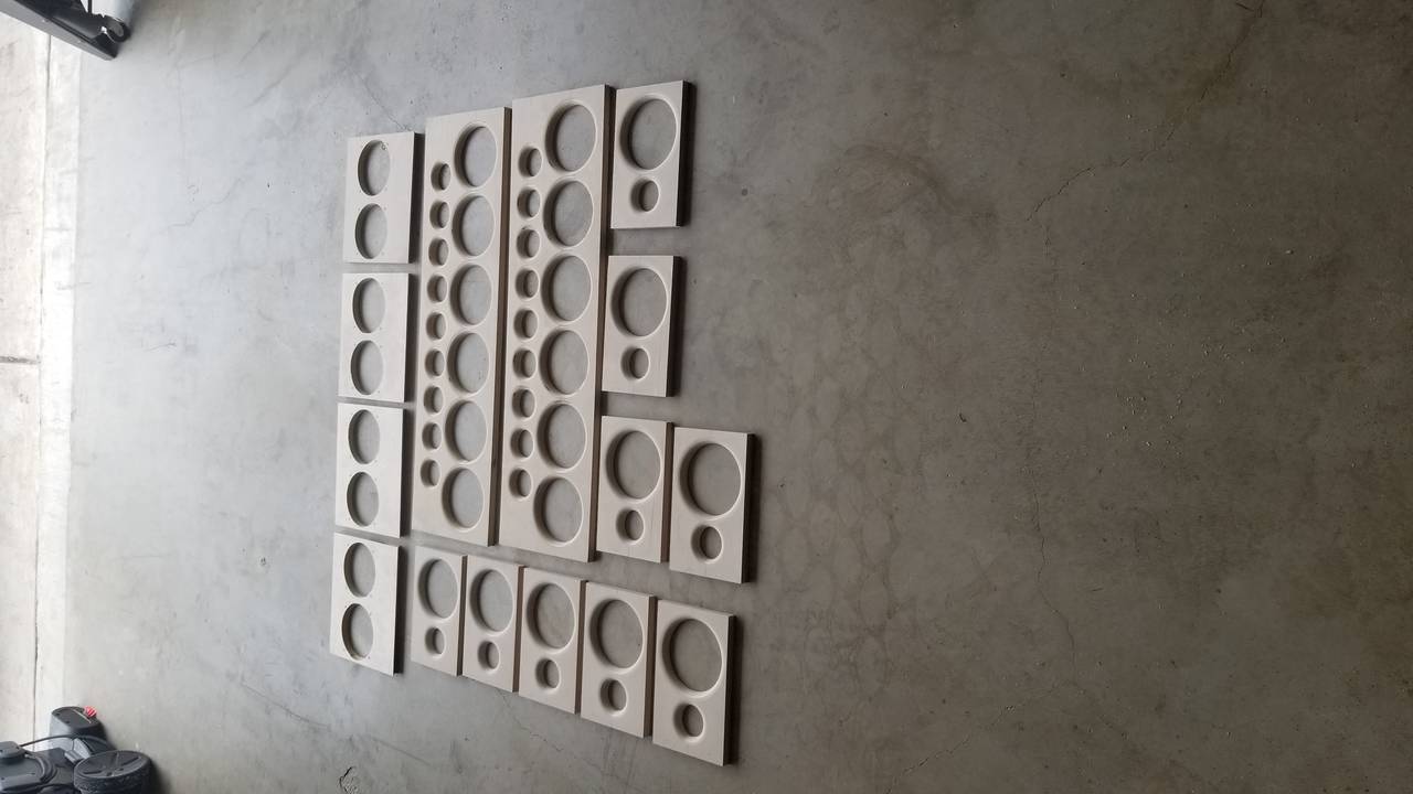

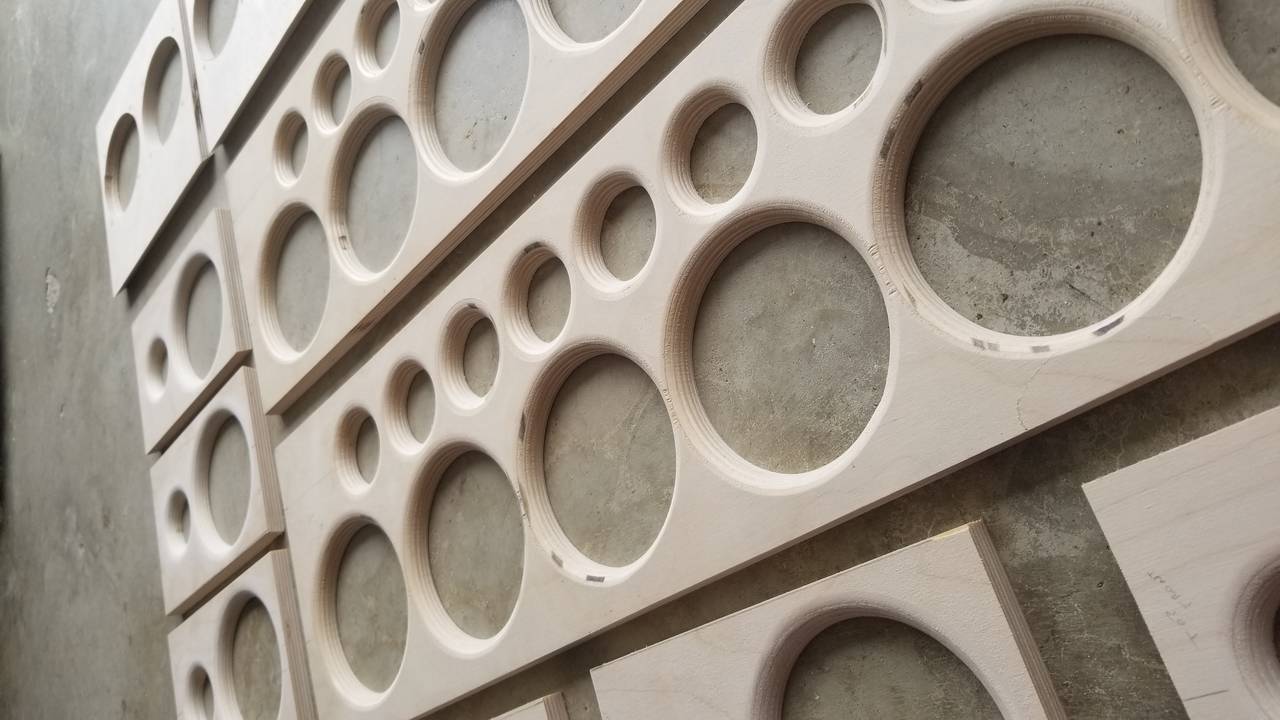

Here's the baffle pics, finally got them all rounded and sanded. I put the 4 surrounds together tonight, I'll post pics of those in the next few days once I get them all sanded down.
Question about the 6/9 edge round over. Do you guys glue/brad first then rout? Or the other way around? I'm building completely out of 1/2 BB so I'm concerned about hitting a brad with the bit if I do it after glue up.
