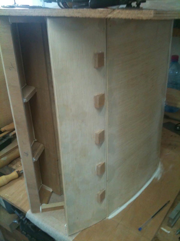

No this this an ultra resistant Pu glue...it's not the transparent one you are using in the usa but it's an equivalent to your loctite that is quite hard to find here 8)
It looks like silicon cause i've trimmed the excess with my fingers when it was not dried.
Don't worry it's also an expansive version and all will be really air sealed ;)

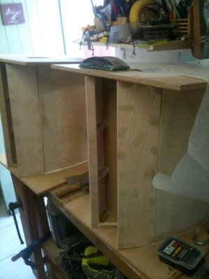

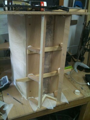

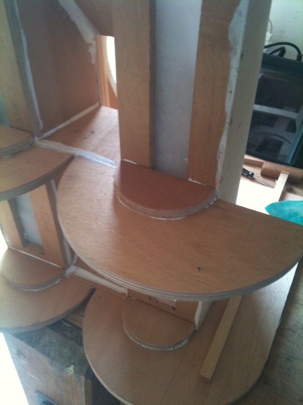

ok today i've put horn sheats in place and begun to install the pvc pipes...
mine was a bit too "soft" ( 120 mm grey diameter wasn't in stock so i've used 115 mm roof gutter ) so i've made some little cleats to block them...
pvc pipes in place
pvc pipes in place
extra little cleats
extra little cleats

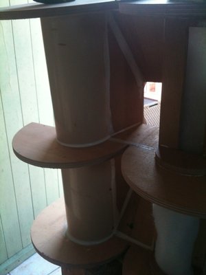

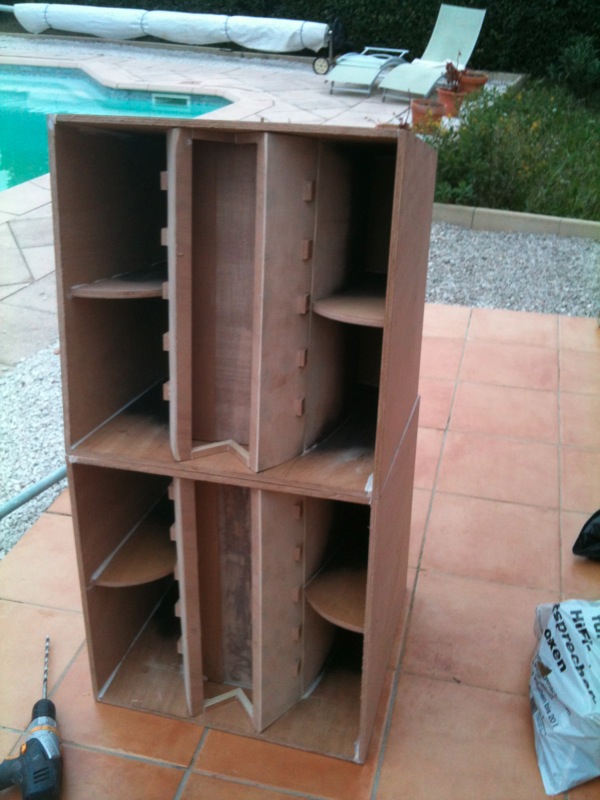

so life goes on and so do the building...
i'm reaching the dangerous point...the nacelles...
...and with some PU glue

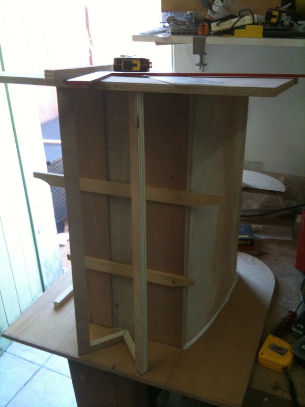

at the beginning of the building process...

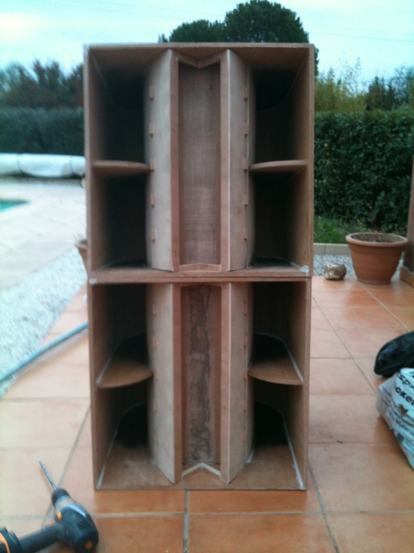

the nacelles are ont the way now...i'm going to attack the screwing system of the modules...
just a look at the DRs with the modules in place...
right...
right...
left...
left...

still working...

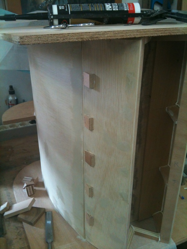

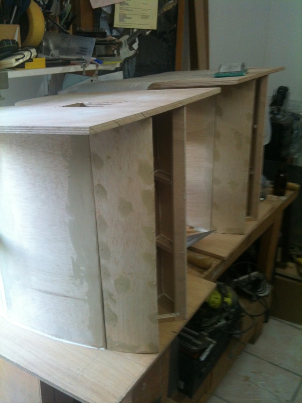

hey everybody...it's been a long time !
so some progresses have been done...
it's beginning to look like big boxes !...
and now let's fill the holes, sand, paint, sand etc...

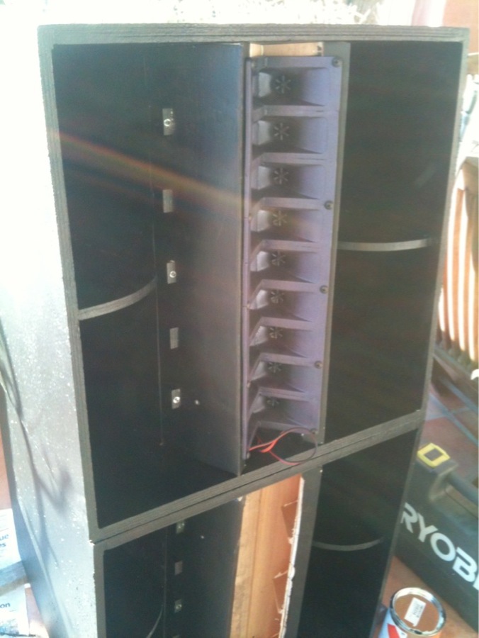

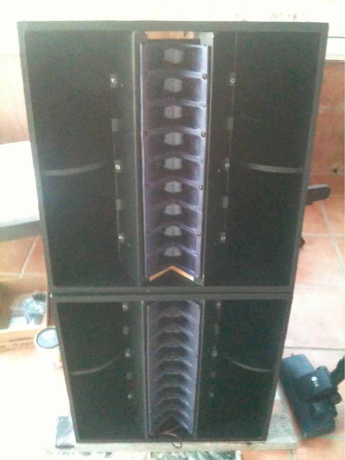

hey it's been a long time since i wrote my last post...i've been quite busy doing my homeworks, ehhhh...correcting my students'homeworks !
We'll i've worked on my DRs the week end and i think i'm quite near to fire 'em up :)
so the tweeters modules are nearly ready, i've got some finishing to do to have them perfectly air tighted (see on the top and the bottom...little gaps to fill).
Screwing them perfectly with 3mm T-nuts was a little bit tricky but it's done.
i'm working on the filters now.
painted black !!!!...and texturized :)
screwing the modules with T-nuts and 3mm BTR...tricky !!!
tweeters on site to adjust the modules

Re: DR 250 in France...
#26 Post by Chris_Allen »
I didn't think that with the new Piezo module that the array had to be air tight.
Kranku68
Posts: 52
Joined: Fri Jun 20, 2014 3:15 pm
#27 Post by Kranku68 »
honestly...i don't know if it's really needed.
i'm sure it's not in fact regarding to the plans.
but when i'm in doubt i prefer to be a psychopath...In France you can translate this by "who can do the best can do the less". :chainsaw:

Posts: 28981
#28 Post by Bill Fitzmaurice »
Chris_Allen wrote:I didn't think that with the new Piezo module that the array had to be air tight.
It doesn't, all that's necessary is that the module joints to the rest of the cab be airtight.
#29 Post by DJPhatman »
Am I mistaken, or does the DR250 use a 20 element melded array? I see only 18 elements on the OP's build, hence why I ask.
#30 Post by Grant Bunter »
DJPhatman wrote:Am I mistaken, or does the DR250 use a 20 element melded array? I see only 18 elements on the OP's build, hence why I ask.
I noticed that as well.
I believe it should be 20 piezo's/cab, at least that's what mine are, and what my plans say...
