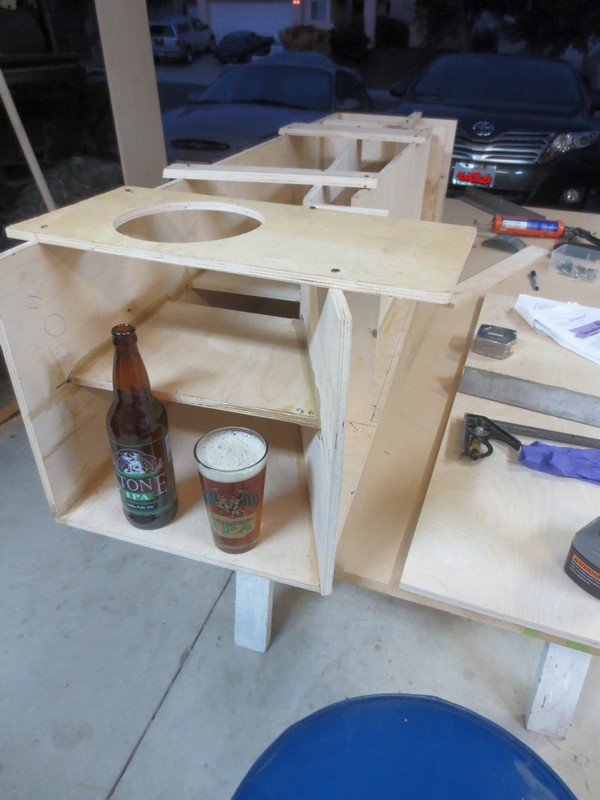

MTB goat wrote:Super proud of myself tonight! So, I have this router I used once over 10 years ago, but I thought I gave it away to someone. After digging around in storage, I found that I still have it. After reading various build threads and doing some online research, I made my own circle jig out of some plexiglass scrap that was laying around. worked like a charm! :D
Way to go!
Oh . . and I think I found the cause of your straight cut issue.
OTOH . . maybe your cuts would be even worse without it! :lol:

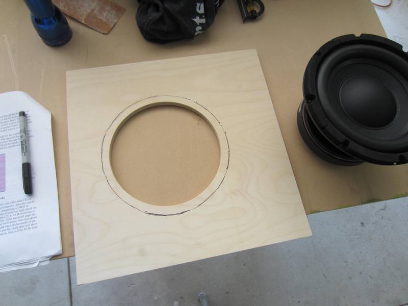

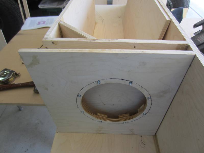

Question: After I cut the driver hole, the only way I could figure to line up the driver to mark the holes was by eyeing it. Looking down with the panel on top the driver, I tried to center as best as possible so the surround was even around with the circle. then made a mark around it, flipped it all over and lined it up with my mark and then punched the holes. Don't know if there is a better way?
Re: 15x15x60 TTLS no square cuts no clamps newb-build
#20 Post by Grant Bunter »
When you found the centre to draw your circle to cut, you could have drawn pencil lines on the panel, like a cross.
Since your driver has 8 mount holes, if you then have the line in the middle of the "top" and "bottom" holes on one axis, the either edge hole in the middle of the other axis, and the driver would be perfectly centred.
Hope that makes sense...

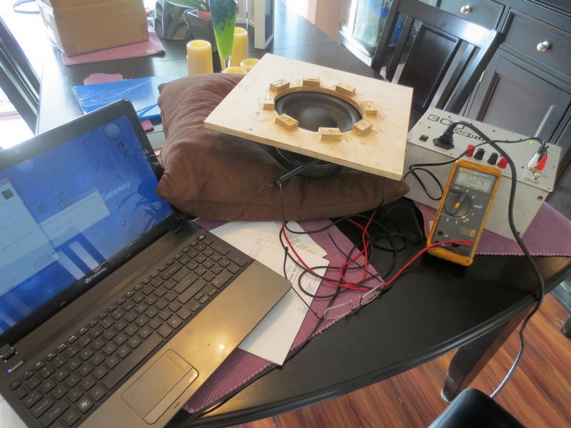

Newbie question about mounting the driver: do I leave the thick foam on the frame or take it off?
I started mounting it with the foam on it and I'm afraid to tighten the screws down for fear it will bend the frame.
I'm guessing just leave it on? doesn't seem right. lots of clearance that way though, but I'm afraid to tighten the screws all the way down. :confused:
trying it out:
Posts: 7674
#23 Post by Tom Smit »
Leave it on. Tighten each screw 1/4 turn or so once it make contact, going in a star-shaped (criss-cross) pattern. Keep going from one screw to the next until the screws are snug/tight (dont be ham-fisted).

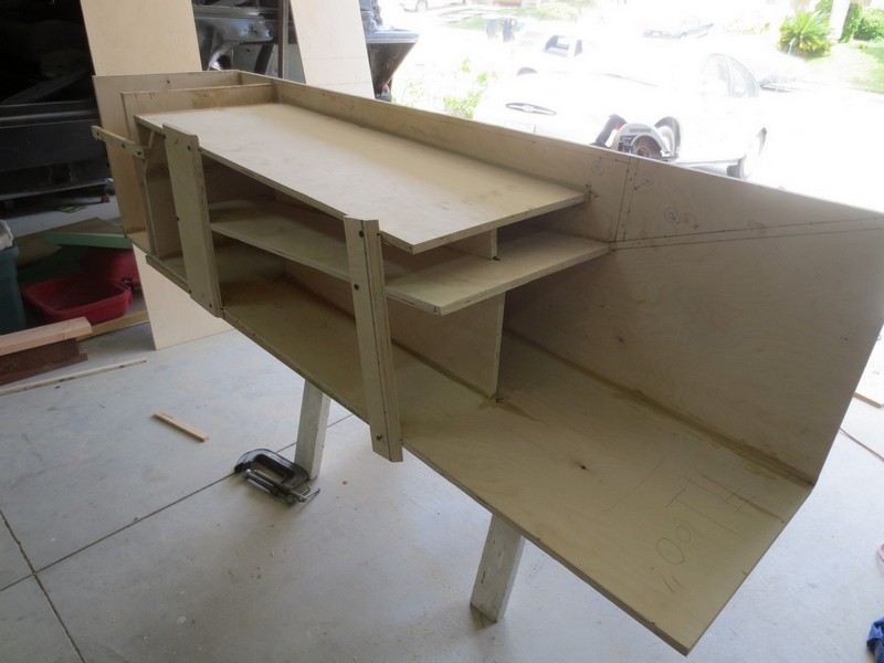

Unable to do anything for a few days, but then today work was dead so I cam home early and glued in a bunch of panels:

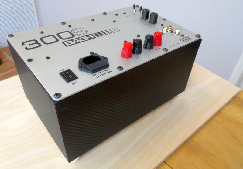

only took about 15 minutes to make the amp a little more handsome today. Tried some cheap carbon fiber look vinyl wrap. If I were to do it again, I would spay paint the MDF black first and let it dry. I went around a touched up spots where you could see raw MDF with a sharpie. I would also try to wrap the corners rather than cut them flush. I'm afraid the edges will eventually peal at the corners. this stuff is really easy to work with, but would probably stick better to painted surface. but anyhow, good enough for now.

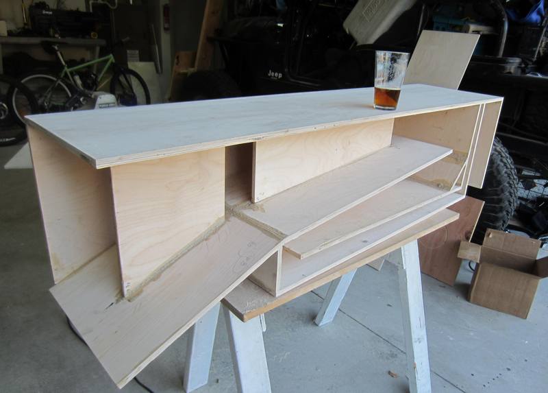

It's almost time to glue the side on! yikes! :shock:
Sierra Nevada "hoptimum" today. :D
