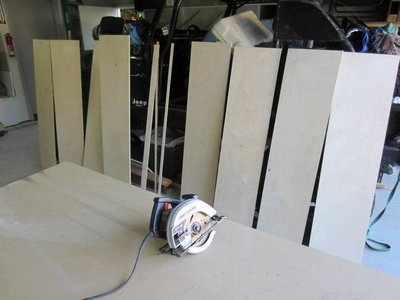

Only tools I have are an old cheapie craftsman circular saw and an antique 50 year old table saw. I see the importance of having all the panels the same width but the table saw did not make for exact cuts. I don't think the blade is square with the rip fence. So, I tried to make better with some 60 grit sanding. after 30 minutes of that I called it good enough. Tried to PL glue the first panel, I used many screws. I sure hope I am doing this correctly. there will be lots o pics. feel free to criticize or compliment. I'm not much for words but I can post pics.

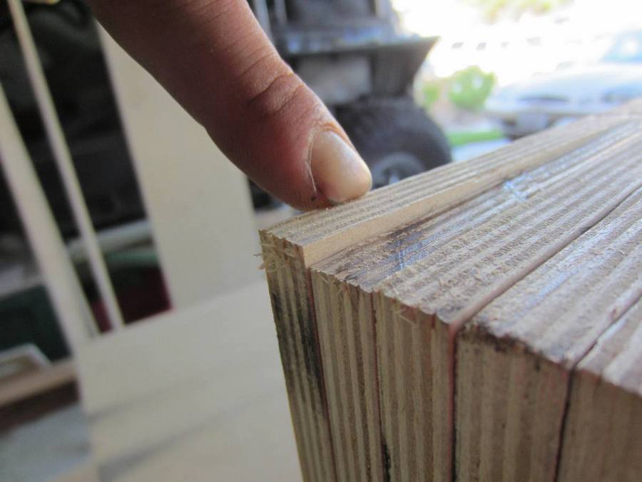

some screws split some of the plies apart
maybe I should have drilled pilot holes?

+1 on the pilot holes. A combined drill/countersink may be the best bet/bit
That way you don't have the PITA moment when the PL is drying you've screwed the screw home, but then realise you still need to countersink all the holes
Must have happened to me on at least half the panels. It also means the depth of your screwholes is constant (and hopefully just a tiny bit shorter than your screws).

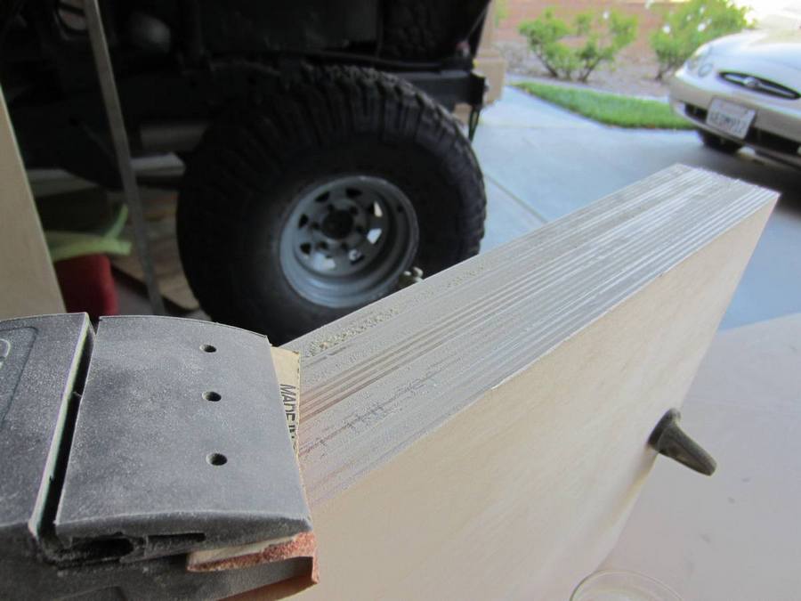

I think the car in the pic has a US numberplate, so you have no excuse for not using the right stuff

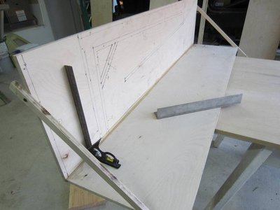

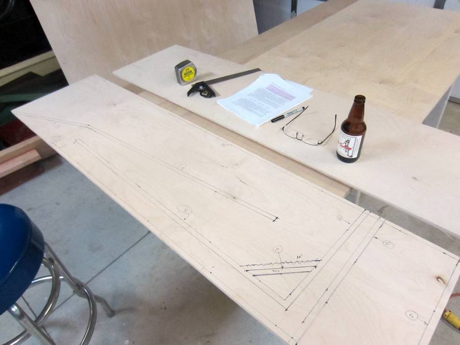

Loving the crossed out line in the final pic of your first post (by where most people put their castors). Looks like you went the wrong side of the first line when allowing for the 1/2" stock. I don't think I have a single cab that doesn't have this particular 'feature'... one of them I only caught when the wood I had cut seemed completely the wrong size to fit within the lines I had drawn
After realising my mistake it was an easy fix (can I call that a 'fix'??... probably not as it was more like just ignoring the previously drawn lines
Keep the pictures coming. Having the guys on here double checking your work can save a whole lot of heartache and burnt wood (as long as you take the comments on board, and don't just ignore them - like a certain infamous (ex-)member used to do

So are you saying those 8 screws I put in last night are now permanent? I was hoping I could remove them after the PL set up and then fill in the holes. I guess I will go to lowes and look for that countersinking bitThat way you don't have the PITA moment when the PL is drying you've screwed the screw home, but then realise you still need to countersink all the holes

make a saw sled, and the circular saw will do the job you need to do. My first 4 subs were built using nothing but a drill, a circ saw, and a router.

Well that makes me feel better. I have been reading a bunch of other build threads and DANG if some people don't have some serious workshops and talent.sine143 wrote:MTB, there are people on this forum building the subs with HAND tools.... I'll try and track down the thread.
I will have to look into that saw sled. I probably should have done that BEFORE I made all my big cuts.

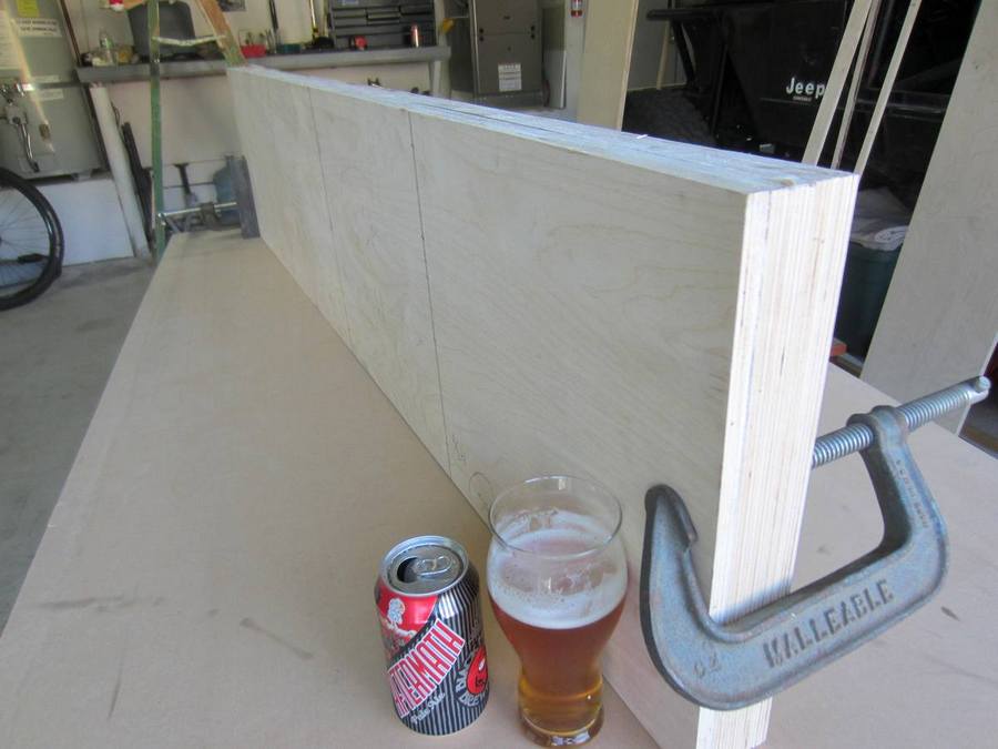

Thought you had a huge problem when I first saw the brown bottle with the silver label - COORS LIGHT??? Upon closer inspection, it seems like your build is going to be okay after all.
You can remove the screws and fill the holes. PL adhesive is plenty strong without screws - just use screws to hold it together while the PL cures. You must remove the any screws along any edge you want to round over anyway. I would definitely suggest drilling a pilot hole for the screws though, and yes Lowe's has the countersink bits like what is pictured above.

I'm digging what I see of that Jeep!

It is for sale if you are interested!I'm digging what I see of that Jeep!

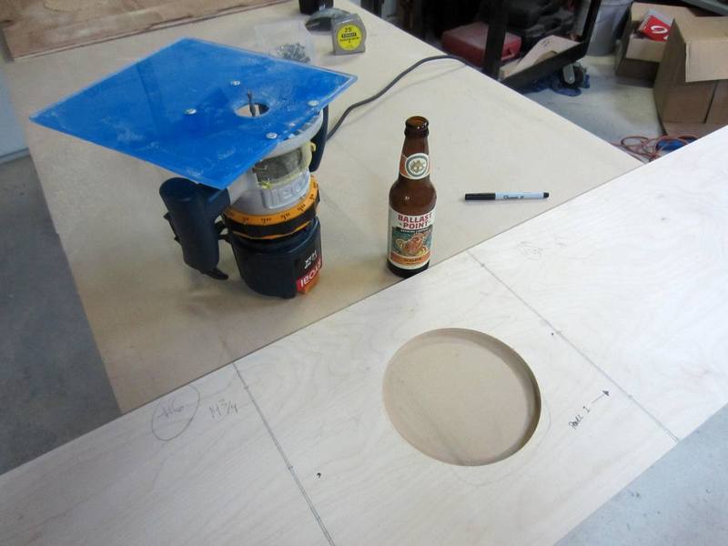

Super proud of myself tonight! So, I have this router I used once over 10 years ago, but I thought I gave it away to someone. After digging around in storage, I found that I still have it. After reading various build threads and doing some online research, I made my own circle jig out of some plexiglass scrap that was laying around. worked like a charm!
