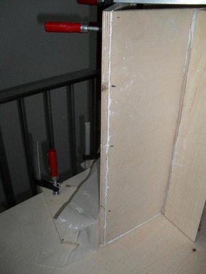

just a simple question. if we wanted to secure panels in place with screws, I assume I'll have to predrill the side panel but do I also pre drill the side of the panel to be secured, or just hold it in and drill the screw in ??
Predrill through the side where the screws should go. Then clamp the panel in place (correctly) and drill pilot holes from the outside the side. Remove the panel, install screws from outside the side panel far enough to poke through the hole and also align the panel to be installed. Apply a bead of expanding polyurathane adhesive onto the side where the new panel is going to go, install the panel over the screws (which are acting like guide pins) and push down. Tighten screws to pull the panel to the side, and you should see squeeze-out of the adhesive.
Don't forget to make sure that all panels are flat, not warped.

I've learned my lesson dozens of times, that it's easier to drill pilots than fix a split in wood.
P.S. If you're using PL, you don't as many or as big wood screws.

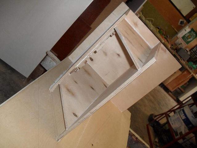

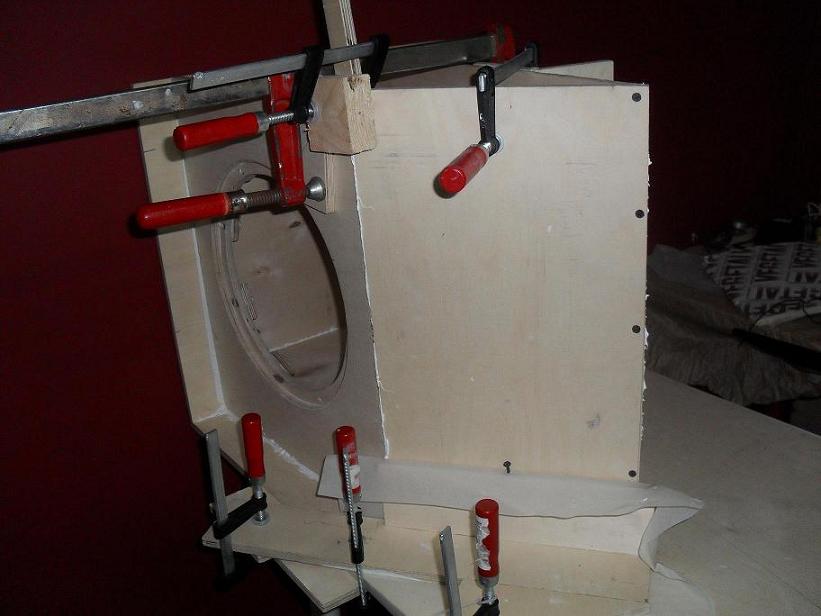

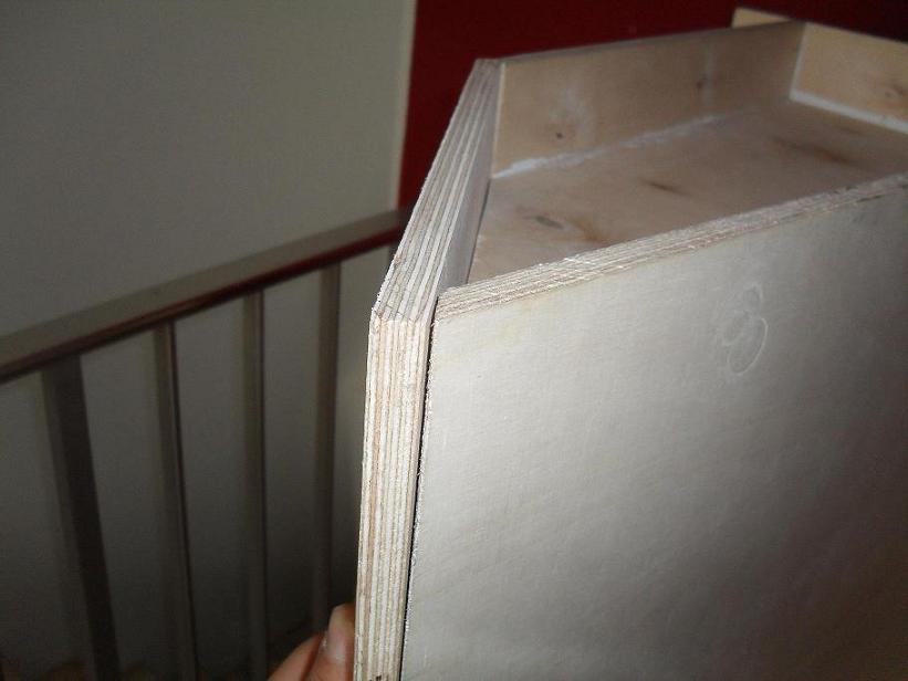

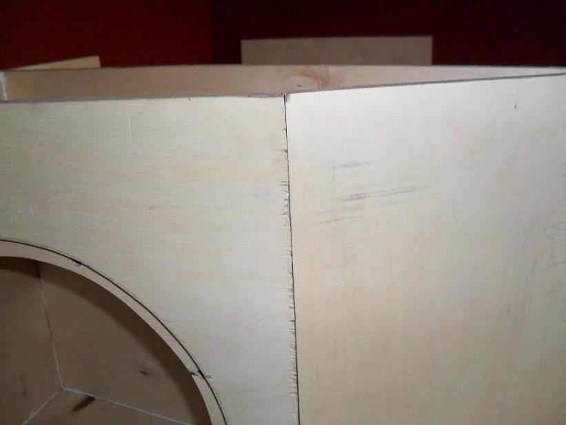

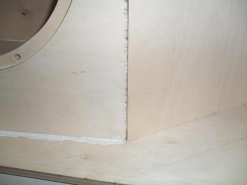

i've got some photos for you guys!

hey, yes I can take a picture of the exact one we are using, but I was assured by a retailer that it was similar to pl premium. that product isn't carried here in Portugal, and at least on the label it states mostly the same information.
waterproof, 200kg strength, polyurethane adhesive, paintable, and it states lastly that it's "made for surfaces that are under extreme vibrations".

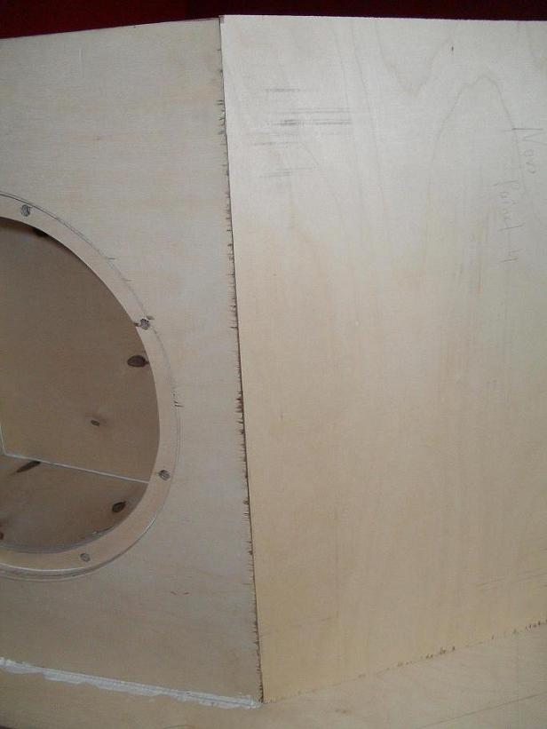

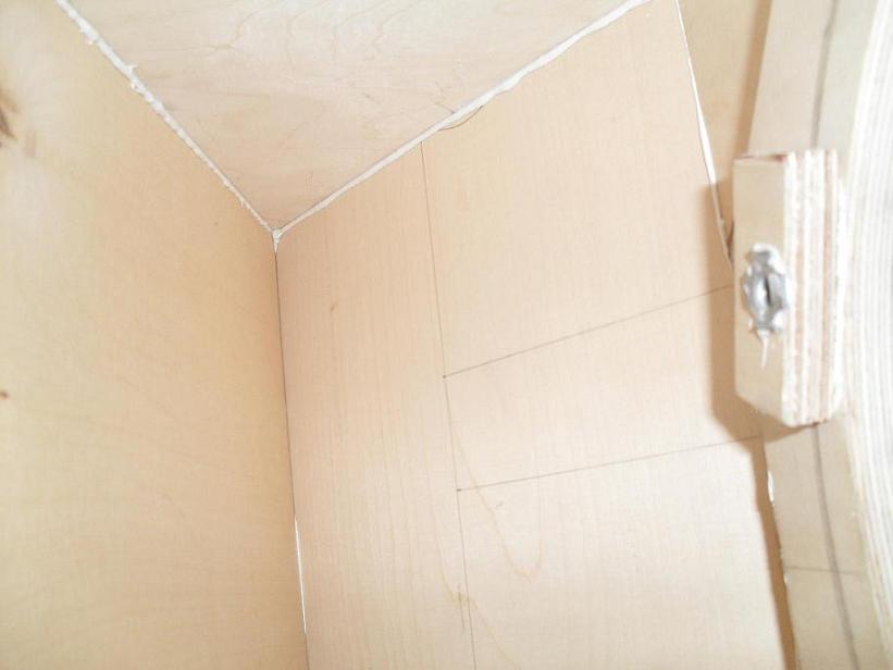

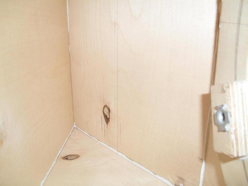

Thats where the problem is,a retailer assured you but he has probably never built a horn design subwoofer.Looking at the last pic you posted you are gonna have air leaks,i can clearly see area's where there is no glue or squeeze out.From what i understand of the product you used,its something like liquid nails.The problem within the cabs is not vibrations,braces take care of that but its the pressure of the design.

Hi there,
I appreciate the concern, and as of now we've stopped the build until we figure out the best way to continue.
My plan would be to set the driver up and possible chalk all of the glue joins to see if any chalk "jumps out".
I just dont know if I should place the chalk inside or outside the speaker box? Would it hurt the driver to have chalk in it ? Or I should just blow it out afterwards?
also, regarding the squeazeout you've mentioned. We've had squeeze out with all panels except that one on that side, it squeezed a whole lot on the other side (and on all other panels we've glued),
That being said, our panel 5 is a bit warped, left it dewarping over night and possibly will try to do the driver test tonight.
If I do find some airleaks we will probably stop the project for a few days until we can find actual PL Premium which will be a tough call here in Portugal...
Cheers

djtrumptight wrote:hey, yes I can take a picture of the exact one we are using, but I was assured by a retailer that it was similar to pl premium. that product isn't carried here in Portugal, and at least on the label it states mostly the same information.
x10000000000000000000000000000000000000000000000000000000000000000000000.... squared.
Your glue ISN'T the stuff... it does not mention anywhere that it is expanding, therefore it won't expand (if it did, it would be mentioned pretty early in the description as it is a major feature). See if you can find Everbuild Lumberjack Wood Gel <-clickable link - Tool Station may even ship from the UK. Search for 30MINPU3 if you are looking for the Everbuild product
If you don't get the right glue, then you are just building a driver destroyer and NOT a subwoofer. DO NOT CONTINUE UNTIL YOU HAVE THE RIGHT GLUE (sorry to use caps, but this is so important, I think it deserves caps - can someone back me up to prove the point!). We just want to make sure that you do this RIGHT and make yourself a killer sub.
