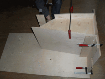

Also we chose a "weird" width, as it's 19,78 inch which for us means 50 cm which is perfect. :P
already marked the panels, and finished the baffle / anchor. and got panel 1 glued.
Left reducers glueing yesterday, plan to get panel 2 installed tonight.
We all work full time jobs so it's hard to get time to work on this, but we plan on doing one panel per day at the end of each work day.

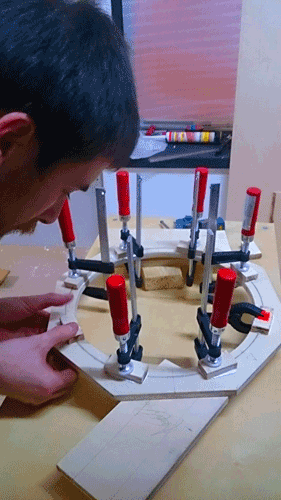

I don't have a lot of photos with me, will try to upload when I get home, but anyway here's one of me attaching the screw blocks to the anchor.
Updates soon. And most likely a lot of questions. Cheers.

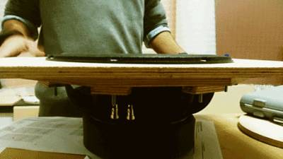

and one with the fully assembled baffle with speaker installed

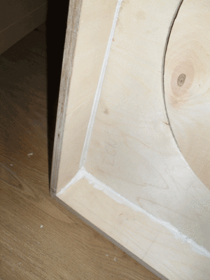

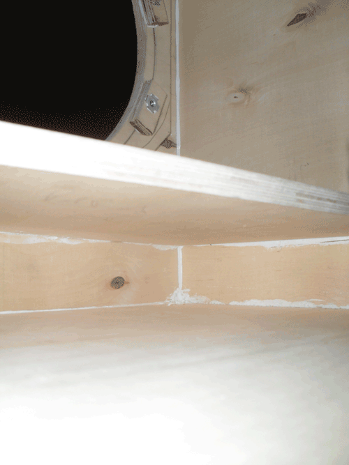

Here's a few photo updates, glued panel 3 yesterday. plus bonus baffle / panel 1 join, and underside of reducers.

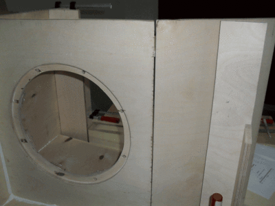

OK, we have a problem,
it seems that our baffle has about 2 mm difference in size, I guess the blade must've slipped a bit on our carpenter....
So panel 4 doesnt fit properly.
Our possibilities would be to try to cut just a bit of ply and glue inbetween ( having panel 4 slightly off panel 3) or to try and re-cut panel 4 with those 2 mm offset.
What to you think would be the best option ??
Pic attached so you'll see what I mean
Posts: 29008
Re: First Build. Titan 48 w Lab 12.
#8 Post by Bill Fitzmaurice »
Adhesive should fill that gap.
jmanso
Posts: 134
Joined: Wed Feb 05, 2014 6:33 am
Location: Lisbon, Portugal
#9 Post by jmanso »
Bill Fitzmaurice wrote:Adhesive should fill that gap.
Just apply on both panel 2 and 4? and when i get them close together the adhesive should bind right ?
is it worth cutting a 2mm strip of wood just to try and stick it down the gap ? just so the gap would be less than 1mm
Cheers
Posts: 7634
#10 Post by Tom Smit »
The adhesive should be good enough to fill the gap. I most likely would put adhesive on the bottom of the panel and install it (all joints dampened). After that, just fill in the gap with the caulk gun.
If it really bothers you, you could put a sliver of wood in there, but it's not necessary.
Posts: 29008
Lock the panels in place with jigs, fill the gap with adhesive. Make sure it's completely cured before removing jigs.
