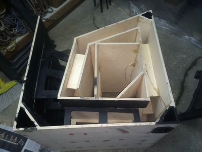

Well, I had a few set backs. I had some offending last braces that I had to cut back out and then redo to fix some bowing.
Then I got the side panels finally attached and the drivers installed to test. I heard some rubbing that I can only assume I missed when I initially cut the pieces. I started the long process of rubbing some chalk on the spacer, attaching the driver, sending a signal and then removing to see where it was rubbing. I was trying to be cautious with the sanding to avoid over sanding the pieces, but low and behold that's exactly what I did.
To both of them. Cut them out this morning, my dremel multitool saved the day with its wood cutting attachment fitting right between the baffle and the space. Only some minimal marring on the the baffle.
I have to run to class and then maybe I can recut the pieces before I have to go dj tonight.
Here's a few pictures:

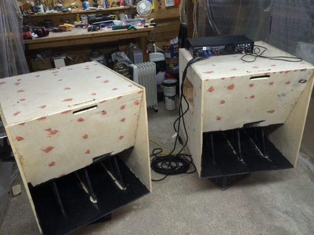

2 x 21" T30's with Lab12's
2 x 28" T30's with Lab12's

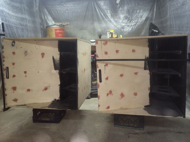

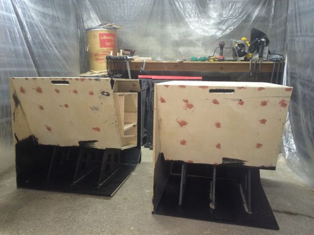

New spacers cut and everything seems to be solid. Framed all of the access panels and now just waiting to do the testing to make sure they're sealed proper.
Sounding great without the access panels attached and I can't wait to finish this last little step. Then some cosmetics and painting and then on to the OTop12 build.

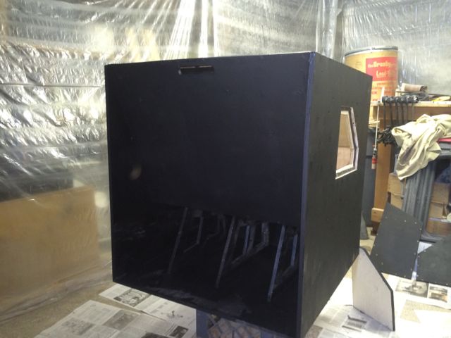

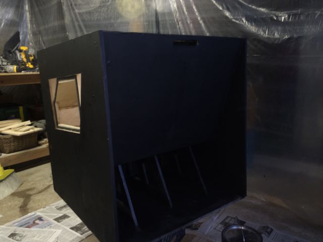

Primed and ready for duratex as soon as I can raise the temperature back up in the basement. They're getting sexier by the minute. A buddy just let me borrow his router but I don't know if I should go buy a bit to round the edges and have to repaint or just leave them square. I also have zero experience with a router too.

http://www.kregtool.com/files/newslette ... uary14.aspchrisj360 wrote: A buddy just let me borrow his router but I don't know if I should go buy a bit to round the edges and have to repaint or just leave them square. I also have zero experience with a router too.
Route the edges, then prime them before the duratex. Don't leave them square as they won't stay that way for long. Square plywood edges are very fragile and will chip off on their first gig. Routing is quick and easy. Check your depth of cut on a piece of scrap first. Once you're comfortable you should be able to route both cabs in under 5 minutes.
Re: 2 x 27" Tuba 30
I'd recomend a 3/8 roundover. most appealing imo.
