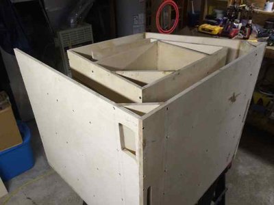

Well, I suppose I should really stop lurking, reading everything on the forum and introduce my build. I started this a little back in Sept. but with school and work most of the build had to be put on hold until fall break.
I am working with severely limited tools and in a cramped basement that sometimes has the floor covered in water when it rains. So with living in the Pacific Northwest, that means there is usually always water.
Anyway here is a photo of the build and I am looking forward to starting my Omnitop 12 here in a week or so. I am waiting for the Duratex to arrive, hopefully tomorrow before I can move onward. I am already kicking myself for not having the paint for some of the earlier panels where the handholds are but oh well.

You have a helluva start there on some sweet subs
. Please keep us posted on the build and the review! And more pics, too.

Nice looking ply.
Those handle holes look really small!

About the handles, I had cut them small to err on the side of caution knowing I could always make them bigger. Plus I am a rock climber with small fingers, so it doesn't take much for me to be able to grip something solidly. As my girlfriend would say, insert obvious childish joke here…

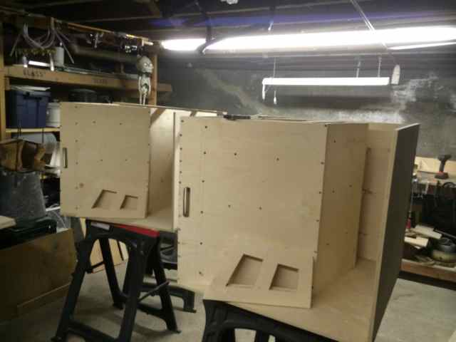

Final corner pieces in place and mouth painted. Now I just need to sand flush all the panels and frame the chamber. Secure the wiring. Then cross the fingers and attach the side panel. It won't let me upload the photos from my phone cuz it says they're too big. Will post later.

Almost there, although filling and sanding the box is a PITA! Always takes longer than you think. At least the best part is that you don't need to have the thing looking perfect to get the all important leak test and (more importantly) the sound check donechrisj360 wrote:Now I just need to sand flush all the panels and frame the chamber. Secure the wiring.
