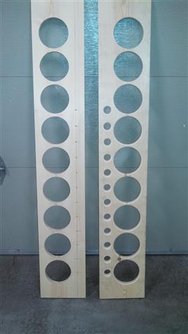

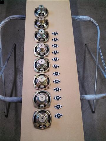

I'd space them 2 1/2 to 3 inches on center. At the distance you'll be using them at you won't have any lobing issues. I don't with mine.ecut1 wrote: Can I space the tweeters a bit further apart or will that result be negative?
TLAH and curved SLA
- Posts: 29153
Re: TLAH and curved SLA
Well, that's a relief! I re-spaced them at 2.5" and 3". I guess I'll go with 2.5" because I'm at 80% or more of the length. Do you think it'll be worth it to upscale the cabinet 10 inches in order to get the extra drivers in or is this just plain overkill?

I like pics like that. It's when you start to get all excited about the build process. Once I start seeing "drivers on or in wood" that's when it starts becoming real for me.

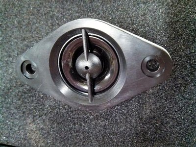

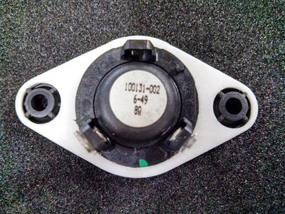

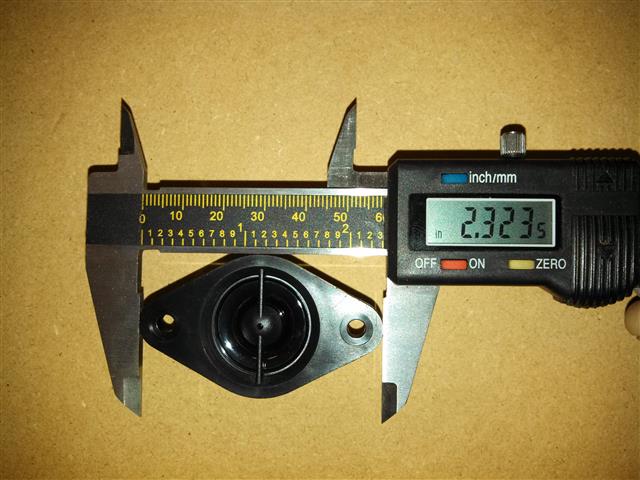

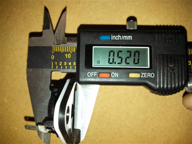

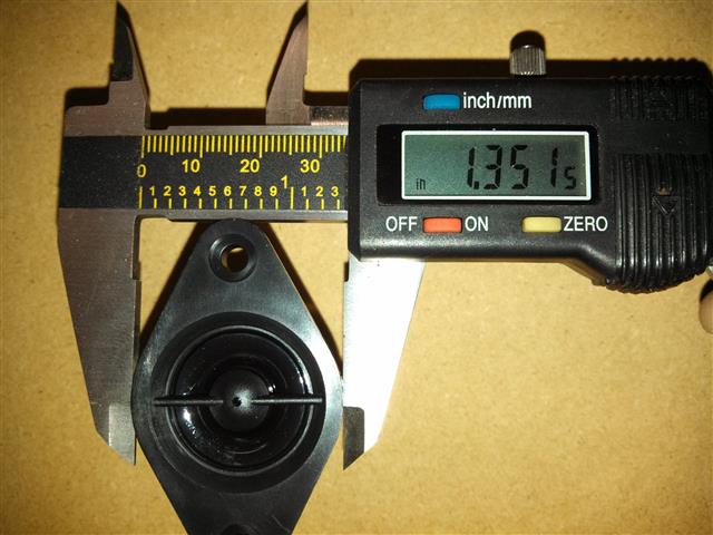

Ecut1, would you mind posting some detailed pics of those tweeters? I have the old style that were on 6x9 frames, and they look ugly. I would consider offing them for the ones you obtained. They look really nice to me. Thanks in advance.

Here are some more detailed pics. There's not much info about them online. What I found is they are made by audax and were used in a Harman Kardon "Festival 80" - some sort of an all in one retail box surround sound system I think. I paid $36 (shipped) for a "tray" of them which was 49 tweeters. I bought them from Apex Jr.DJPhatman wrote:Ecut1, would you mind posting some detailed pics of those tweeters? I have the old style that were on 6x9 frames, and they look ugly. I would consider offing them for the ones you obtained. They look really nice to me. Thanks in advance.

Lots of distractions today but I did get started.
...and we have liftoff!ecut1 wrote:Lots of distractions today but I did get started.
It was nice of you to post the VERY accurate dimensions of your tweets as well as what you paid/where purchased. Way to help the community!

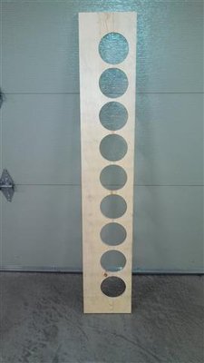

A little more progress happened today but I only had about two hours to work on them.

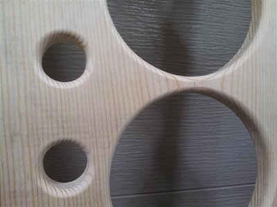

I have a question... I'm going to mount the drivers and tweeters from the inside so I rounded the holes over with a 1/4 round bit as it explains in the plans. However, I do have enough room to probably use my 3/8 round over bit. If I do that will it help the sound, hurt the sound, make no difference, etc? I think it would help the tweeters look like they're not buried so deep in there, it might make it look better.
- Posts: 29153
I'd use the 3/8, it will help the high end a bit. The hole in the baffle acts as a resonant pipe, the smaller the hole the lower the resonance, damping the high frequency response.
Cool, I'll hit it with the 3/8 bit. Thanks for the info. There should be plenty of room between the drivers for a 3/8 round over.

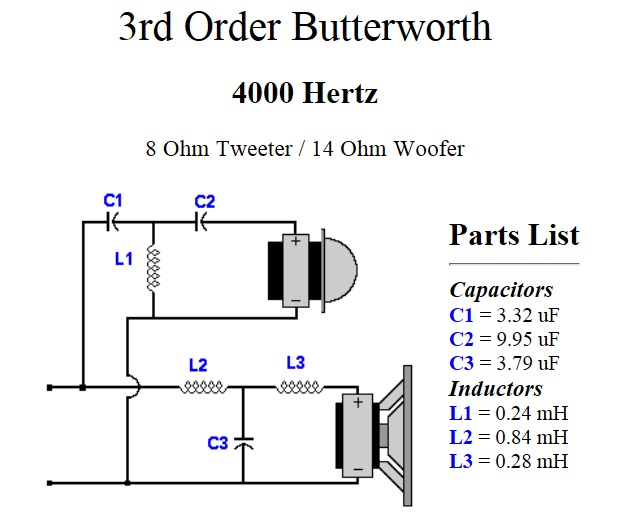

Hmm, I may just wait to buy my crossover components. Would you mind sharing your data with me once you get your crossovers figured out?
This is what I was going to order...
