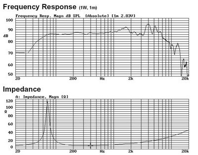

With this woofer I wouldn't run them as high as 5khz and 4khz is still pushing it with the break-up around 4khz.. I would say that you should low pass the woofers at 3-3.5khz and high pass the tweeters at 4khz, that way you could control some of that peak at 4khz :) Do you have an active crossover and some measuring equipment? Then you can test which crossover is the best..

Michael Ewald Hansen wrote:With this woofer I wouldn't run them as high as 5khz and 4khz is still pushing it with the break-up around 4khz.. I would say that you should low pass the woofers at 3-3.5khz and high pass the tweeters at 4khz, that way you could control some of that peak at 4khz :) Do you have an active crossover and some measuring equipment? Then you can test which crossover is the best..
I don't have any type of measuring equipment or an active crossover. If I pass the woofers at 3-3.5khz and the tweeters at 4khz wouldn't I be missing between 1-1.5khz of the frequency range?

Nope, there are only 1000hz from 3 to 4khz.. Anyways, if you low pass with a 2nd order low pass at 3khz it means that the woofer will be attenuated 12db at 6khz, because a 2nd order crossover is 12db/oct and every doubling of frequency is an octave. That means, if you cross them a bit lower than the breakup peak, you'll smooth out some of that peak and get a more linear response - its not like the output disappears after the crossover :)

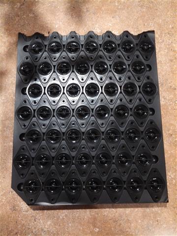

Tweeters showed up today. :hyper:
