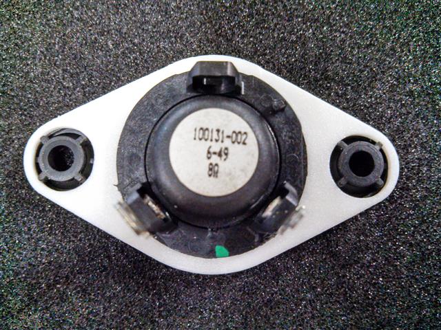

DJPhatman wrote:Ecut1, would you mind posting some detailed pics of those tweeters? I have the old style that were on 6x9 frames, and they look ugly. I would consider offing them for the ones you obtained. They look really nice to me. Thanks in advance.
Here are some more detailed pics. There's not much info about them online. What I found is they are made by audax and were used in a Harman Kardon "Festival 80" - some sort of an all in one retail box surround sound system I think. I paid $36 (shipped) for a "tray" of them which was 49 tweeters. I bought them from Apex Jr.

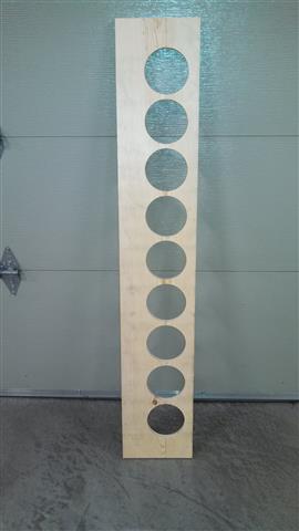

A little more progress happened today but I only had about two hours to work on them.
I have a question... I'm going to mount the drivers and tweeters from the inside so I rounded the holes over with a 1/4 round bit as it explains in the plans. However, I do have enough room to probably use my 3/8 round over bit. If I do that will it help the sound, hurt the sound, make no difference, etc? I think it would help the tweeters look like they're not buried so deep in there, it might make it look better.

I'd use the 3/8, it will help the high end a bit. The hole in the baffle acts as a resonant pipe, the smaller the hole the lower the resonance, damping the high frequency response.

Cool, I'll hit it with the 3/8 bit. Thanks for the info. There should be plenty of room between the drivers for a 3/8 round over.
Another thing I could do at this point in the game is countersink the tweeters by running a straight bit all the way up and down the tweeter line to reduce the baffle thickness to a half inch. That would bring the tweeters forward and thin out that pipe. It would be fairly simple and quick to do on the router table. Would it be worth it?

It may or may not be worth it, but can't hurt.
