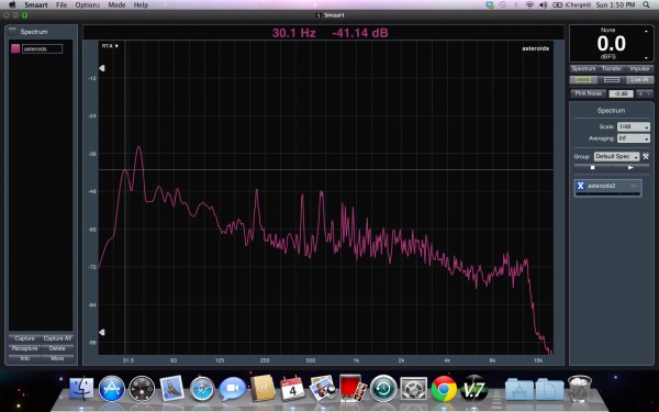

Yeah, it has some lows in there, in fact I bet that is one of the hottest (gain wise) low bass songs I have ever analyzed. Here is a screen capture of the spectrum.
It actually has a fair amount of "mid bass" meaning 40-60 Hz so I imagine it would still sound good HP at 32 Hz with a fat stack of T48 after EQ. Of course, it really likes the T60.
What really gets you is the high duty cycle, being constant it really moves you.

the only midbass is the kick lol, and a bit of harmonic from the midbass patch. Heres averages of the whole song in smaart.

Yeah I need to turn down the smoothing. Yeah I was right, I reran the analyzer with much higher resolution and I got what you did. Thanks for pointing it out, I'm redoing my bass archive as I type.

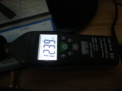

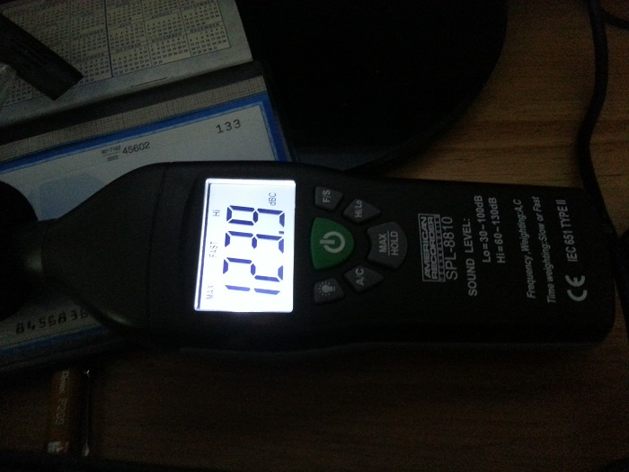

Measured 7 feet from subwoofer (my listening position), and I didn't even hit the limiter (probably within 3-4 dB of it). Mind you that some of the sound is coming from the TLAH's but logarithmically that can be mostly ignored.
This is playing Martin Garrix - Animals. Enough said.
