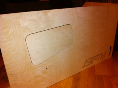

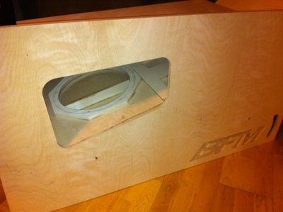

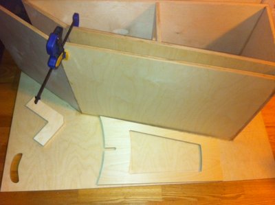

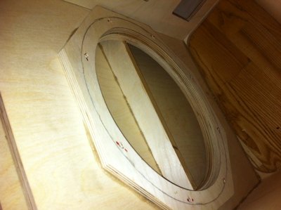

Not the best photographer but hope this helps show some detail. I didn't grab every step but you get the idea...

#20 Post by DanielNY »
Some more!

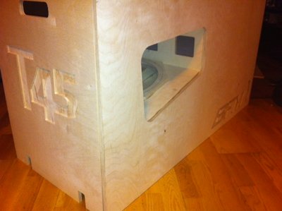

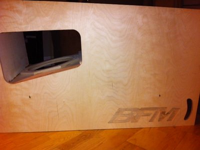

#25 Post by DanielNY »
One more... Just a mockup with the back panel on to give an idea of the look I'm aiming for.
The next time I post will proably be when I'm done painting....

#28 Post by miked »
Quick question. I noticed there are no flanges for the access panel. How are you securing the access panel?

miked wrote:Quick question. I noticed there are no flanges for the access panel. How are you securing the access panel?
My guess is CNC cut flanges.
The photos were just a mockup of the parts, I had only completed the first 4 panels when I took the pictures, the remaining parts were just set in position for the picture. I have added the access panel flanges and will post some more pics soon.
