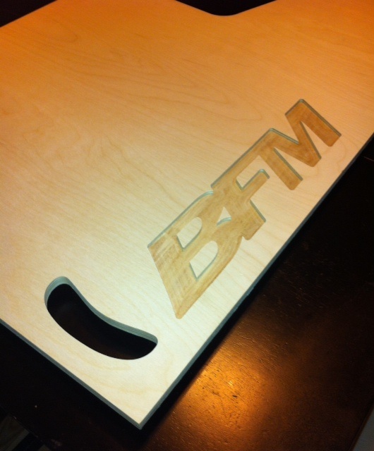

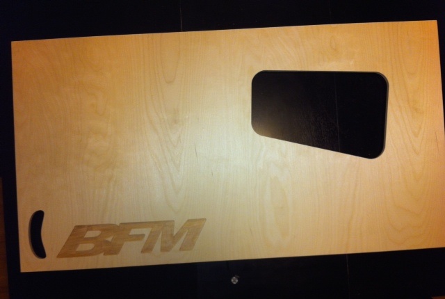

Thanks but no engraving skills here. Thats cnc work which I also used for the bracing. I will post some more parts tomorrow.MissileCrisis wrote:You make me jealous with your engraving skills.... Mind making me a plaque/wood base for my TLAH's? They are made of pine so anything that matches will do

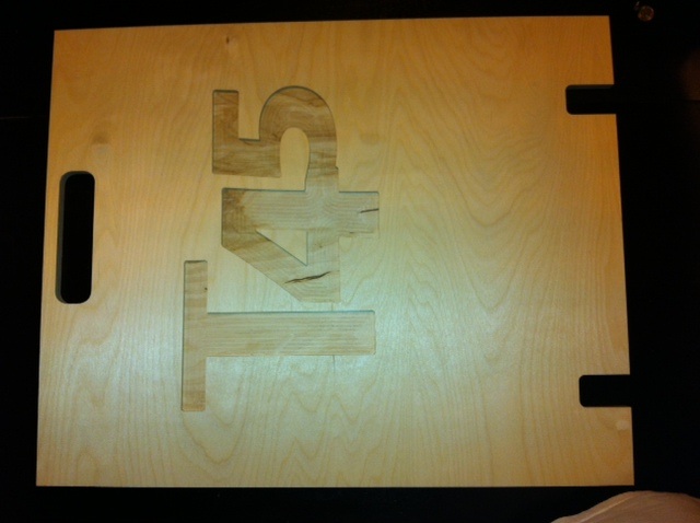

Wow, talk about "teaser photos!" That looks awesome! There's virtually no tear-out along the letter edges at all. Amazing. Are you planning on Duratexing the cab or varnishing it?

These are the color options I'm mulling over:MissileCrisis wrote:+1~!!!!!88h88 wrote:Oh shit. Pretty.
Sub painted black with the logos filled in a contrasting colour perhaps?
1. All Black Duratex
2. Black Duratex with charcoal grey Duratex lettering
3. Black Duratex and my signature "deep purple" for the lettering to match my DR's.
Also, taking a little tip from Nimrod Webber and soaking the edges and lettering with superglue to harden the surfaces before painting.

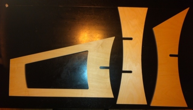

Here is the bracing!

I`m finding the same error as Fester did with his T45 build on the first baffle brace. It's sized about half inch too big to fit properly. Already measured 3x~ over from all sides and can't make it fit.

If you mean panel 3/6 brace I just double checked, one end is 2", the other 1 3/8". Sorry for the mis-print, I'll fix the diagram straight away.DanielNY wrote:A small holdup...
