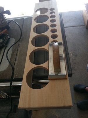

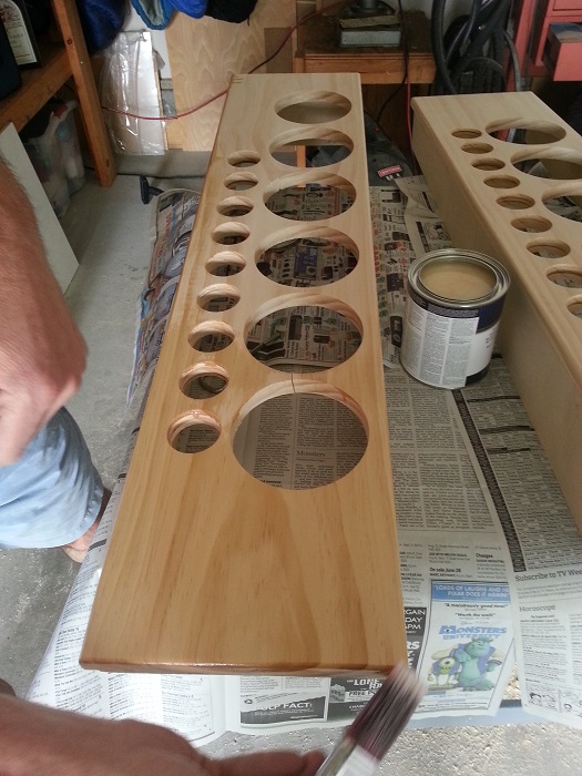

Sanding is fun. Can't wait til I Deft these tonight.

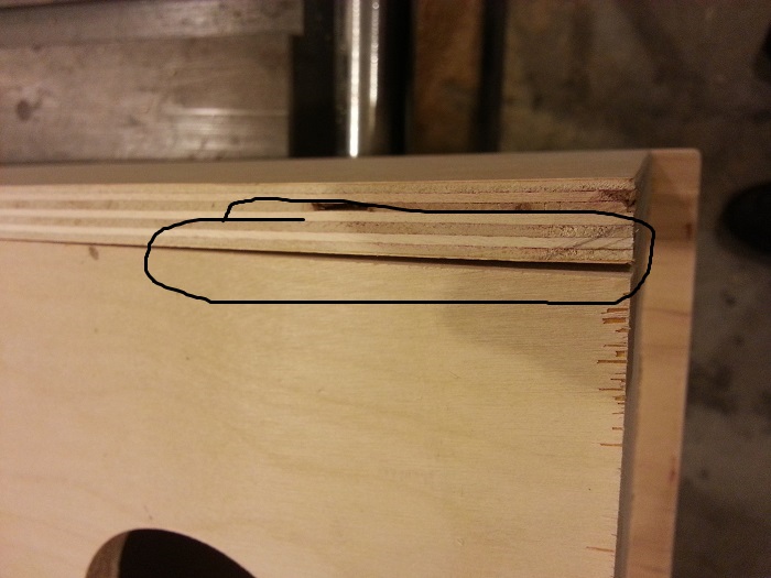

Ran into a hiccup, this isn't remotely airtight. (see corner) Any suggestions for how to make this airtight? I'd like to keep the back removable in case of driver failure. Things I have: lots of weatherstripping, PL, wood glue, duct tape, other miscellaneous stuff. The width is a fixed distance because the bottom is determining the width of the sides so no amount of sideways pressure will fix that...

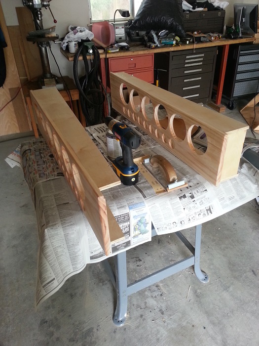

Looking pretty good considering I did 75% of the work today.
Finish will have to wait til tomorrow, then it's driver wiring time (any suggestions for a quick way to test polarity, or rather a quick tutorial).

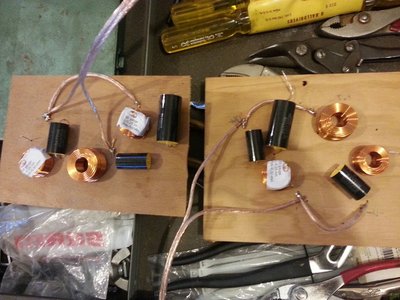

rotate one of your inductors so they are at 90 perpindicular to the board and the other conductor. helps eliminate interference between coils.

Considering the length of the wire is short as is (inductors) I'll see if that is possible.

Add some wire if needed to make that happen...MissileCrisis wrote:Considering the length of the wire is short as is (inductors) I'll see if that is possible.

*Will do.Grant Bunter wrote:Add some wire if needed to make that happen...MissileCrisis wrote:Considering the length of the wire is short as is (inductors) I'll see if that is possible.

Did what people said and rotated next door inductors. These things are works of art (IMO)

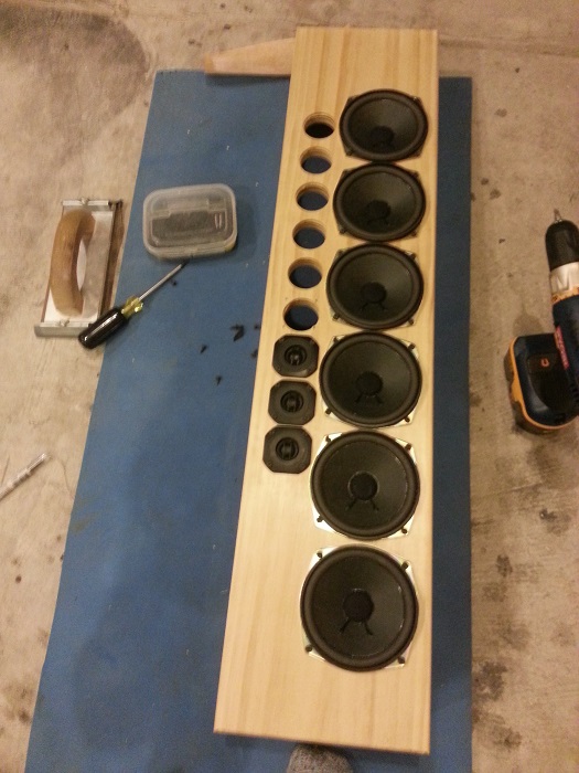

Building this speaker I have broken: 1 tweeter, 1 sock, tbc....
Something things I have learned: soldering lots of tweeters is a PITA, remember to drill out the hole for the screw (goldwood tweeter), never work when you're in a bad mood.
Progress: working on mounting and soldering/ installing.

Slow and painful:
