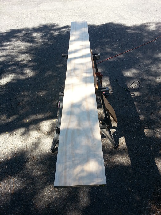

Hi all I just started my TLAH build and although it will be a slow one (working only weekends and probably some weekdays if I'm ambitious (working full time this summer). Attached is a pic of the beautiful 8 ft piece of pine I picked up for the baffle.

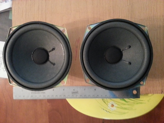

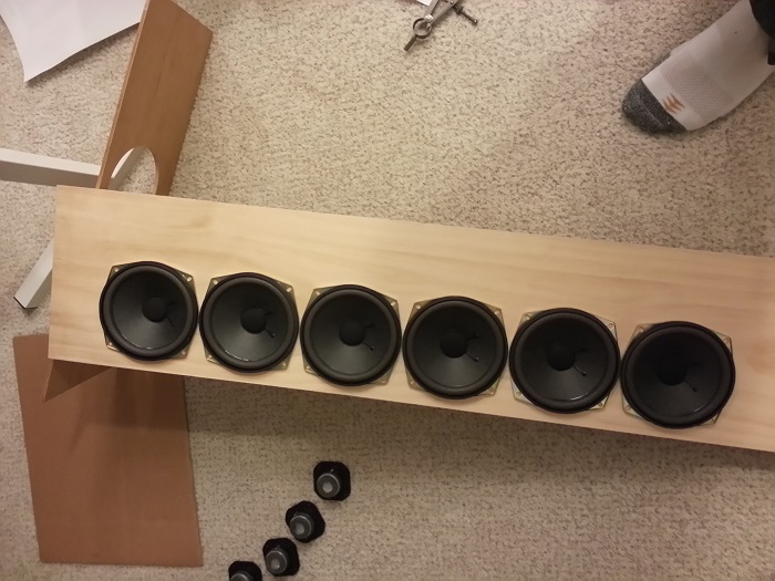

I also have a picture of the baffle spacing that I am proposing and I hope someone can give me feedback as to if I am spacing the 5.25 inch aurasound woofers enough (I'm doing 5.75 inches center to center for a 5.2 inch driver (measured)) See below:
*note that the wood behind the woofers is just for scale and marking on and is a piece of scrap, I intend to follow the sketchup and start at the bottom of the speaker/work my way up (woofer placement).

When installed, the frames of the woofers should just touch, bringing the center-to-center points as close as possible. Do the same for the tweeters. If you can trim the frames without ruining them, do so for even closer c-2-c spacing. Looking at your woofers, just have them touch.
What I did was face the woofers down, dust cap to the woofer panel, line them up and pencil trace around the array. This mocks up the placement so I know how much room I have to work with.

With those drivers, there should still be some strips of wood between the drivers. Be mindful of the terminals when installing the, if you are surface mounting them. If you are back mounting, use a 1/4" roundover, or lightly sand so as to not make the strips too thin.
MissileCrisis wrote: What disadvantage would there be to spacing them out a little?
Bringing them closer reduces the comb filtering between drivers.

The woofer section requires more power to produce the lower frequencies. But, with 6 drivers handling the load, it should be no problem. Follow the plans, and you will be ecstatic with the results. SLA are smooth and effortless with little or no EQ.

it wouldn't be a good idea to spread them out.
No more than is necessary to allow them to be secure and airtight.

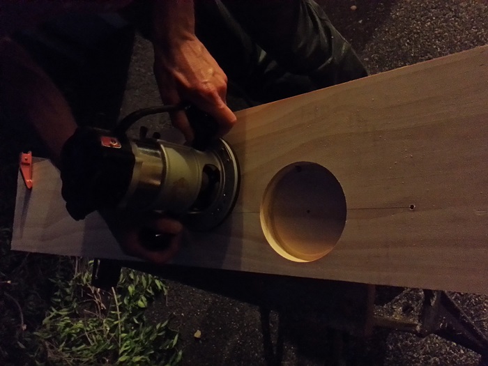

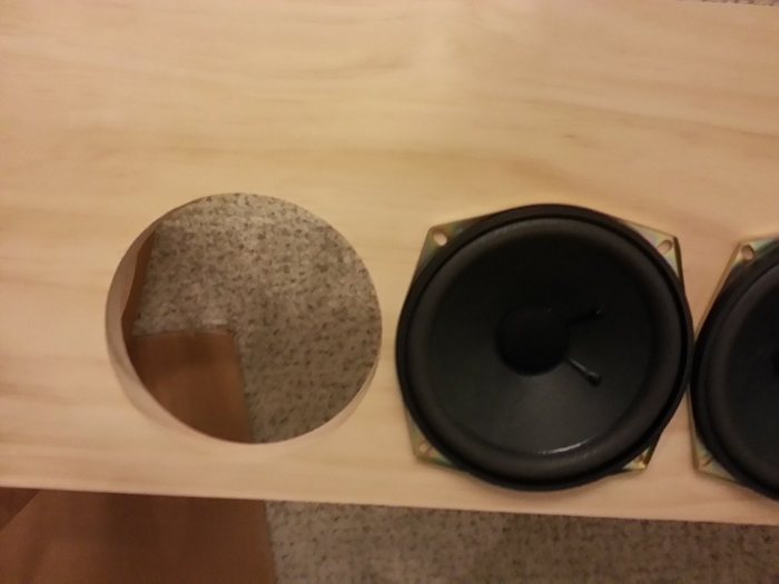

Progress photos. No one else has a 4.96 inch diameter circle jig like I do :).
Not a plunge router, but using it like one = priceless.
All lined up.
Very round hole.

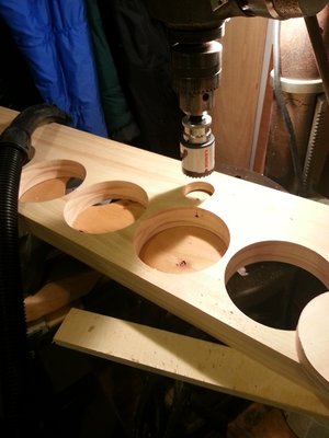

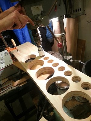

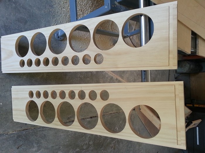

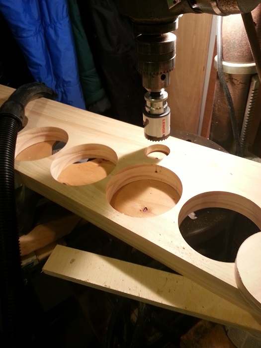

Tweeter holes finished tonight, hoping that crossover, baffle staining, polarity check/wiring, and rear piece construction get done tomorrow. I'm feeling ambitious. Too bad my paycheck hasn't processed yet I was hoping to get my duratex + goodies order shipped today from speakerhardware.
Holesaw getting a workout!
All done.
For the record they were clamped together and I went through both baffles in the same go (clearing out the hole saw as necessary).

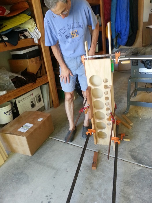

Sides and bottom (meaning the 4x8 bottom since it is a rectangular build, the "top" is open as in the plans) glued in their convenient dado slots :) Note the back is simply a spacer at the moment and is not glued (removable by means of screws + weather stripping is the plan))
Notice that this is upside down in the picture and the dado on the top is for the "bottom"
Ran out of clamps.
Ran out of clamps.
