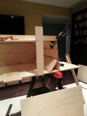

slinger wrote: Is my panel 2 being slightly higher than panel 4 (first pic) going to be a problem?
Drew
It shouldn't be a problem, but it appears that you didn't double check the measured length of panel 2 in place before cutting to final length.

You are correct Bill. I may trim the extra off once panel 4 is installed. Is there an easy way to make sure panel 4 is the correct height on the clamping side?
