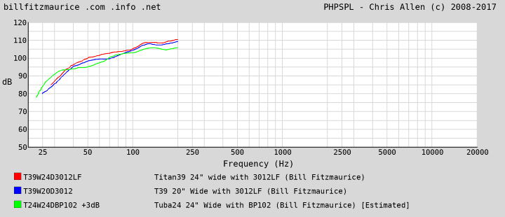

Assuming that the additional driver gives you an extra 3dB, this is what you get:
So that is:
8 cubic feet for the dual BP102 T24, 414cc
10.6 cubic feet for the 3012LF 24" T39, 494cc
8.8 cubic feet for the 3012LF 20" T39, 494cc
So that is:

I wasn't trying to say that they are the same in output, but both will have "plenty of bass" for most smaller setups. I do know the Titans go louder, thats why i build them.

I was just trying to demonstrate that the T24 was perfectly capable and even though it less sensitive in some areas, it is a damn fine cab. Not in response to any post, just data.
