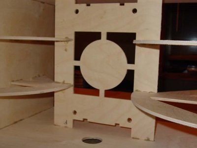

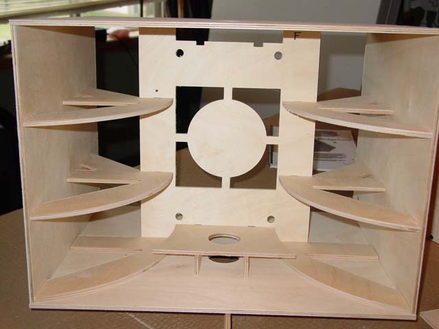

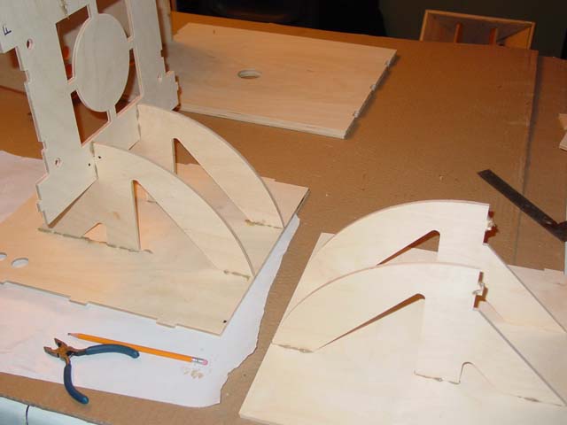

First here is the dry fit of the second J10 lite cut out. Many more tabs and slots, plus made the 2 inner braces one piece, with a tab on each leg going into the sides, and a tab going into the baffle.
That one is now changed in the CAD files. It doesn't go together easily with the baffle tab. The baffle hole and tab is now a small tab and a slot on the edge of the baffle, so it will slide right in, without having to move things.
Tabs on the duct, slots in the baffle. Easier to center that way...
No tabs on the Duct braces, that would be too extreme, I think (maybe not :idea: )
No tabs on the bottom and top braces, since they automatically align anyway.
I am changing things as I go, since I am building 2 more. On each one I figure what tabs work and with don't. That is also why I'm cutting 1 at a time, and testing, before cutting the next one.
The next one will also have tabs and slot to align the back braces. Not sure why I didn't add those before :oops:
here are the dry fit pics:
Cry fit cab #2
Cry fit cab #2
Dry fit cab #2
Dry fit cab #2
Dry fit cab #2
Dry fit cab #2

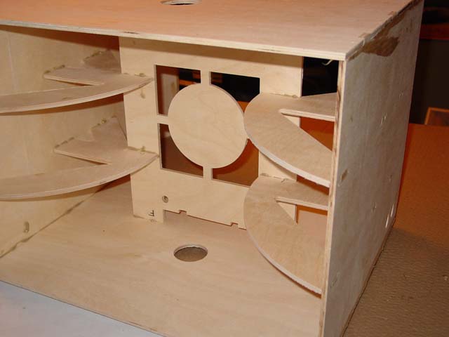

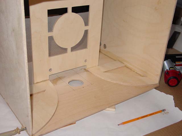

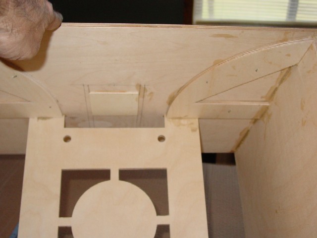

First 2 pics of #1 build...
Piece on top is a back brace to the hole I plugged with it's cutout. The hole was in the place the plans called for, which ended up being wrong. Made a new hole in what was the top (now the bottom) for the top hat. Didn't trust the top hat on the other side where the hole would have been moved.
The build order does change slightly, since the tabs align everything. the bottom, sides, top and baffle are done first, and then nailed, since it squares automatically.
Then the top and bottom braces are added, since they butt up against the sides and baffle.
Checked with a square after each brad, and it was perfect each time :clap: Glad I went through all the work in CAD to do the tabs..
One difference between this and my first W8 build is I am using PL on this one. Used Liquid Nails poly on the W8, and not sure which I like best yet. The PL does foam more while drying for sure, but the Liquid Nails version is way more friendly to use. The PL keeps wanting to push the nail out way after the pressure is let off, while the LN stopped right away, plus the PL is way messier to work with.
Time will tell which I stay with for the rest of my builds. I'm about to the stage of air leak testing on the W8, that may make my decision for me ....

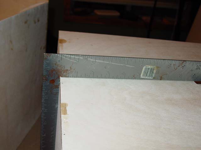

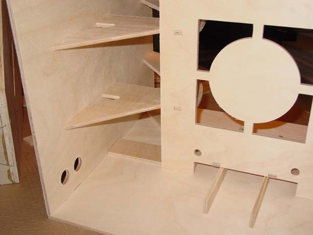

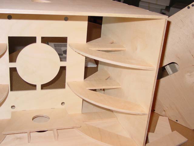

Just nailed CAB #2 together. Will keep the tabs/holes in the baffle for the braces as I cut them here, since I figured out a way to put it together with them. Glue the braces to each side, the stand them up and glue in the baffle. With them standing up, the top can go on next, tying it all together, then the bottom, then nail away. Very cool.... Stopped to take a pic while gluing. then finished gluing, and put it together. Whole process, including brads, maybe 20 minutes, if that.
You may not be able to see it in the pic, but there is no light sneaking out from between the square and the cab sides. Just nailed it all together this time, then checked...
Will never use screws again if I can help it. Air nailing brads and staples is the way to go...

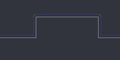

CamBam CAM software has an overcut to 'notch' out the inside corners.. It sends the bit at a 45 degree angle into the corner just enough to get rid of the fillet left from the radius of the bit.

I use a 1/16" bit on my stuff, bigger just cuts quicker, but wastes wood since parts can't be as close together. Use 1/8" bit on 1/2" wood...
Just cuts into the corner at 45 degrees. If it changes work planes, it wouldn't help..
The blue line is the cut path. CamBam blows away everything else I've used...
