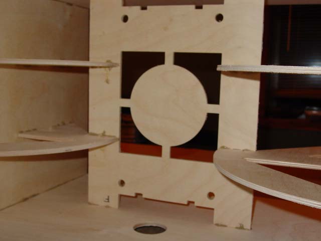

First here is the dry fit of the second J10 lite cut out. Many more tabs and slots, plus made the 2 inner braces one piece, with a tab on each leg going into the sides, and a tab going into the baffle.
That one is now changed in the CAD files. It doesn't go together easily with the baffle tab. The baffle hole and tab is now a small tab and a slot on the edge of the baffle, so it will slide right in, without having to move things.
Tabs on the duct, slots in the baffle. Easier to center that way...
No tabs on the Duct braces, that would be too extreme, I think (maybe not :idea: )
No tabs on the bottom and top braces, since they automatically align anyway.
I am changing things as I go, since I am building 2 more. On each one I figure what tabs work and with don't. That is also why I'm cutting 1 at a time, and testing, before cutting the next one.

First 2 pics of #1 build...
Piece on top is a back brace to the hole I plugged with it's cutout. The hole was in the place the plans called for, which ended up being wrong. Made a new hole in what was the top (now the bottom) for the top hat. Didn't trust the top hat on the other side where the hole would have been moved.
The build order does change slightly, since the tabs align everything. the bottom, sides, top and baffle are done first, and then nailed, since it squares automatically.
Then the top and bottom braces are added, since they butt up against the sides and baffle.
Checked with a square after each brad, and it was perfect each time :clap: Glad I went through all the work in CAD to do the tabs..

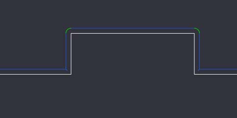

I'm curious to know ho you achieve square tabs and slots with a ( CNC ) router bit.
Nice looking build btw
eac
Posts: 58
Joined: Mon Aug 06, 2012 7:27 pm
Re: Jack 10 lite build x 2
#26 Post by eac »
Harley wrote:I'm curious to know ho you achieve square tabs and slots with a ( CNC ) router bit.
CamBam CAM software has an overcut to 'notch' out the inside corners.. It sends the bit at a 45 degree angle into the corner just enough to get rid of the fillet left from the radius of the bit.

Thanks for that explanation, but I am having difficulty imagining how the bit gets placed at 45 degrees to notch out that fillet.
That must be a sophisticated CNC machine you built and routs in more that two planes, correct?
Also how big is the router bit ( dia ) ?
eac
Posts: 58
#28 Post by eac »
Harley wrote:Thanks for that explanation, but I am having difficulty imagining how the bit gets placed at 45 degrees to notch out that fillet.
I use a 1/16" bit on my stuff, bigger just cuts quicker, but wastes wood since parts can't be as close together. Use 1/8" bit on 1/2" wood...
Just cuts into the corner at 45 degrees. If it changes work planes, it wouldn't help..
The blue line is the cut path. CamBam blows away everything else I've used...
