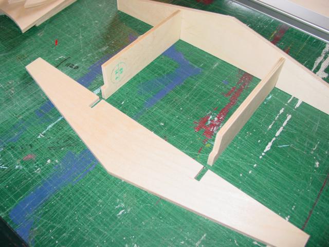

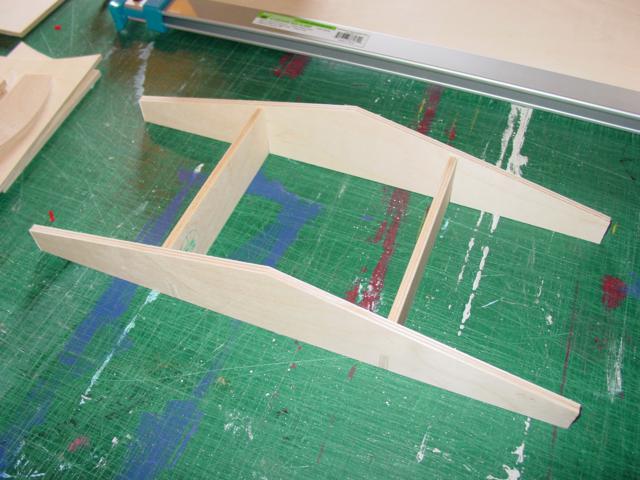

Had to cut a bnch of 1/4" PLY kit parts out, so I added a set of horn parts to the sheet. Not sure which way I'm going, driver or melded peizos. Each have their advantages.. So till I get some bigger sheets of 1/4" in, I decided to make a horn to play with.
Parts turned out great, all CNC cut except for the tapered horn sides. Did those by hand, as per the book. Cut the jig on the CNC router, though. All the angles are spot on, just a few swipes of a block sander smooths them out nicely.
Need to get an air brad nailer, I found out what I have only does staples :( so no pics of the horn put together. Clamped it all together, fits great and looks good.
I'm thinking about making the horn and peizos removable, so either one can go into the cabs. Mount the crossovers on the horn and peizos themselves, and have a molex connector to plug them in, that way I can play around to decide which I want, plus, in case of problems, such as blown driver or damaged peizos, I have a spare high end assembly to use in a hurry..
Really looking forward to getting the larger pieces of wood. 12" x 48" won't work ;(
Don

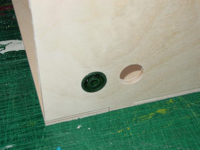

Hooray! Found 1/4" Baltic Birch PLY at a Hardwood Shop about 1.5 hours away that I had forgot about :D
If you are in the Springfied, MO area, Check out OP Hardwoods. Great selection, and they have 1/4", 3/8" and 1/2" BB PLY in 5' x 5' sheets, and it is beautiful wood. Straight and perfect! All stacked flat and stored indoors. Now I don't have to order the Aircraft Ply (same thing) from my main supplier at a higher cost, and don't have to wait another week. Since I had the sheet sizes I needed for the CNC cutting ready, they did all the cuts for $6.50... 2 cuts on 1 board, and 4 on the other. Oh yeah, under $30 per sheet.
Since I was going to be out cutting most of the day, I slipped in a couple sheets of the new ply and cut a bunch of parts. Hopefully will finish tonight. Just cutting one till I know it all goes together. I trust the plans, just making sure I didn't put any wrong values in when laying out the CAD work.
You will notice tabs and matching slots in most of the parts. It only take a few minutes in CAD to do this, I do it on most of my RC kits. IT will speed up construction greatly, since everything will automatically align perfectly. No more screwing around getting stuff lined up before fastening :clap:
More pics later.....

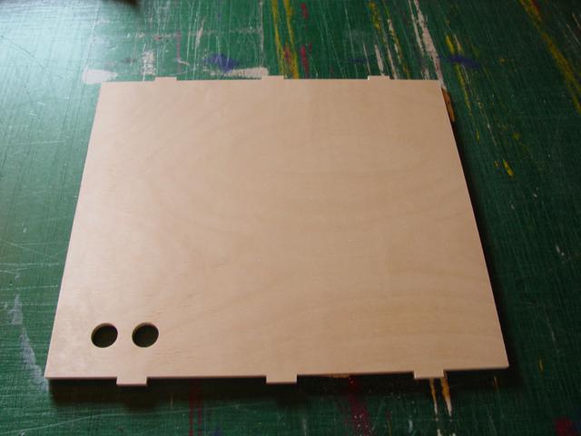

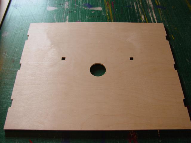

Bottom Panel with top hat hole and slots for tabs on Baffle
Side panel with Neutrik cutouts

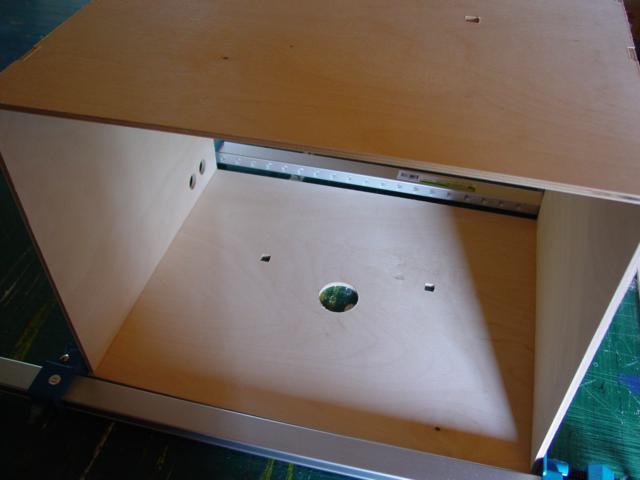

A couple of pictures showing the cabinet dry fitted together. Still have to cut the angles on the sides and duct tops. Will do those on the table saw...
Once I cut the baffle, with the tabs on the feet, it will go together perfectly square..
Don

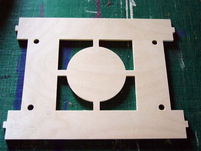

The rest of the parts are cut, except but the poplar ply curved parts, which will cut when needed, to verify fit, and the woofer spacer, which will cut from 1/2", instead of gluing two 1/4" pieces together. Waiting for speakers to arrive, so I can verify the hole size.
Also made four 1/4" plugs to fill the holes in the top and bottom, where I was originally going to make the baffle out of 1/2" ply. They make up the difference between the 1/2" and 1/4" tabs. Used the mantra, 'Trust the plans, Luke' ooops, I mean Don
Glad I cut one out first, instead of both at once. Already found a few changes I want to make. The baffle back to 1/4" was the first change, and I want to add a fillet to the inside corner of the sheath braces. Inside corners coming to a point like that are just waiting to fracture. It makes it much easier for hand cutting that way, but since I'm cutting it CNC, might as well take advantage of it.
Hopefully the build will start tomorrow. This will be fun. :hyper: They will be much more fun to build than the W8's were.
Don
