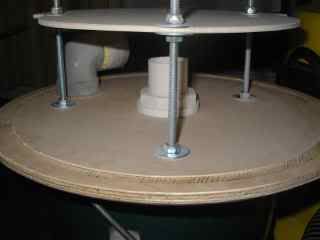

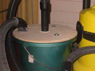

UROK wrote:I like the idea of making a DIY cyclone for the vac.
You may want to look up the JP Thien cyclone design. I've made a small version from an old bucket and a handful of scrap pieces. It works very well for me in combination with a small shop vac.

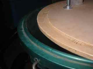

Here's mine.

Thanks for the pics. Looks great and easy to build. Now I just need to find some cheap hose. (never thought I would say that)

It was your one I had in mind AntonZ. Thanks! But there were other pics in that thread too, weren't there?

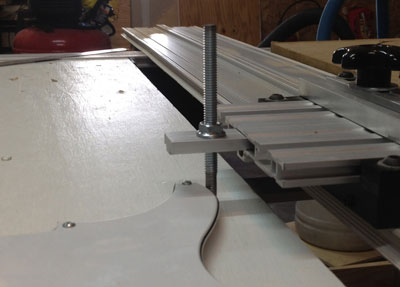

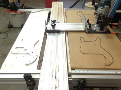

Like the others said, I can make great dadoes with my router attachment.
I don't make tenons, but I know others have with the router.
My wife can't store anything on top of mine, cuz it's light enough for me to haul up to the ceiling of the garage when I'm not using it.
http://www.youtube.com/watch?v=wY9Kfjepw1U

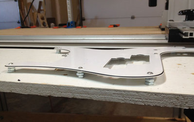

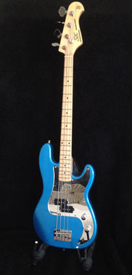

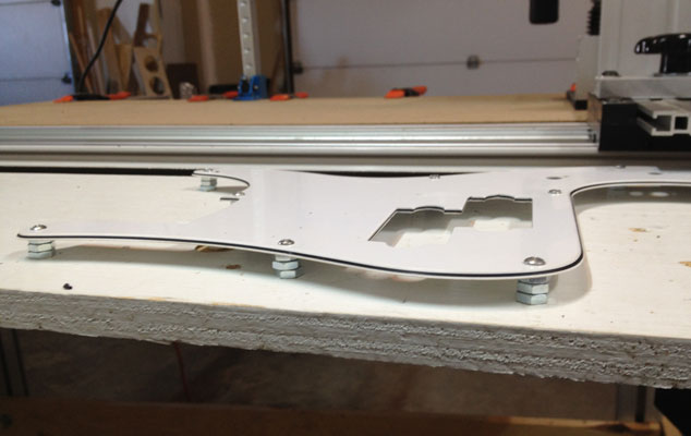

Also, try this with the tablesaw. Duplicated a pickguard with the router attachment. :mrgreen:

JSWC - thanks!
Great info. I'm most grateful.
And, er...WOW! :clap:
What an ingenious template follower. So many possibilities.
