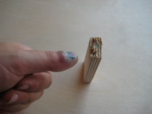

My miter saw caught a scrap of wood sitting on it when I was sawing a support for the brace that wasn't sitting right. :cop:
It pushed it into the fence and broke it in half, about 1.5" of .5" ply. :!:
The real problem was my thumb was in between it and the fence. :cussing:
It may be broke too. :clap:

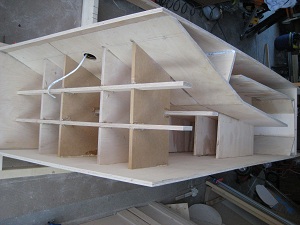

Well I have the whole thing closed up. Found one airleak and plugged that. 2 coats of stain went on, I may do another just to make the wife happy. Hopefully varnish tomorrow and move it in by Wednesday. The last side gave me a ton of trouble as usual, I was about 1/2 off of square and couldn't pull it back in. Also even though almost everything went in like nothing there is some warping in the outer panels, not enough to notice by the casual observer. Anyway here are some pics from a couple days ago, will try to get some tomorrow too.
I finally found the second half of the wood that went flying off the other night.
Thumb resized.jpg (19.15 KiB) Viewed 2590 times
Found the other side of the wood broke over my thumb during cleanup tonight.
All but the side.jpg (34.95 KiB) Viewed 2590 times
Ready and waiting for the final side.
