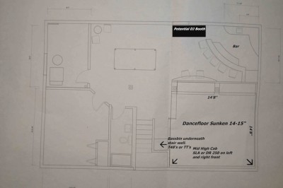

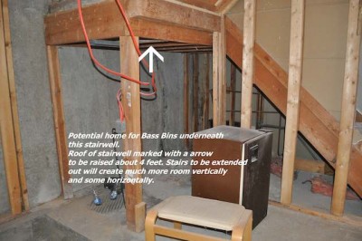

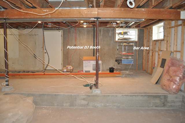

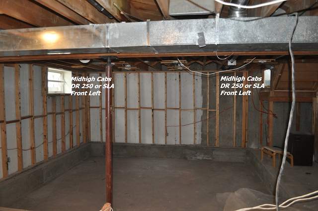

Good morning guys,
I chanced the blizzard and made it over to get my initial pics taken. The systems priority is going to be for the disco 1st and UFC/HT 2nd. He was even talking about having a little Bose for HT. I am not a big fan but, I respect his wishes. If I can however create a cost effective system that can do both with the above priority taken into account with ample headroom present for the wildest possible disco nights than that is a possibility.
The pic with the stairwell is going to be changed and expanded fairly soon, but those measurements are not yet known. Regardless there may be a way to tuck a couple bassbins underneath the stairwell with ample room for cab width.
More pics to come.
Thoughts?
Thanks
Jordy

Re: Basement Disco System
I think you're thinking correctly.
If it was me I'd build do 2 x SLAs and 2 TTs or THTs put in the spots you're showing. At full proper amplification you won't be able to hear each other speak without screaming in ears....which is "loud enough" IMO. Don't bother with surround sound or Bose or any of that. Rock out a 2.1 HT with killer bass. Nobody will be complaining.
