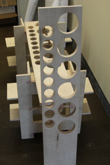

If you want to rear mount you might want to make you back box bigger so that it goes around the baffle not behind it so that the drivers will fit. Mine also uses the Goldwoods I just front mounted everything. If you want them to be free standing might consider a base that sticks out the front 1.5-2 inches to make it less tippy.

I have already built the cabinets. I will be test fitting the baffle this weekend. I like the idea of doing a minor recess for the speaker mounting.
The knot on the surface is acually the back side of the baffle. The concern is that on the webbing between the woofer holes is 1/4" or less of good wood. If I do not remove and epoxy the knot, the face of the web between the woofers will crack due to pressure and vibration over time. The holes for the tweeters are already rounded over. The only reason to surface mount the tweeter now is if I have some kind of clearance issue with the side of the cabinet.
I have some of the maple left over and I do intend on building a "foot" just as reccommended, thanks... especially with the weight of all the drivers, these will be quite heavy. It would be a shame to have them fall over.
