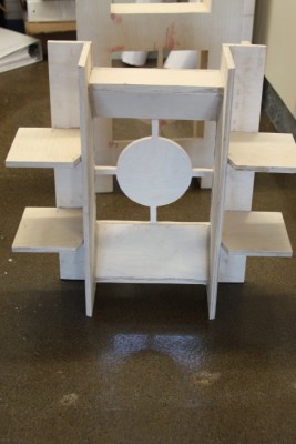

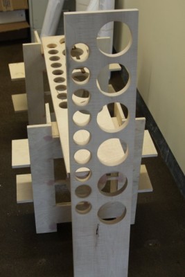

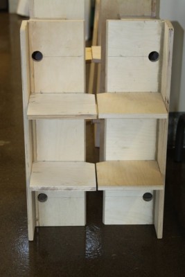

Here are some other pictures. SLA baffles and Jack 15 internals.
I have already built the cabinets. I will be test fitting the baffle this weekend. I like the idea of doing a minor recess for the speaker mounting.
The knot on the surface is acually the back side of the baffle. The concern is that on the webbing between the woofer holes is 1/4" or less of good wood. If I do not remove and epoxy the knot, the face of the web between the woofers will crack due to pressure and vibration over time. The holes for the tweeters are already rounded over. The only reason to surface mount the tweeter now is if I have some kind of clearance issue with the side of the cabinet.
I have some of the maple left over and I do intend on building a "foot" just as reccommended, thanks... especially with the weight of all the drivers, these will be quite heavy. It would be a shame to have them fall over.
So, is ther really any difference between "speaker gasket" and a high density foam tape/weather seal?
2 SLA's Curly Maple Baffle
2 Jack 15's 3015 Loaded
4 Tuba 30's Delta LFA Loaded
