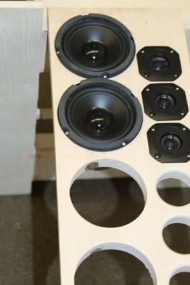

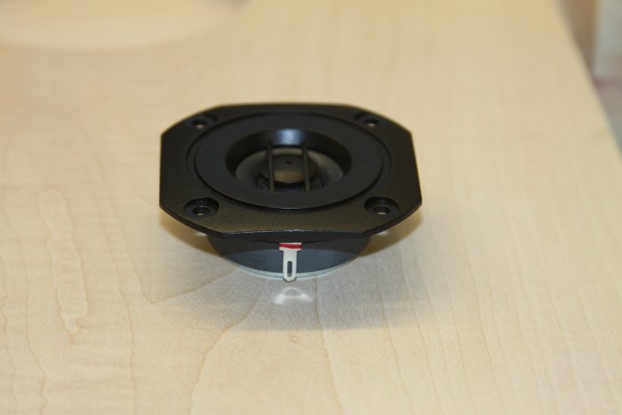

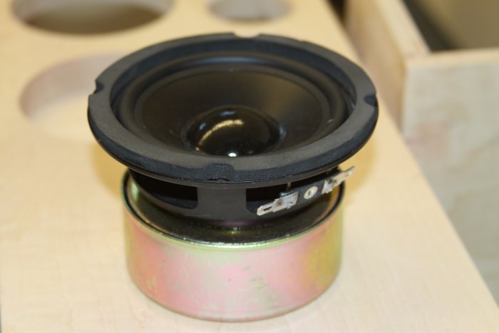

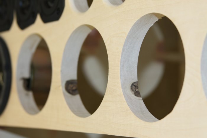

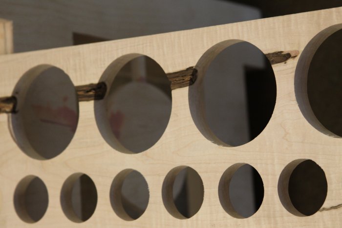

I received my tweeters, woofers, and crossovers from Speaker Hardware today for the SLAs.
When I routed the holes for the SLA baffles I started on the larger holes. I had intended on installing the woofers on the surface and the tweeters on the back just as the drawings. I had assumed the speakers I would be receiving would be the same as shown in the drawings. They are not or have been through a design revision. These speakers look to be better suited for back mount. I have read plenty of posts on here for adding gasket tape and surface mounting, can this be done in a manner which will be hidden from the eye? I ask because I was still on the learning curve with the jasper jig. The user must apply slight inward pressure on the final pass to insure the edge of the hole does not get nicked by the bit when the center of the whole is cut free. I have two holes that have a minor nick, but had fixed my technique by the time I set the tweeter holes. The other eyesore would be a knot/stick in the wood that I have to drill out an epoxy to avoid a failure point. This simply will no look good in a back mount situation. Do I have to go with "speaker gasket" or can I use some 1/4 inch high density foam tape?
1) Tweeter
2,3) The Stick/knot problem I have to cut out and epoxy or it will fail.
4)Woofer
5) A few speakers in place, I still intend on back mounting the tweeter.
2 SLA's Curly Maple Baffle
2 Jack 15's 3015 Loaded
4 Tuba 30's Delta LFA Loaded

#14 Post by Chris_Allen »
You could always remove the gasket to make them look better with a front mount.
I would agree that would look better as a rear mount in current form. The correct router bit would allow you to slightly recess the drivers for a front mount and a flush finish. If you are feeling brave, recess a little deeper and apply a very thin, almost veneered, wood ring on top.
Re: Jack 15 and SLA Build - A First Time Experience
#15 Post by DJPhatman »
My vote is round over the front of the woofer baffle holes and rear mount the drivers. I would also rear mount the tweeters, letting the fine finish of the baffle wood shine through.
Unless they are already loose, don't mess with the knots. They give the wood "character", and add to the warm look of the wood.
