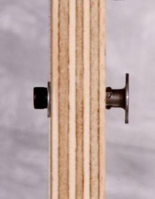

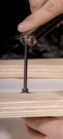

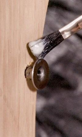

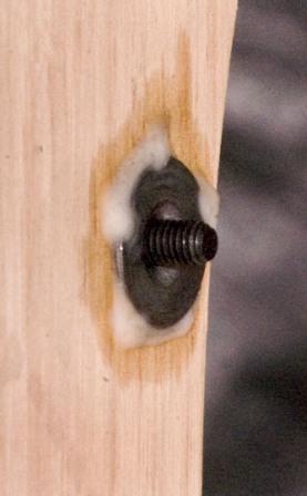

These are the directions from a guide I wrote for another cab.
Apply a little epoxy to the barrel ONLY of the hurricane nut, DO NOT GET EPOXY ON THE BOLT THREADS!
Holding the hurricane nut, tighten the bolt with the wrench just until the flat part of the hurricane is tight against the baffle. DO NOT OVERTIGHTEN, just pull it snugly.
Remove the bolt. Repeat for all 8 holes, remixing epoxy as needed. After the glue dries, and before installing the driver, spin a bolt through each nut to make sure the threads are clean. If not, you will need to get a 10-32 tap to run through the nut.

Thanks, that was fast.
I need to get a few of those brushes. It looks like I should put on more epoxy than I have been.
