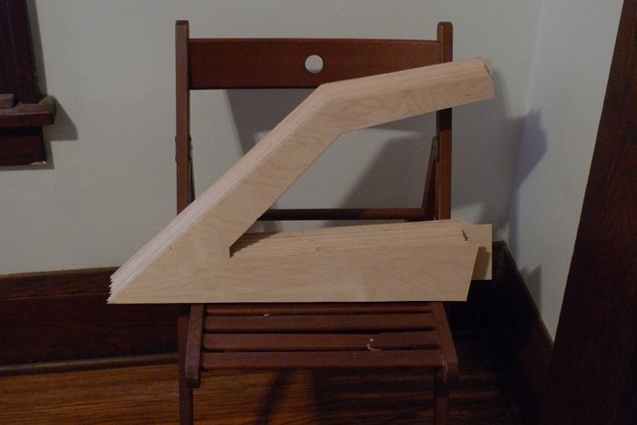

After more a year or so of doing everything but building, I have some progress to show. Tomorrow, I'll do some baffles.
