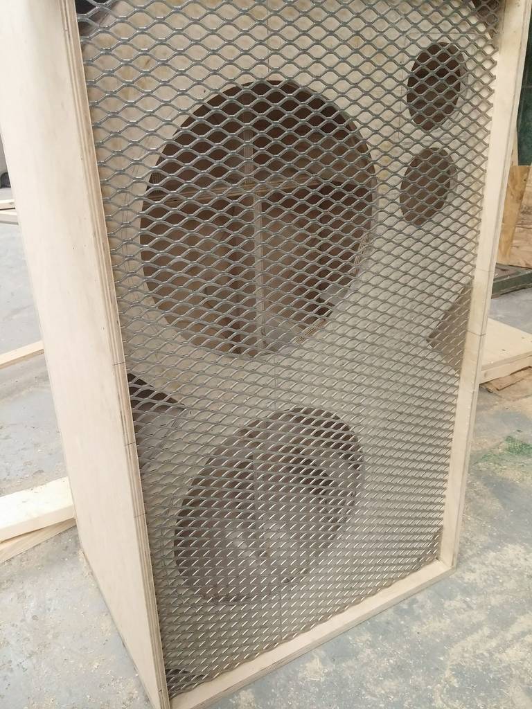

Grill cutted and polished, ready to paint black

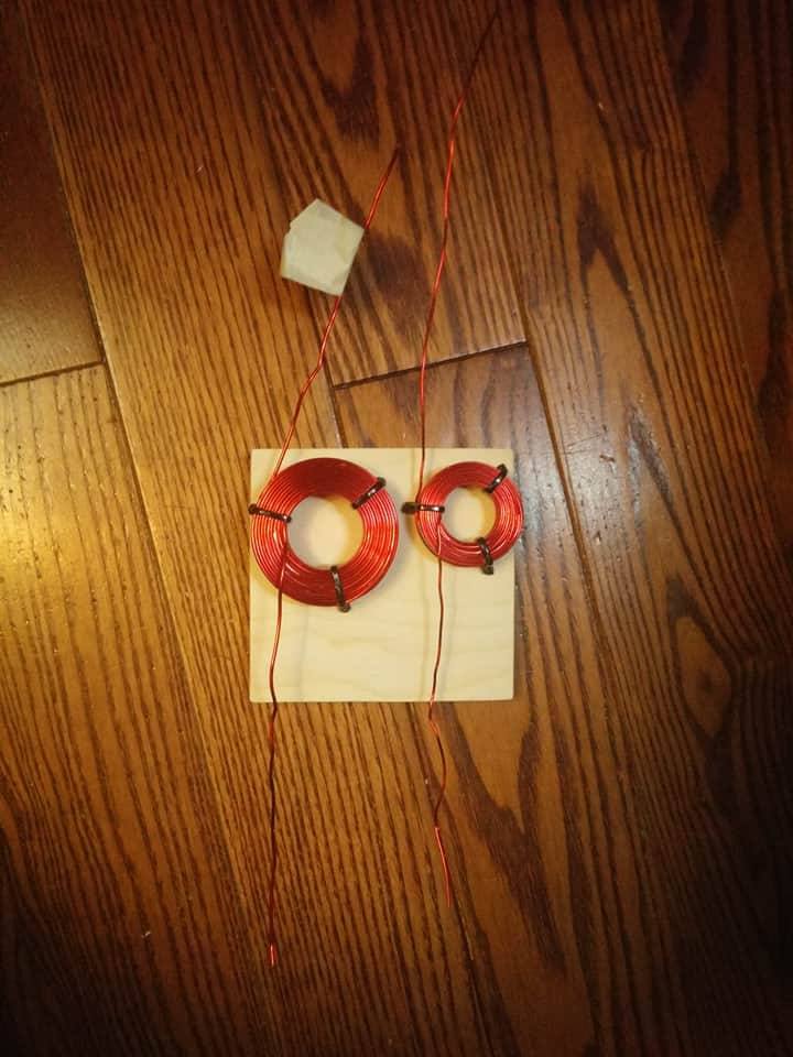

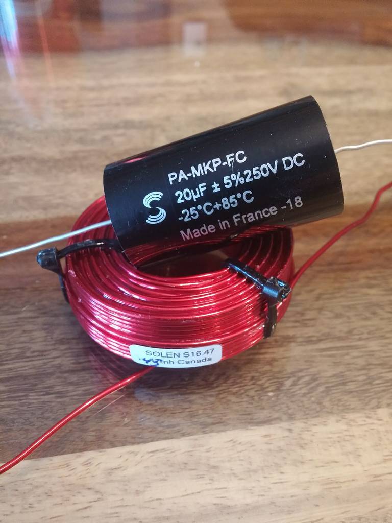

So i got the parts and i'm wondering if the mh value is including all the spare wire that comes off the coil itself?
If yes what should i do to not have a really too big crossover woodplate? Can i just make it in circles like the coil even if its not in the tie wraps?
Yes all the inductors length is part of it's value. Wind some of that wire back into the coil, with just enough out to connect to the other parts of the crossover.
Also, stand the smaller inductor upright, and place it 90 degrees perpendicular to the larger coil if it has to be that close.
If you have HF components, better to place the components for that filter on another board entirely...

Ok cool, yes well do i put the wire back in the coil hole or i make it so that it's like if there was more turns?Grant Bunter wrote: ↑Thu Apr 05, 2018 5:03 pm Yes all the inductors length is part of it's value. Wind some of that wire back into the coil, with just enough out to connect to the other parts of the crossover.

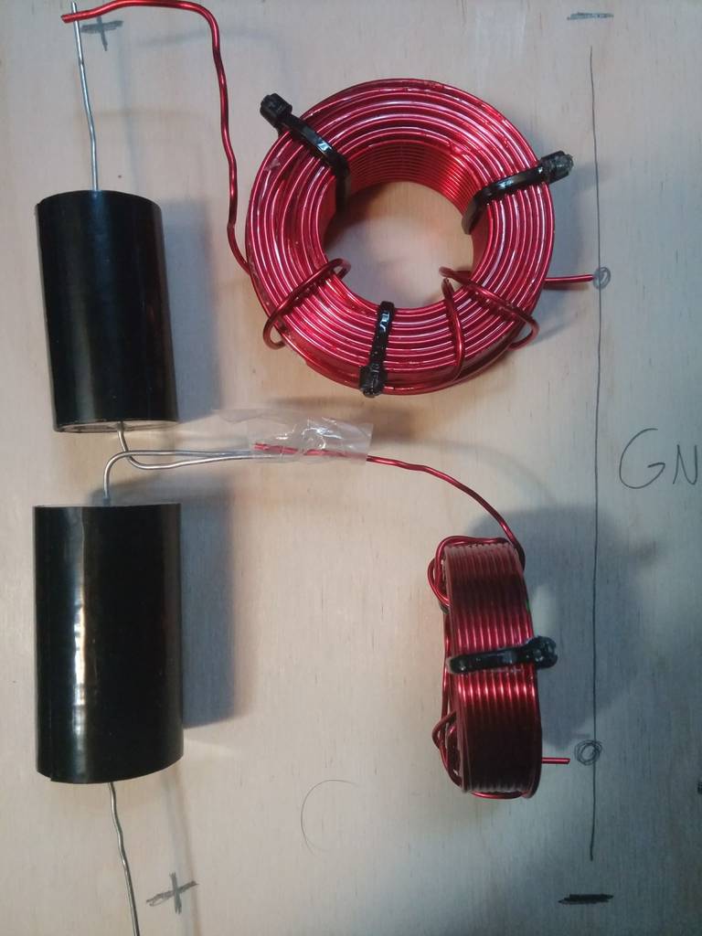

here's the crossover parts on a wood plate for the HF crossover only, i know i know i will buy the kits if it sounds not as expected because i used poly instead of elect caps but all the same values as the build doc.
hope it's ok
hope it's ok

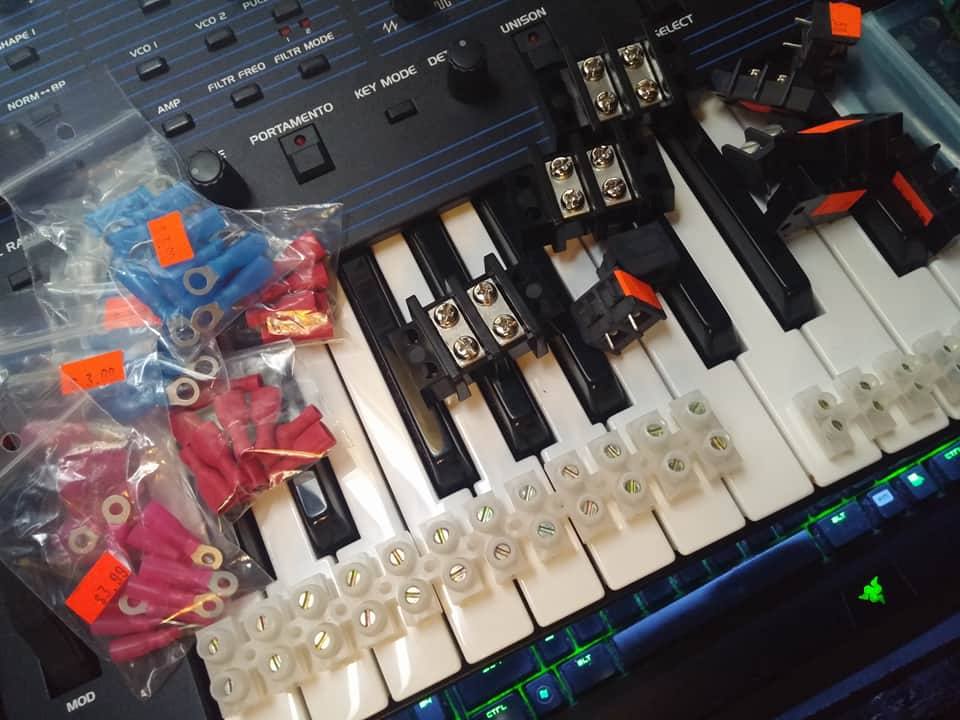

I'll use something like this to connect in and out of each crossover
https://www.digikey.ca/product-detail/e ... ND/2283961
- Posts: 29087
The high pass specifies polys.Electric Wisdom wrote: ↑Thu Apr 05, 2018 7:56 pm here's the crossover parts on a wood plate for the HF crossover only, i know i know i will buy the kits if it sounds not as expected because i used poly instead of elect caps

Right, my bad, i wanted to mean that all caps i bought at the moment are polyBill Fitzmaurice wrote: ↑Thu Apr 05, 2018 9:17 pmThe high pass specifies polys.Electric Wisdom wrote: ↑Thu Apr 05, 2018 7:56 pm here's the crossover parts on a wood plate for the HF crossover only, i know i know i will buy the kits if it sounds not as expected because i used poly instead of elect caps![]()

Just got the fancy block terminals to make a somewhat cleaner crossover than i thought
So excited
So excited
