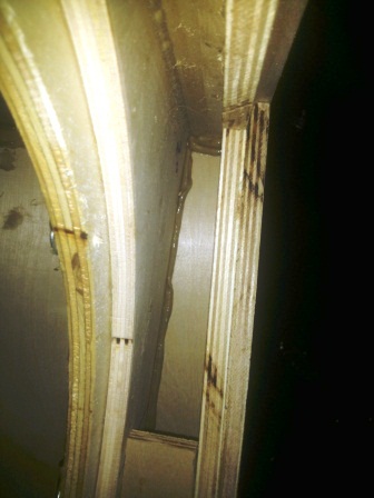

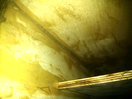

Here are a few internal looks. Joints represented in these pics are the side of the Titan where the last side piece was installed. The tricky side.

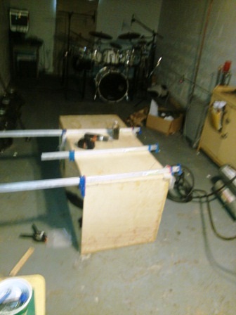

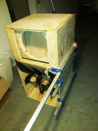

Few clips of the clamping process...keeping things lined up
