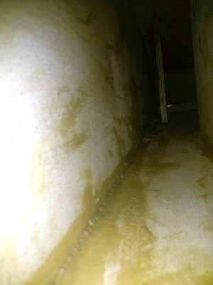

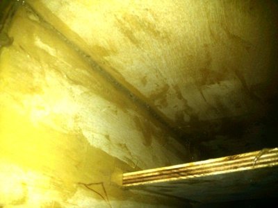

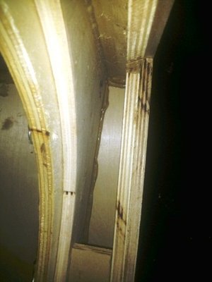

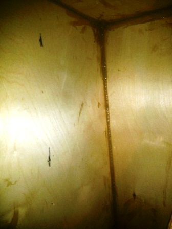

Here are a few internal looks. Joints represented in these pics are the side of the Titan where the last side piece was installed. The tricky side.

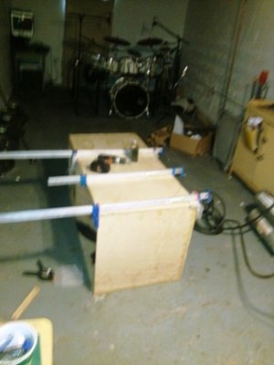

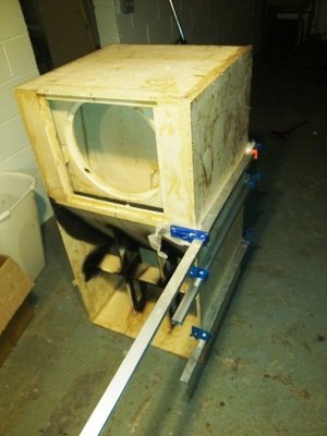

Few clips of the clamping process...keeping things lined up

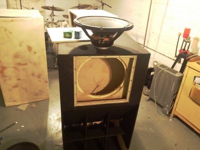

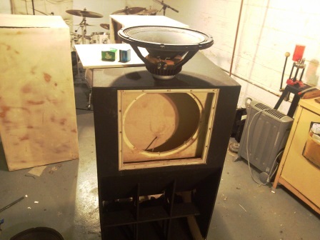

Primed and ready to mount the driver...i gotta hear these things

Looking great, man! Having cut all the wood for 4 T48s myself, I can only imagine the PILE you had for eight of them and how long it took to cut it all! Keep us posted.
