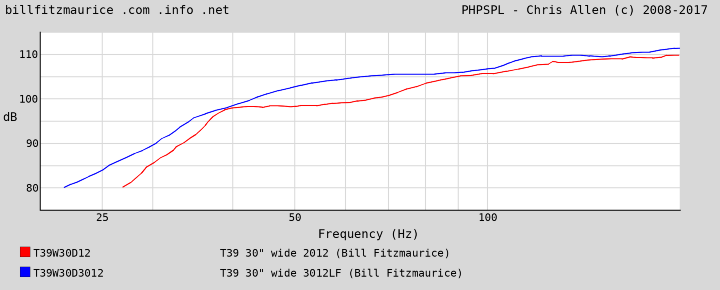

Here's the Delta 12LFA and 3012LF (I made a mistake AGAIN! CORRECTION: it's actually an S2012, not a Delta 12 LFA :wall: Time to step away from the computer. LOL )
The two plots are nearly identical. Good catch Grant :thumbsup:
Here's the plot for 2 LAB12 loaded cabs.
If I subtract 6dB from the same points on that plot, I get results that are very similar to the other plot anyway. Do it yourself if you don't believe it:
With the transposed LAB12 results, the 3012LF is still considerably ahead
+3dB at 45HZ, +5dB at 50Hz, +5dB at 60Hz, +5 dB at 70Hz
...and look to be slightly worse than the numbers I came up with for the Delta 12LFA:
+3dB at 45HZ, +4dB at 50Hz, 5dB at 60Hz, 3-4ish dB at 70Hz
So, while there was a mistake (good catch on that BTW) the results aren't any better than what I previously thought either. Upon realizing my mistake, I had really hoped they would be.

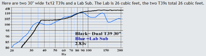

Are you basing your calculations on this chart?
Are your calculations out, because this compares different designs and drivers from Bill (T39) and Danley (the labsub)?

I did. I just took 6dB off the 2x 30" LAB12 loaded trace to identify a single cabs response, compared it to the trace for a 30" 3012LF loaded cab, and posted the difference.
I don't think so (scratching my head though). If anything, using that trace and subtracting 6dB could be slightly generous in the lower end, making the LAB12 look a little better than a true 1 cab response chart. It seems to be completely reasonable method to identify a single cabs response, given the lack of a chart for a single cab... to me anyway.
Are you seeing something I'm not. It's completely possible I'm overlooking something (again LOL).

#1064 Post by Bruce Weldy »
Seth wrote: Mon Sep 13, 2021 11:35 am
I think you missed his point......the black line on the graph is for a BFM speaker. The blue
line is for a Danley Lab sub - not a BFM speaker with a Lab12 in it.
