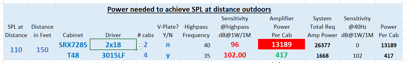

The other day I was just jotting some equation notes in mine, then figured I'd go ahead and make quick, simple, working "calculators" to go along with the notes... That was a bit of a mistake; I led myself right down a rabbit hole and the next thing I know I'm creating a multifaceted calculator with dropdown menu's, auto-populating conditional values, along with color changing boxes and warning text when values are out of range. :roll:
Here's one of the longer cell formulas. LOL It auto populates one cell (Sensitivity) based on the values of two other cells (Cab and Driver)
=IF(AND(O52="T24",P52="S2010"),91,IF(AND(O52="T24",P52="BP102"),88,IF(AND(O52="T24",P52="KappaPro10LF"),88,IF(AND(O52="T24",P52="KL3010LF"),91,IF(AND(O52="T30",P52="S2010"),91.5,IF(AND(O52="T30",P52="BP102"),90,IF(AND(O52="T30",P52="KappaPro10LF"),90,IF(AND(O52="T30",P52="KL3010LF"),90,IF(AND(O52="T30",P52="S2012"),90,IF(AND(O52="T30",P52="Delta12LFA"),93,IF(AND(O52="T30",P52="3012LF"),93,IF(AND(O52="T30",P52="LAB12"),95.75,IF(AND(O52="T30",P52="12NLW9300"),92,IF(AND(O52="T45",P52="S2010"),91.5,IF(AND(O52="T45",P52="BP102"),90,IF(AND(O52="T45",P52="KappaPro10LF"),93,IF(AND(O52="T45",P52="KL3010LF"),90,IF(AND(O52="T45",P52="S2012"),90,IF(AND(O52="T45",P52="Delta12LFA"),93,IF(AND(O52="T45",P52="3012LF"),93,IF(AND(O52="T45",P52="LAB12"),95.75,IF(AND(O52="T45",P52="12NLW9300"),92,IF(AND(O52="T39",P52="12NLW9300"),101.5,IF(AND(O52="T39",P52="LAB12"),96.75,IF(AND(O52="T39",P52="3012LF"),101,IF(AND(O52="T39",P52="Delta12LFA"),95,IF(AND(O52="T39",P52="S2012"),98,IF(AND(O52="T39",P52="KL3010LF"),95,IF(AND(O52="T39",P52="KappaPro10LF"),95,IF(AND(O52="T39",P52="BP102"),95,IF(AND(O52="T39",P52="S2010"),97.5,IF(AND(O52="T60",P52="LAB15"),93.75,IF(AND(O52="T60",P52="LAB12x2"),92.75,IF(AND(O52="T60",P52="LAB12"),91.75,IF(AND(O52="T48",P52="15NLW9300"),103,IF(AND(O52="T48",P52="LAB15"),100.75,IF(AND(O52="T48",P52="3015LF"),102,IF(AND(O52="T48",P52="KappaPro15LF"),101,IF(AND(O52="T48",P52="Kappa15LF"),101,IF(AND(O52="T48",P52="12NLW9300"),99,IF(AND(O52="T48",P52="LAB12"),96.75,IF(AND(O52="T48",P52="3012LF"),98,IF(AND(O52="T48",P52="Delta12LFA"),98,IF(AND(O52="T48",P52="S2012"),98,IF(AND(O52="SRX728S",P52="2x18"),96,"Driver")))))))))))))))))))))))))))))))))))))))))))))
I've got to imagine Mr. Chris Allen has an audio spreadsheet or two too.

Pic for context. It's still a work in progress. The highpass frequency figures, sensitivity at those values, and the HZ values still need to be set up to work properly. The sensitivity indicated for these two cabs is actually at 40Hz for both.
The red box indicates the value is beyond the limits of the combination. The "V-Plate" option adds 3dB to the sensitivity, but the function disabled for T45, T60, and SRX728S cabs... even if it's says "Y", it's not factored in.
