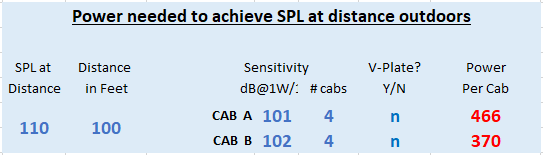

I think it's important to distinguish that 1dB in peak output is very very different than the power of a 1dB difference in sensitivity.
I used the term "the power of a 1dB difference in sensitivity" very intentionally, because 1dB in sensitivity can mean the difference of hundreds (if not thousands) of watts.
If you have 4 cabs and want to hit a specific SPL at a specific distance outdoors, say 110dB at 100 feet/30.5 Meters...
The difference in total power required for the 4 cabs is 384 watts less for the cabs with sensitivity of 102dB vs the cabs with 101dB sensitivity.
Also note that if both cabs have a 55 volt limiter set, the 101dB cab won't meet the goal.
And that's just 1dB difference in sensitivity.

Seth wrote: Sun Sep 12, 2021 4:52 pm I think it's important to distinguish that 1dB in peak output is very very different than the power of a 1dB difference in sensitivity.
I may be wrong here, this may well be the case for direct radiators, but not horn loaded cabs.
It's not the driver that dictates response in horn loaded cabs, it's the design.
ie same or more volume from a "lesser" driver, with less power, meaning sensitivity has risen...

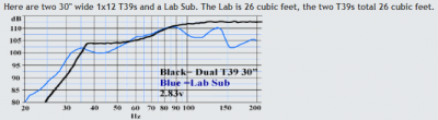

Damn, I think you're right Grant! The only other curves on that page that looked similar were comparing two LAB12 loaded cabs. I just looked at the curve shape and made the ASSumption.
Here's the Delta 12LFA and 3012LF (I made a mistake AGAIN! CORRECTION: it's actually an S2012, not a Delta 12 LFA :wall: Time to step away from the computer. LOL )
The two plots are nearly identical. Good catch Grant :thumbsup:
Here's the plot for 2 LAB12 loaded cabs.
If I subtract 6dB from the same points on that plot, I get results that are very similar to the other plot anyway. Do it yourself if you don't believe it:
With the transposed LAB12 results, the 3012LF is still considerably ahead
+3dB at 45HZ, +5dB at 50Hz, +5dB at 60Hz, +5 dB at 70Hz
...and look to be slightly worse than the numbers I came up with for the Delta 12LFA:
+3dB at 45HZ, +4dB at 50Hz, 5dB at 60Hz, 3-4ish dB at 70Hz
So, while there was a mistake (good catch on that BTW) the results aren't any better than what I previously thought either. Upon realizing my mistake, I had really hoped they would be.

Hmm. I'm a little confused about what you've written here. It doesn't seem to correlate at all to what I wrote.

Seth wrote: Sun Sep 12, 2021 10:53 pm Hmm. I'm a little confused about what you've written here. It doesn't seem to correlate at all to what I wrote.
Lol, fair enough.
Where I'm coming from is, sensitivity of the driver is moot in horn loaded cabs IIRC, but may apply more to direct radiators.
Apart from that,
Sensitivity is a calculation. And the specified sensitivity for a a particular driver may not be that which appears in the TS parameters for that driver, because TS parameters are an average across a/multiple production runs. To know sensitivity, you would need to test all your drivers.
To many factors, like power compression, temperature, air pressure can change to make driver sensitivity calculations almost meaningless,
I feel better off using peak output readings, and not worrying about watts at all.
Again, because watts is a calculation you can't make in the middle of a gig unless you can do so in a time that makes the calculation have relevance.
If that still doesn't correlate with what you wrote, it must be the Aussie in me...

Are you basing your calculations on this chart?
Are your calculations out, because this compares different designs and drivers from Bill (T39) and Danley (the labsub)?

Grant Bunter wrote: Mon Sep 13, 2021 1:14 am Oh, Seth mate,
I did. I just took 6dB off the 2x 30" LAB12 loaded trace to identify a single cabs response, compared it to the trace for a 30" 3012LF loaded cab, and posted the difference.
I don't think so (scratching my head though). If anything, using that trace and subtracting 6dB could be slightly generous in the lower end, making the LAB12 look a little better than a true 1 cab response chart. It seems to be completely reasonable method to identify a single cabs response, given the lack of a chart for a single cab... to me anyway.
Are you seeing something I'm not. It's completely possible I'm overlooking something (again LOL).

That all sounds reasonably accurate. But, the post was about cab sensitivity, not driver sensitivity.

Seth wrote: Mon Sep 13, 2021 11:35 am
I think you missed his point......the black line on the graph is for a BFM speaker. The blue
line is for a Danley Lab sub - not a BFM speaker with a Lab12 in it.
