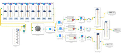

Check my rough draft if you will.
Weldon Carter
CarterKraft
- Posts: 263
- Location: DFW
I finally figured out for whatever reason that modifying a existing project doesn't seem to work that great. It runs out of RAM/MIPS? when compiling.
So I started from scratch, that is what you are seeing in this screen shot, I have not took the time to label everything because I am not 100% sure It will compile/write to the DSP chip.
The parametric EQ seems to be capable to have many bands but each band uses RAM and I didn't want to get greedy so a 9 band is what I started with.
The frequencies listed are just taken off a Behringer MINIFBQ FBQ800 so I have no idea if that is the correct freq's I need or not. It is easy to change , just type in the field.

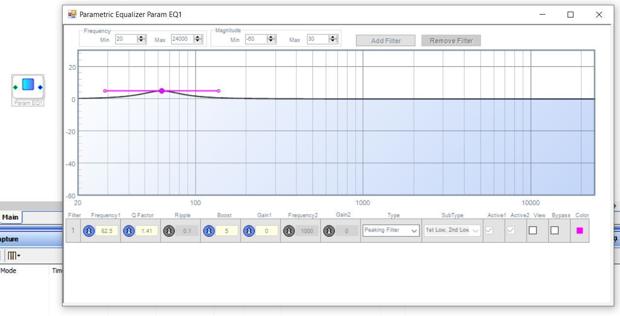

Are you sure that's a parametric EQ? I've never seen a GUI presented that way. Does the blue button above the band slider bring up a window to adjust Q?
I've only seen them look like this:
Are you able to find that one?
Apparently, it's located here:
What does the GUI look like when you open the individual driver EQ's?
I'd add the dynamic bass module after the pre-crossover EQ, followed by the Psychoacoustic/SuperBass module prior to the mono mixer.
Other than that, I think it looks good.

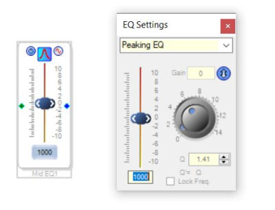

Yes exactly, the button on the slider opens a dual knob interface that adjusts Q and gain I think, for sure Q.
I think I can pick either style, the slider or straight filter based method like you posted. In my mind I wanted to see sliders so I looked for that one, but it could easily be the style you posted, that is actually what the individual EQ's are for the drivers.
So far getting a "working" project has been the struggle so I was trying to add logic/algorithms in steps so I can see when/if it get's messed up.

Here is the slider GUI This is the individual driver GUISeth wrote: ↑Wed Sep 28, 2022 11:52 am Are you sure that's a parametric EQ? I've never seen a GUI presented that way. Does the blue button above the band slider bring up a window to adjust Q?

I personally much prefer the more traditional parametric than the one with sliders. I find the visual representation of the individual filters to be very helpful.
But, it's your deal. Whatever floats you boat. Whatever turns ya on. Whatever's clever. Whatever puts lead in your pencil. Whatever toots your horn. Whatever suits you. Whatever blows your skirt up.
