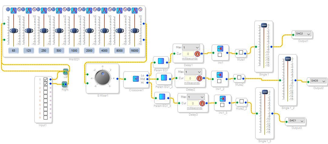

I finally figured out for whatever reason that modifying a existing project doesn't seem to work that great. It runs out of RAM/MIPS? when compiling.
So I started from scratch, that is what you are seeing in this screen shot, I have not took the time to label everything because I am not 100% sure It will compile/write to the DSP chip.
The parametric EQ seems to be capable to have many bands but each band uses RAM and I didn't want to get greedy so a 9 band is what I started with.
The frequencies listed are just taken off a Behringer MINIFBQ FBQ800 so I have no idea if that is the correct freq's I need or not. It is easy to change , just type in the field.

Are you sure that's a parametric EQ? I've never seen a GUI presented that way. Does the blue button above the band slider bring up a window to adjust Q?
I've only seen them look like this:
Are you able to find that one?
Apparently, it's located here:
What does the GUI look like when you open the individual driver EQ's?
I'd add the dynamic bass module after the pre-crossover EQ, followed by the Psychoacoustic/SuperBass module prior to the mono mixer.
Other than that, I think it looks good.

Yes exactly, the button on the slider opens a dual knob interface that adjusts Q and gain I think, for sure Q.
I think I can pick either style, the slider or straight filter based method like you posted. In my mind I wanted to see sliders so I looked for that one, but it could easily be the style you posted, that is actually what the individual EQ's are for the drivers.
So far getting a "working" project has been the struggle so I was trying to add logic/algorithms in steps so I can see when/if it get's messed up.

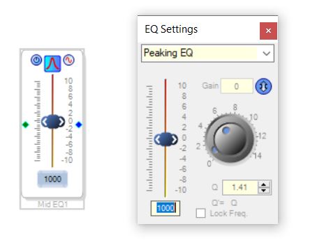

Here is the slider GUI This is the individual driver GUISeth wrote: ↑Wed Sep 28, 2022 11:52 am Are you sure that's a parametric EQ? I've never seen a GUI presented that way. Does the blue button above the band slider bring up a window to adjust Q?

I personally much prefer the more traditional parametric than the one with sliders. I find the visual representation of the individual filters to be very helpful.
