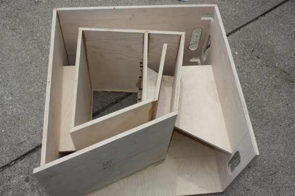

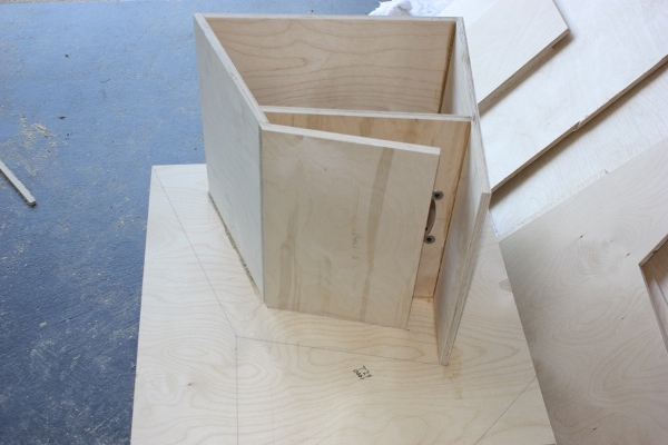

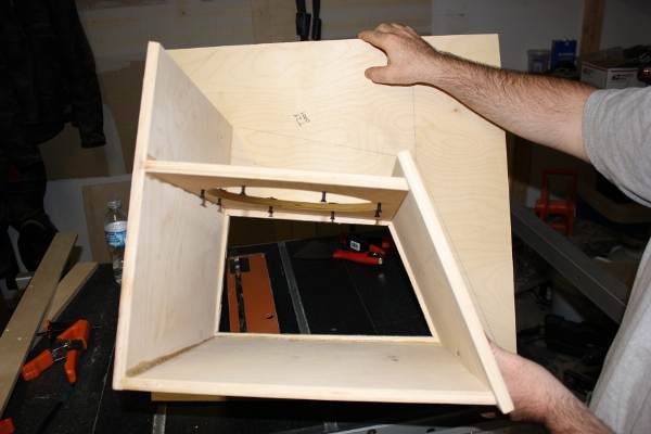

Here's some build pics of the tubas, and an XF 410 waiting for hardware.

Bottom reflector?

Re: XF 410 / Tuba 24 (Cincinnati, OH)
I always used to do the reflectors last, flippin' 45 degree cuts were not popular with my circular saw. The table saw doesn't care
My table saw isn't real happy with 45-degree cuts either.
I'm thinking a sled or other jig is worth building if one is going to do a number of these cuts.
I built a jig for my OT212 to use a router for the cuts.
That is slow and painful business also, so I'm still on the hunt for something that is accurate and fast.
Yeah I put the reflector in afterwards. I think it would be tough to get nice and square before.
As long as they seal the hand hold openings and wheels, you are good.
That is the low pressure end of the horn, and low risk.
