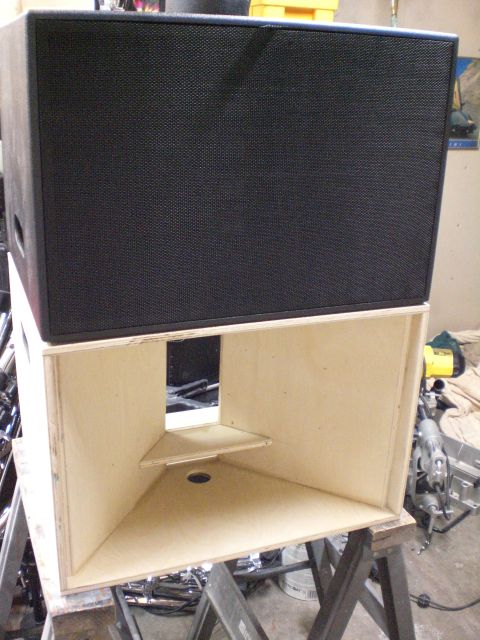

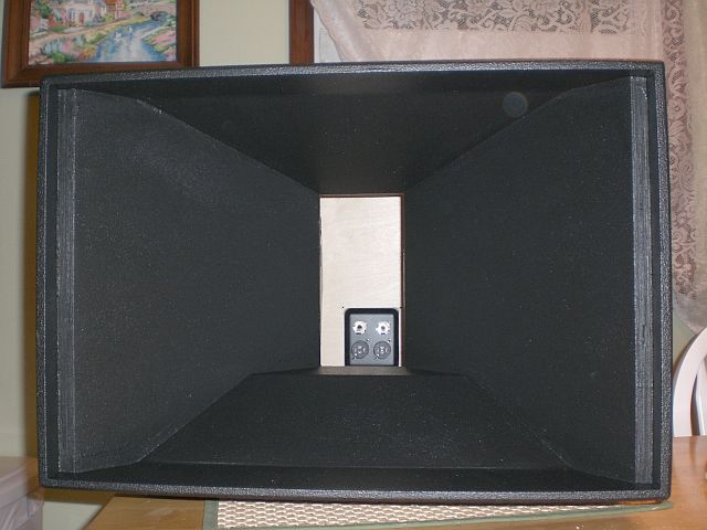

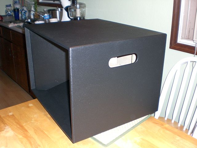

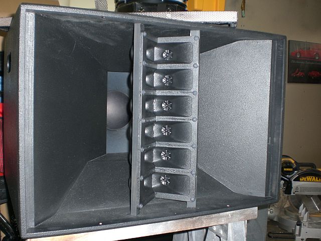

I finish my OT12's back in August 2008. Wanted to drop a line and pics after I done quite a few shows. I'm still amazed with their performance and clarity, as are so many others that hear them. After seeing them, our bass player said, "We need more speakers!" After hearing them at the first show we did, he said, "Wow, we don't need S&%T!" I spent about two weeks building, one week each. Just a couple hours a night. The plans were easy to follow. The pics really helped. I pole mount them on top of Tapco 18" subs. I plan to replace the subs with T48's.... when the economy and my wallet gets a boost. The Tapco's do great but I'm sure I'll quickly sell them after I build/hear some Titans. Thanks Bill, for making your great speaker designs available. So much better than the flat, boxy sound of the big brand names, at a way better price!

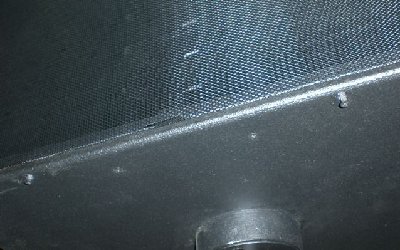

Hey Rickisan, Take a look at the top pic. You can see I stapled a small tab of screen cloth to the grill frame. Makes removing the grill a breeze. Might wanna add that if you haven't already.

Ok now I'm confused. Do the screws provide an interference friction type fit to the grill frame? It appears they are located in a position impossible to put a screwdriver on with the frame in place? Nice lookin' cabs by the way

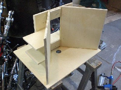

The screws are put in from the outside of the cabinet. They thread into the grill frame. Here's a pic. The other two pics are one's I've been meaning to take but never got around to until now.

Had to reduce the size of the pics. Here's the second try.
