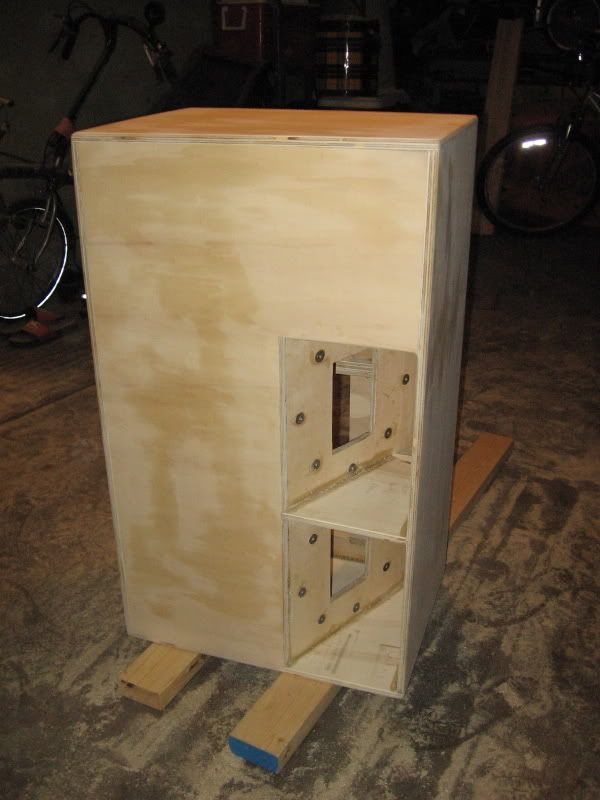

Today's update.
No router so I had to do it all by hand using my orbital sander. Broke a sweat but I think it looks pretty good overall. Painting tomorrow morning.
I'm kind of concerned with the insides of the horns. There's a lot of PL lining the joints and it's a PITA trying to get it out of there. I'm going to try painting it and see how that looks but if I'm not satisfied I'll probably build little grills and put petscreen covers over them. Actually I might do that anyway because I think it might look kind of cool. Any last minute suggestions for me on getting the insides of my horns looking good?
Here's the pix. The wood looks a little splotchy because I just wiped it down with a damp rag to get the sanding dust off.

- Posts: 28955
Re: Omni 12 2-10?...yup.
DuraTex.Rug wrote: Any last minute suggestions for me on getting the insides of my horns looking good?
LOL!Bill Fitzmaurice wrote:DuraTex.Rug wrote: Any last minute suggestions for me on getting the insides of my horns looking good?
I've got a gallon of the stuff. Think that'll be enough?
To get rid of the extra PL, get a chisel and run it along the joints. After you get the hang of it you'll find it peels off pretty readily.
If you leave it like that, put a coat of flat latex paint over the PL first. Duratex doesn't stick to PL very well.

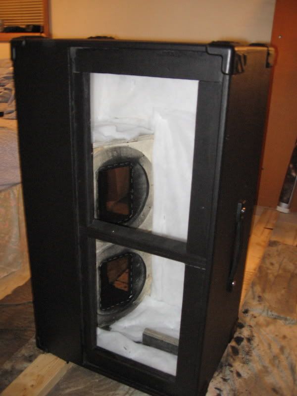

The construction is finished. Wiring up the crossover and speakers tonight. Woo Hoo!
Looks nice and neat Rug! Good Job!
