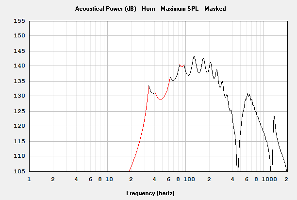

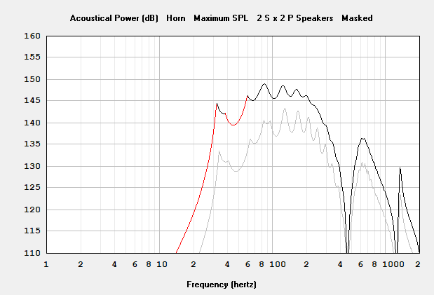

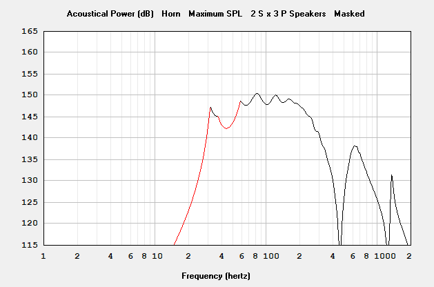

This would be your driver, single cab, 1w/1m sensitivity on a 24" wide
Screenshot 2026-02-12 162439.png (9 KiB) Viewed 38 times
Max SPL single Cab

Max SPL 4 vs single:
Screenshot 2026-02-12 162705.png (11.04 KiB) Viewed 38 times
Max SPL 6
Screenshot 2026-02-12 162807.png (9.91 KiB) Viewed 38 times

The dent at 44 Hz is limited by diaphragm displacement.
Coupling with a V-Plate not included.
I hope that helps; not sure if my simulating is absolutely correct; see the other thread.
