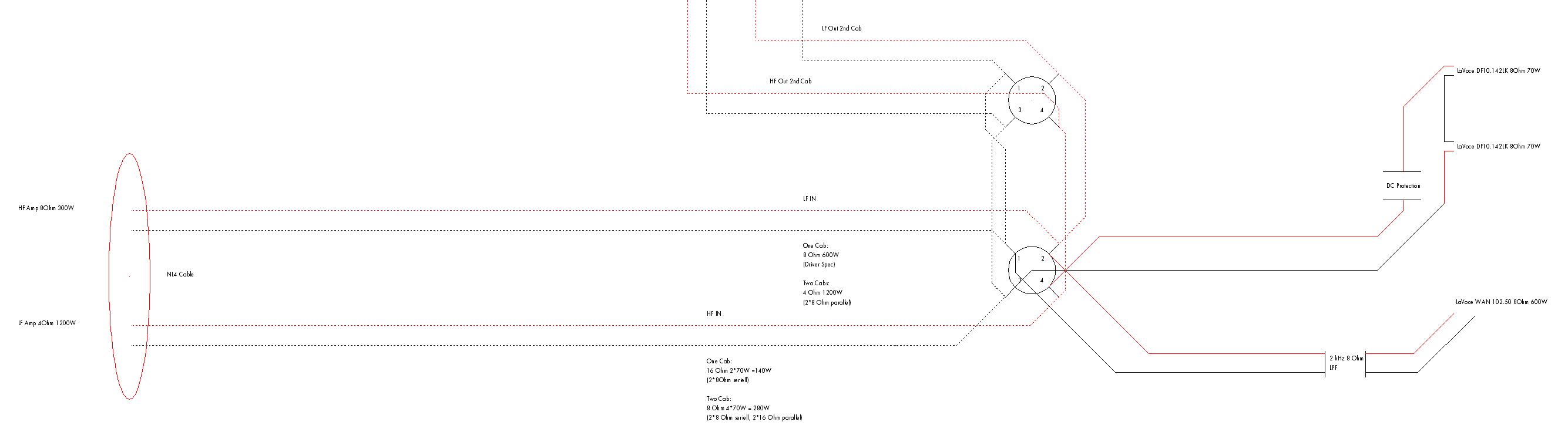

As the glue sets, i redrew the wiring, one connector NL4 with a patchbay in the rack to get both amp channels together in that cable.

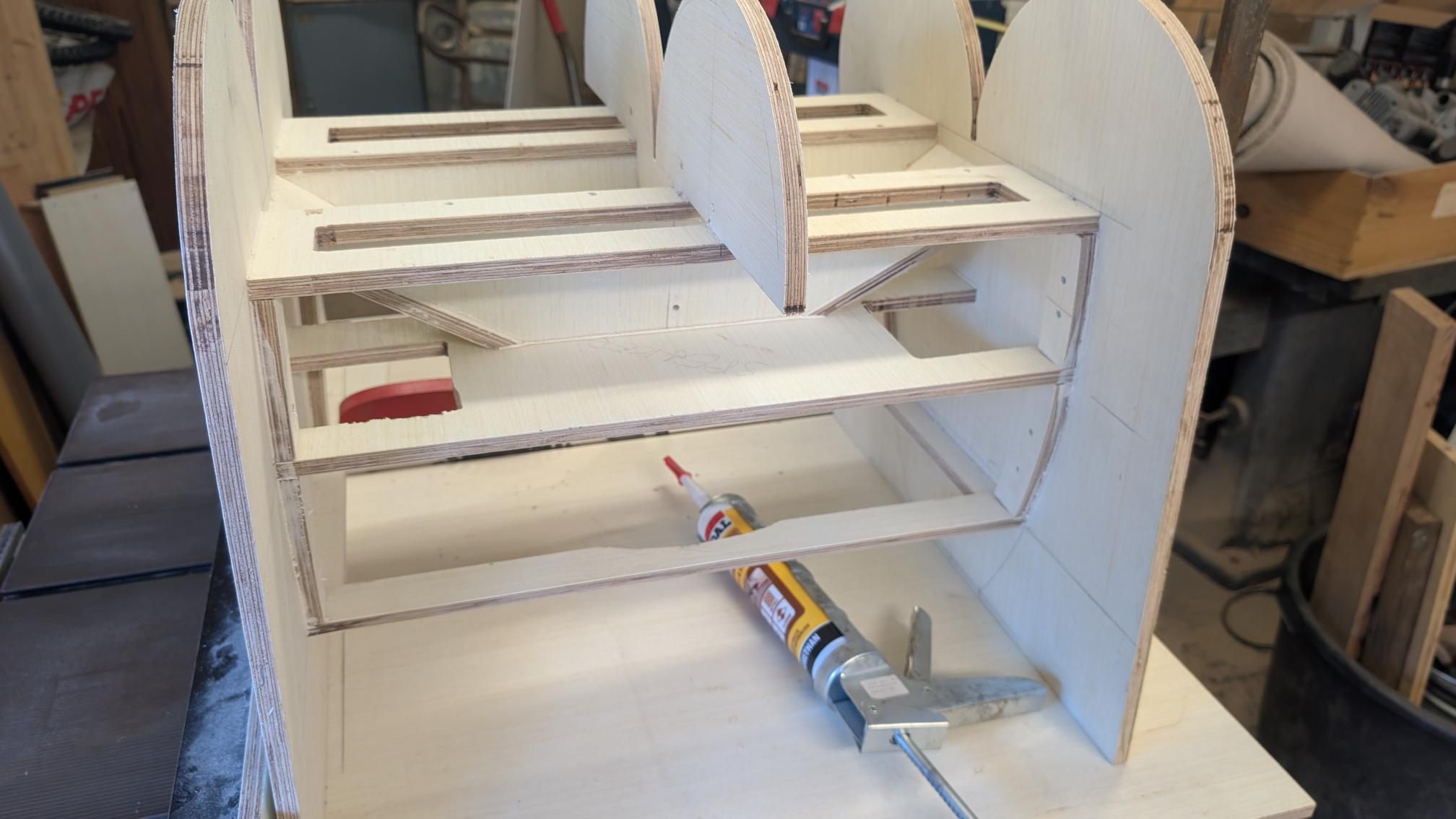

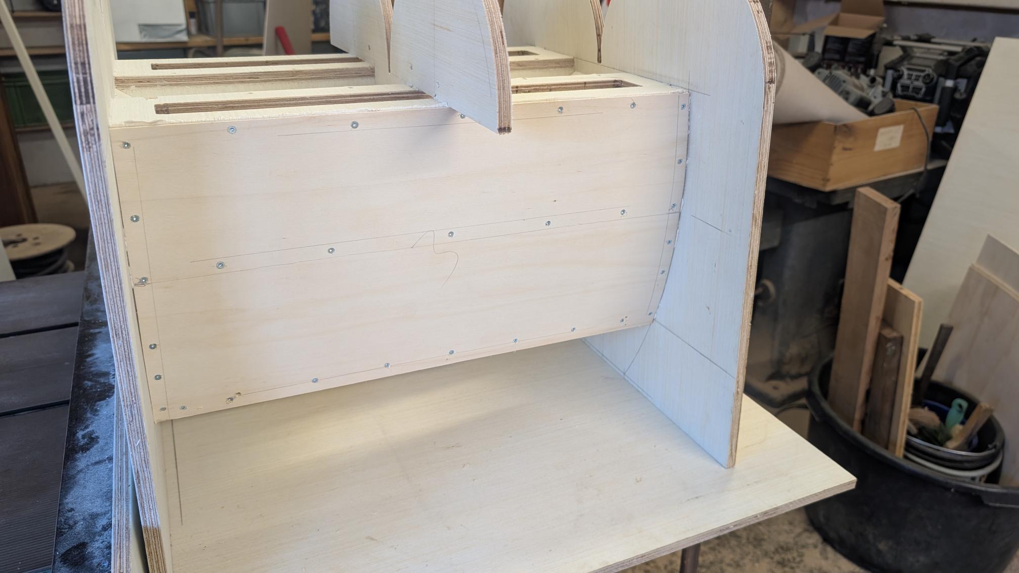

Back to the DRs, got a bit further and have the inner section cleaned up, braces on top/&bottom (made from scraps, only one edge important so i took what was in the pile of cutoffs) and the inner horn sides are on it :)
Screws held surprisingly well, no rip throughs (just one missed target, but thats not the screw's fault)
Ready to glue; so far about half a cartridge used. I assumed it would be more.
screwed in place, ready to set :)
(Soon I'm going to invest in a powered press for the glue, esp when cold the constant pressing hurts the fingers. The long lines to glue are still to come...)
Nice continuous squishout all around the edges, i think it will be airtight :)
And again the glue has time to set. Wetted it intentionally this time, will see how that improves the curing.
When set, i can start partying on both ends; adding the back part of the horn and start with the HF-module :))
If i manage to keep the few hours daily on that, it'll probably be finished in the first week of the new year :))

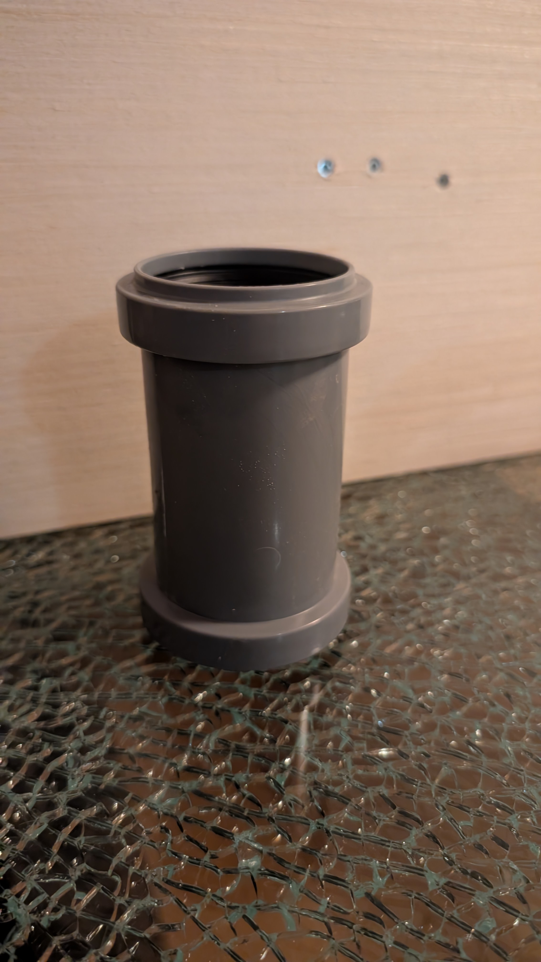

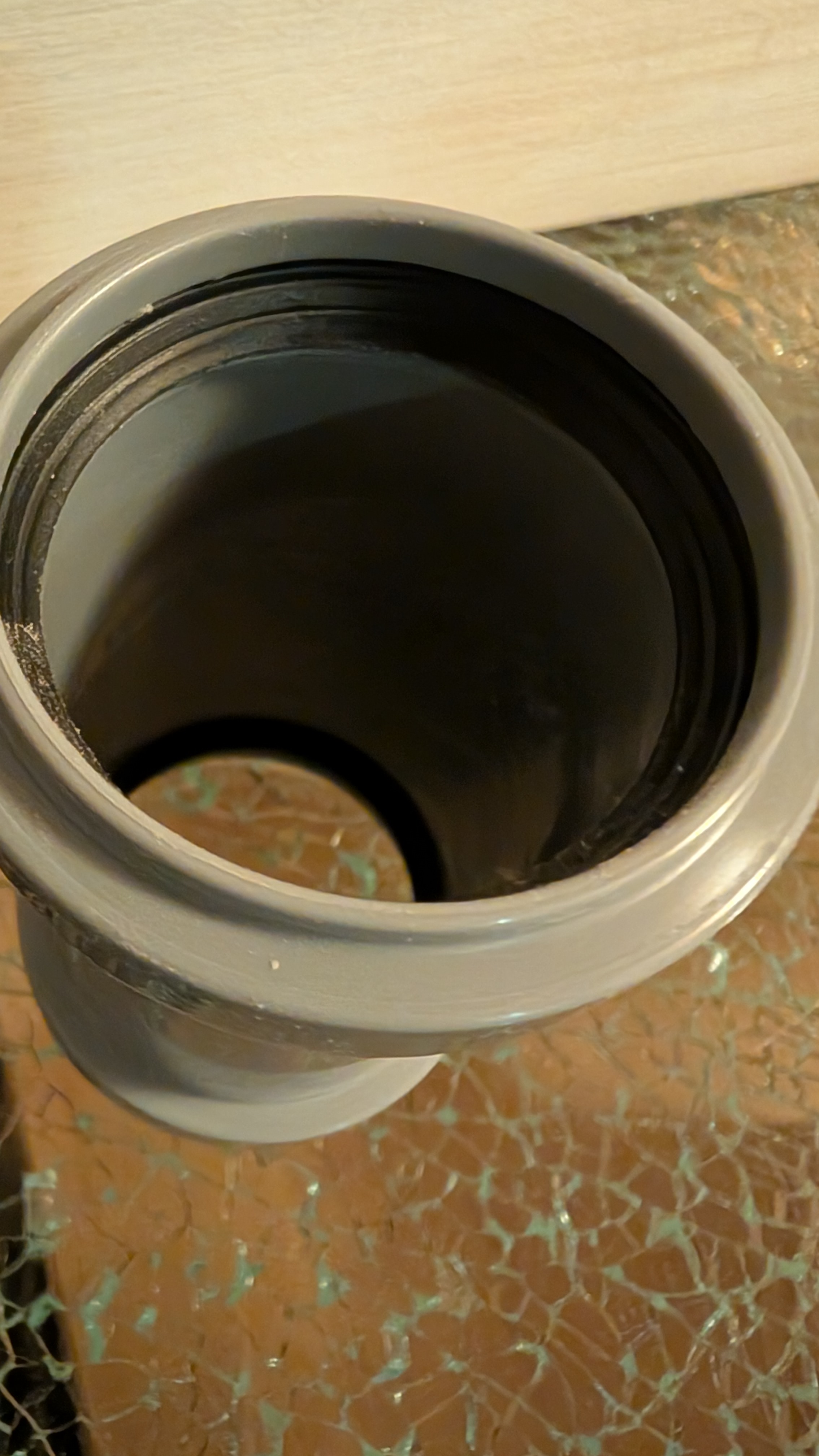

Another question came up, regarding the ports:
I'm on to doing the versatile option with a coupler. But I'm not sure, from where to measure, and how to place.
Iirc, i think I've seen that variant in one of the build threads here, the wider "Ring" on the outer edgne from the coupler sitting on the horn sheath.
Or should i go for the middle-part of the coupler without that ring and just glue it flush?
And when the Ring is included (and part of the structure in terms of stability); the length is measured from the horn sheath surface, or the outer edge of the coupler?
Any hints on that? Would be very happy to not be that stupid.

And pictures from the coupler to visualize my last question:
