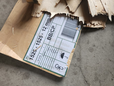

I found attached Baltic Birch rated bbcp this looks the exactly what the build calls for.. somebody confirmed for me?

Probably OK, it has one good face and one not as good. There's no reason to have two good faces.
