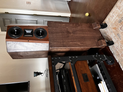

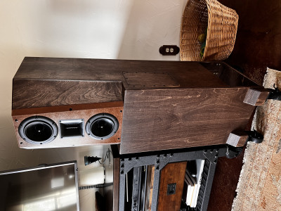

Pictures of finished Davids
Posts: 7687
Re: David build question. Front panel cut out?
#7 Post by Tom Smit »
Great job! :clap:
How do they sound?
Ray
Posts: 6
Joined: Mon Jun 02, 2014 9:19 pm
#8 Post by Ray »
They sound amazing, very detailed but not harsh. In am using GR research m130 midrange, Radian planar ribbon tweeter and a Tang Band W8-740P subwoofer. For the crossover I a use Sublime Acoustics K231 active crossover at 80 hz and 3K hz. At 200 hz I was getting a loud room mode at 120 hz. I want to try try a 100 hz crossover but have not order that board yet.
