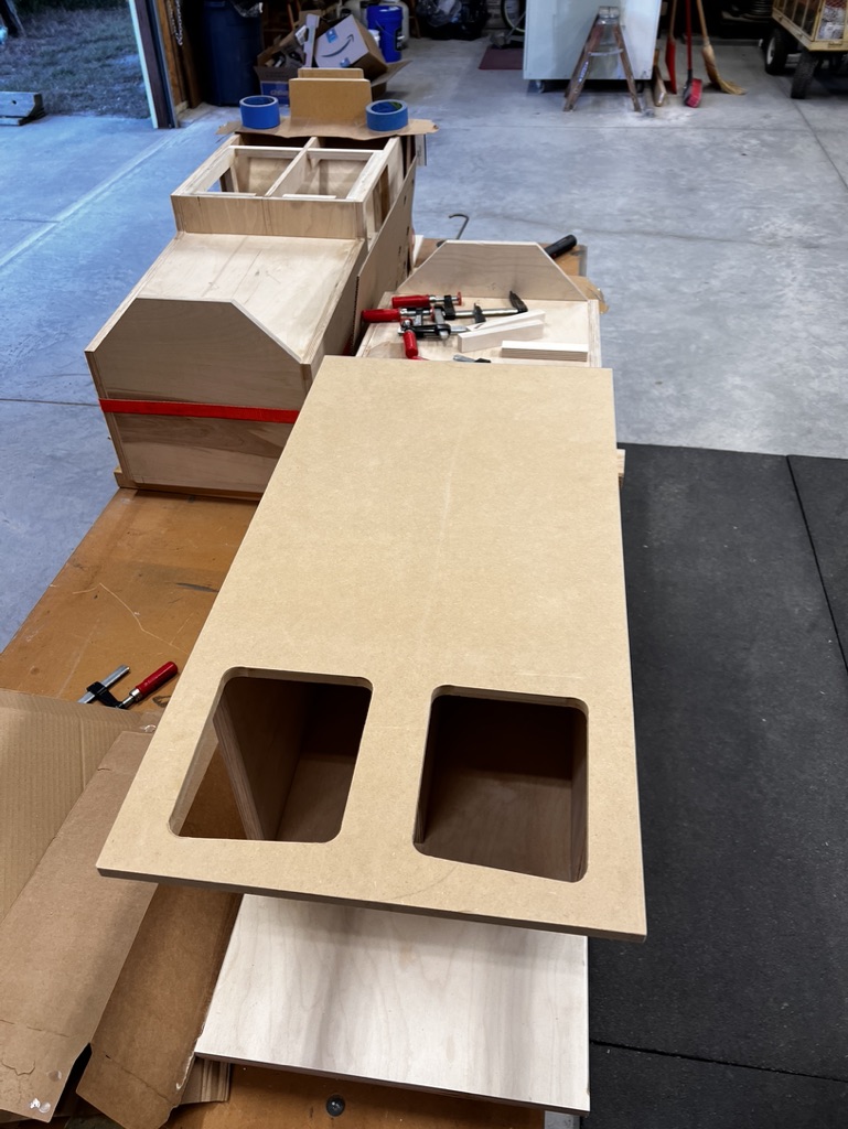

At the bottom of the front panel (panel 11), would it have a negative effect on the horn section if had cut out that are shaped after driver access covers? All the exterior panels are made with 18mm BB. I had 18mm BB for about 7 years and was starting to get weathered so I used before it got to far gone. I have a picture of what I am thinking, but sure how to and to this post.

That would make the horn mouth opening too large.

Ok, thank you Bill. I was just thinking about that for looks.

make some faux grills

I was thinking of doing that.
