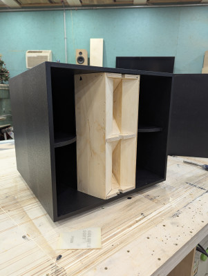

#17 Post by KentWhitten »

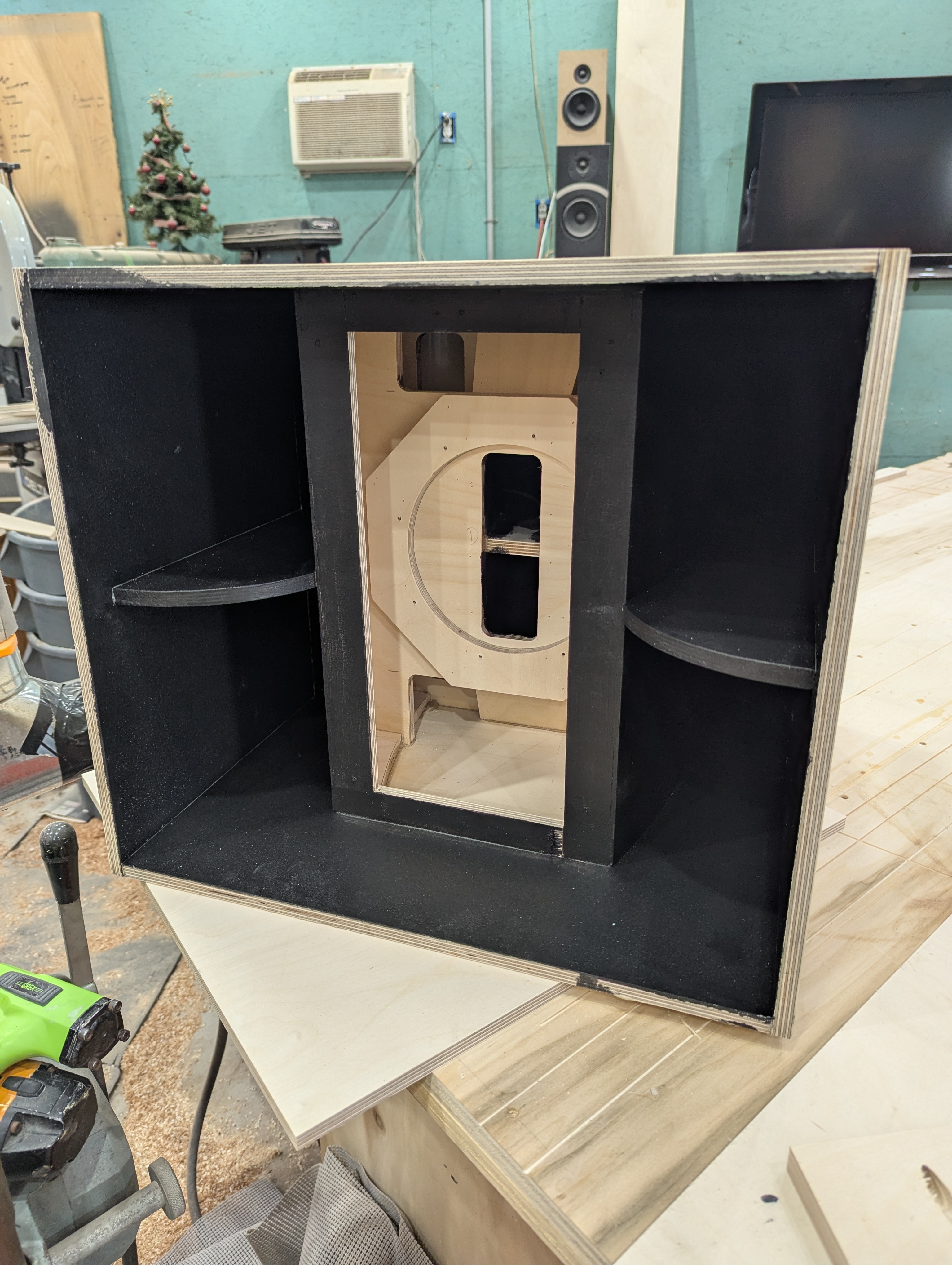

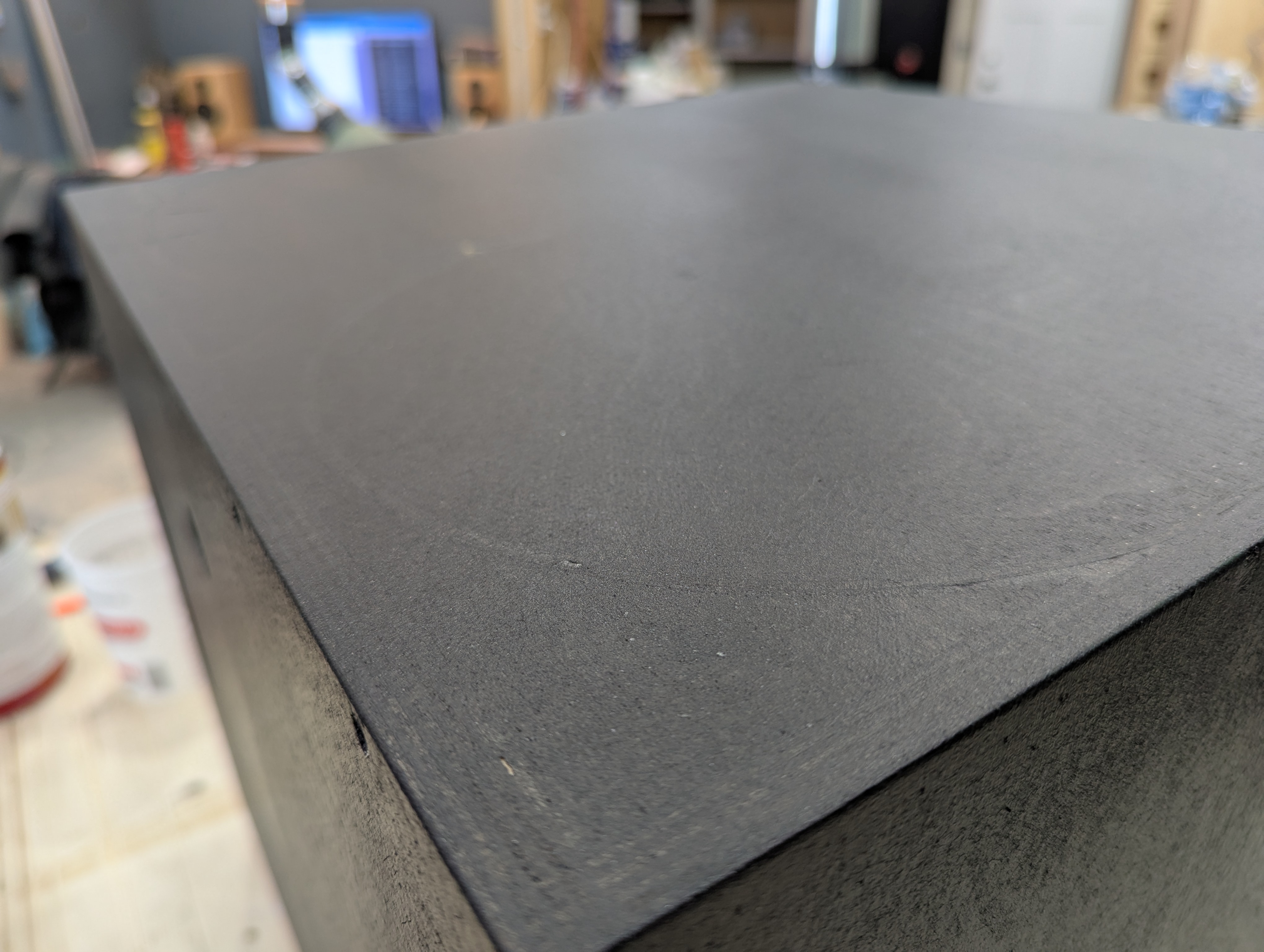

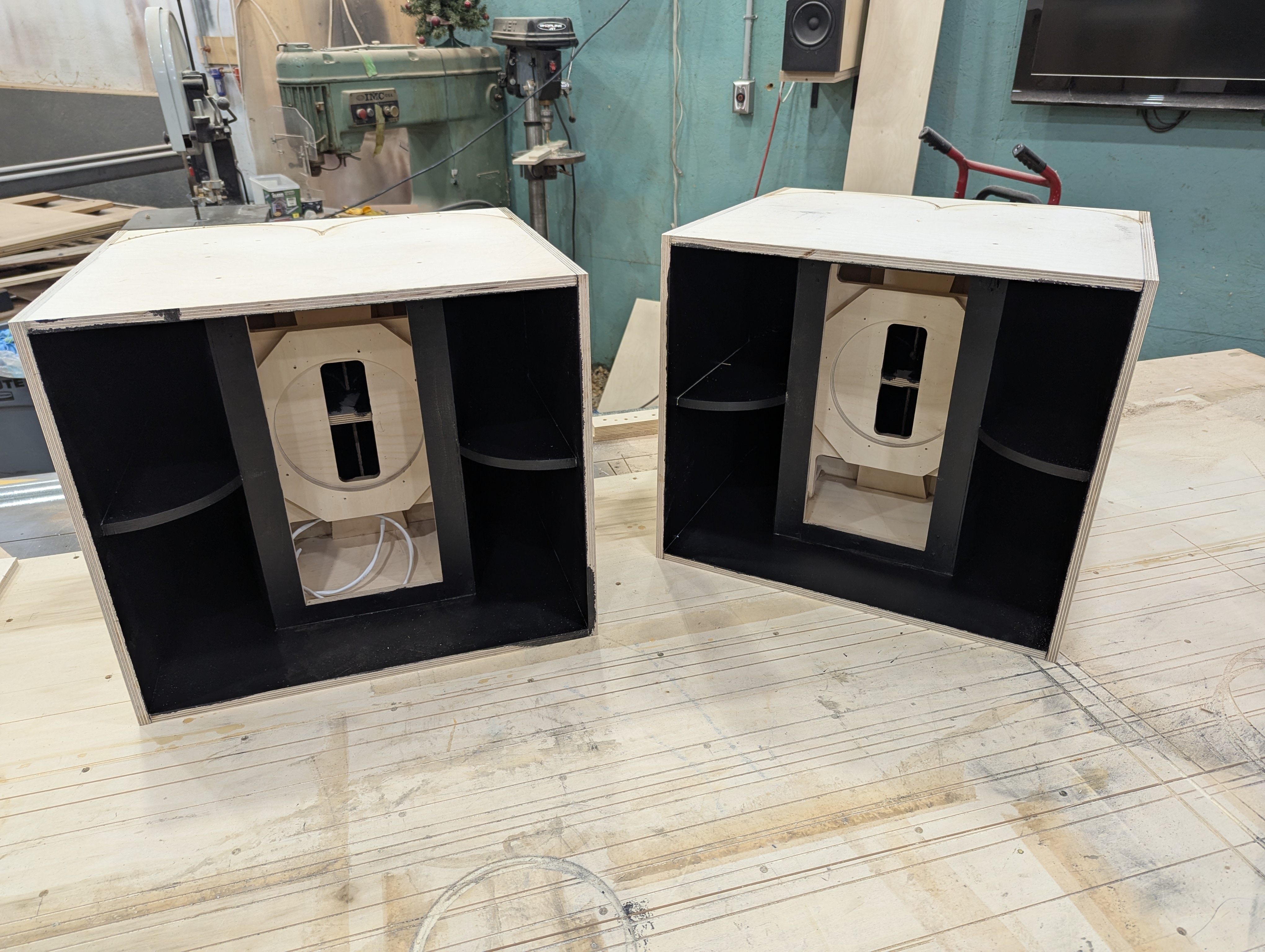

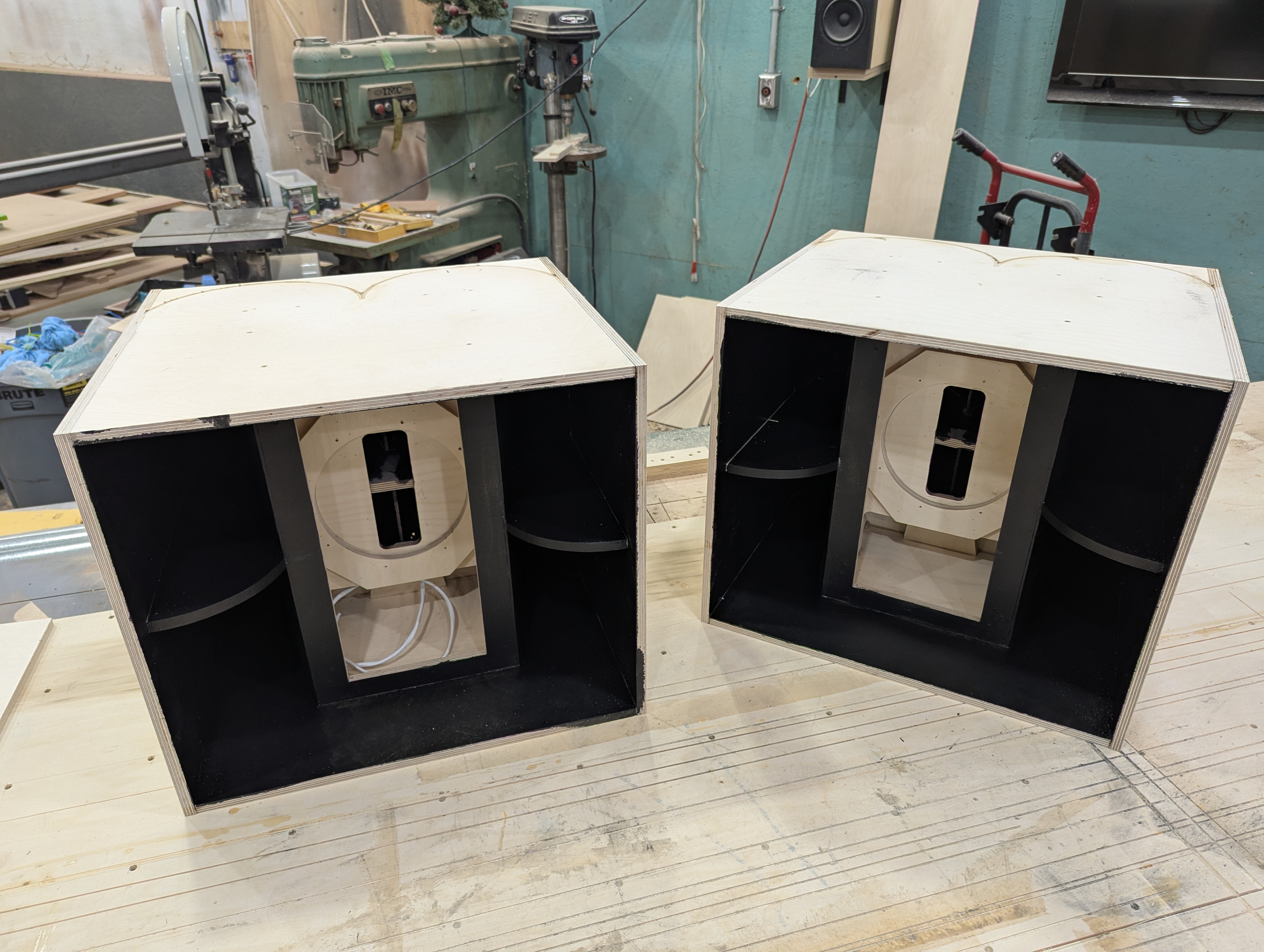

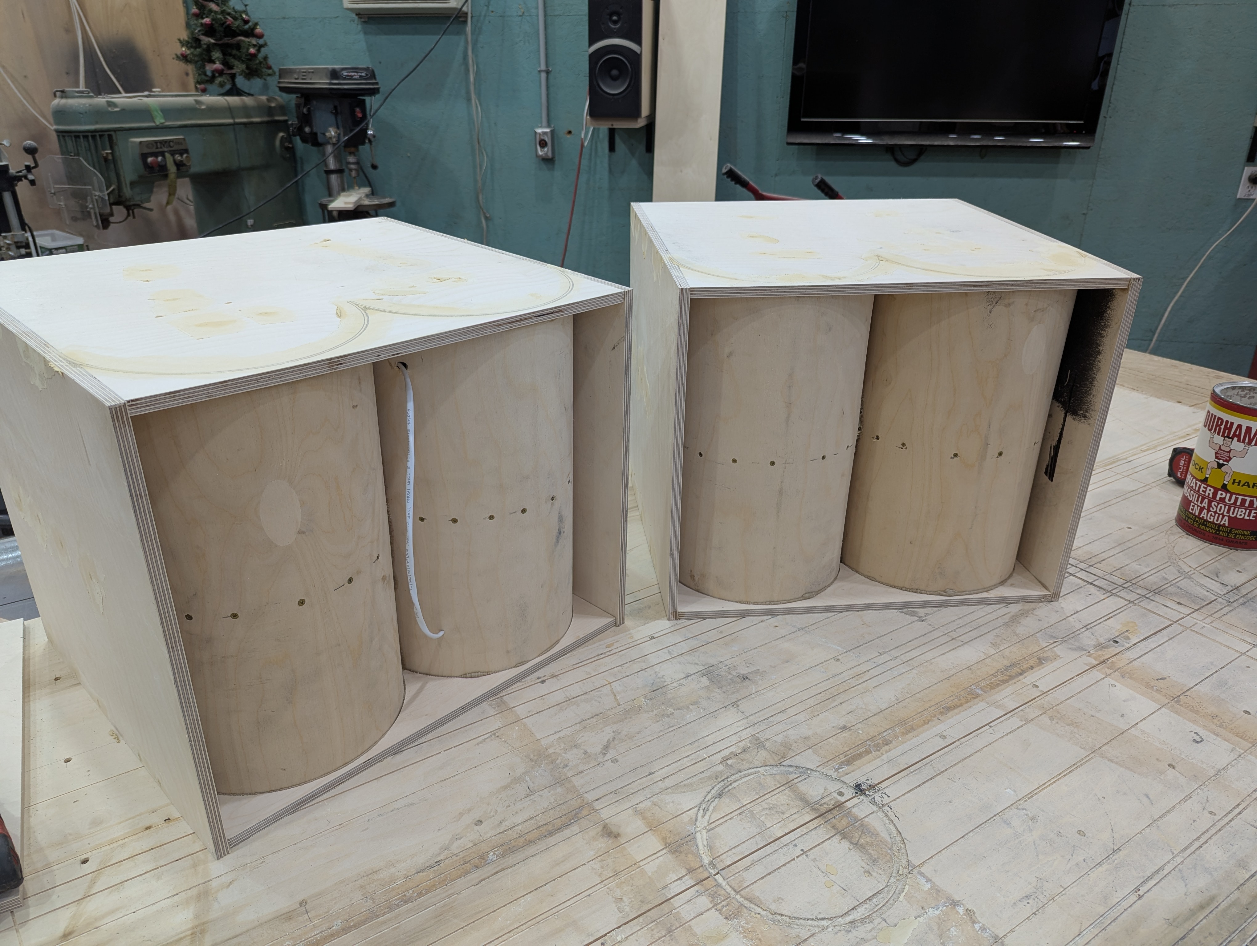

Finally got everything on the inside pre-painted and the sides are on. You can see that I went with the option to use the cutouts from the top and bottom "boob" half round pieces for a lack of better term. I was honestly quite surprised as to how well they came out. I fully expected a large hump where everything meets up, but was pleasantly surprised.
The pair of them all wired up through the back side and durhams wood putty filler

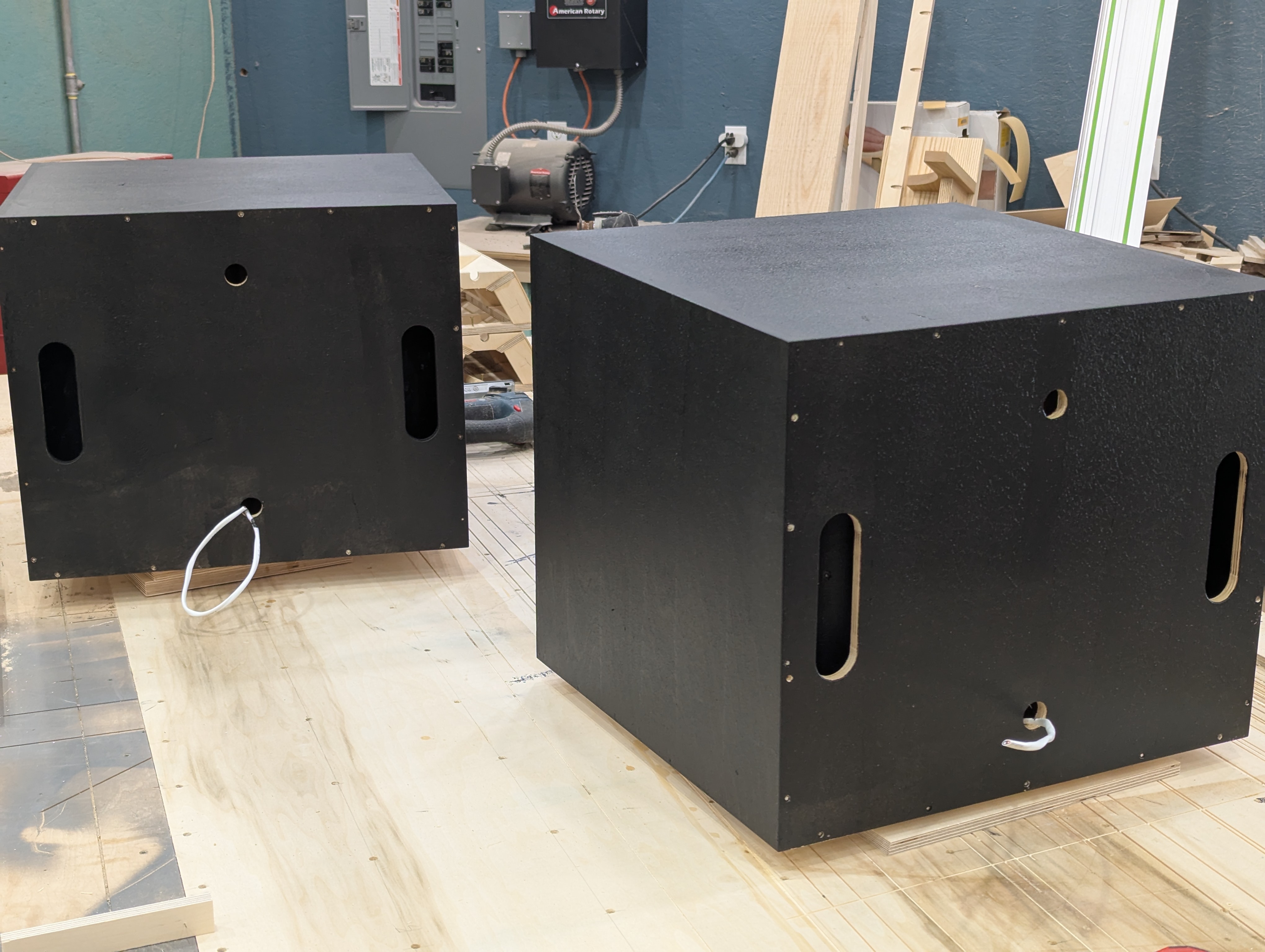

Back was prepped with hand holds and speakon holes, installed, trimmed, glued and screwed on the back panel. One thing I regret was not taking the time to figure out how to recess those speakons quickly and easily. After I mucked it up, I found out how to do it . Oh well, there's always next time.

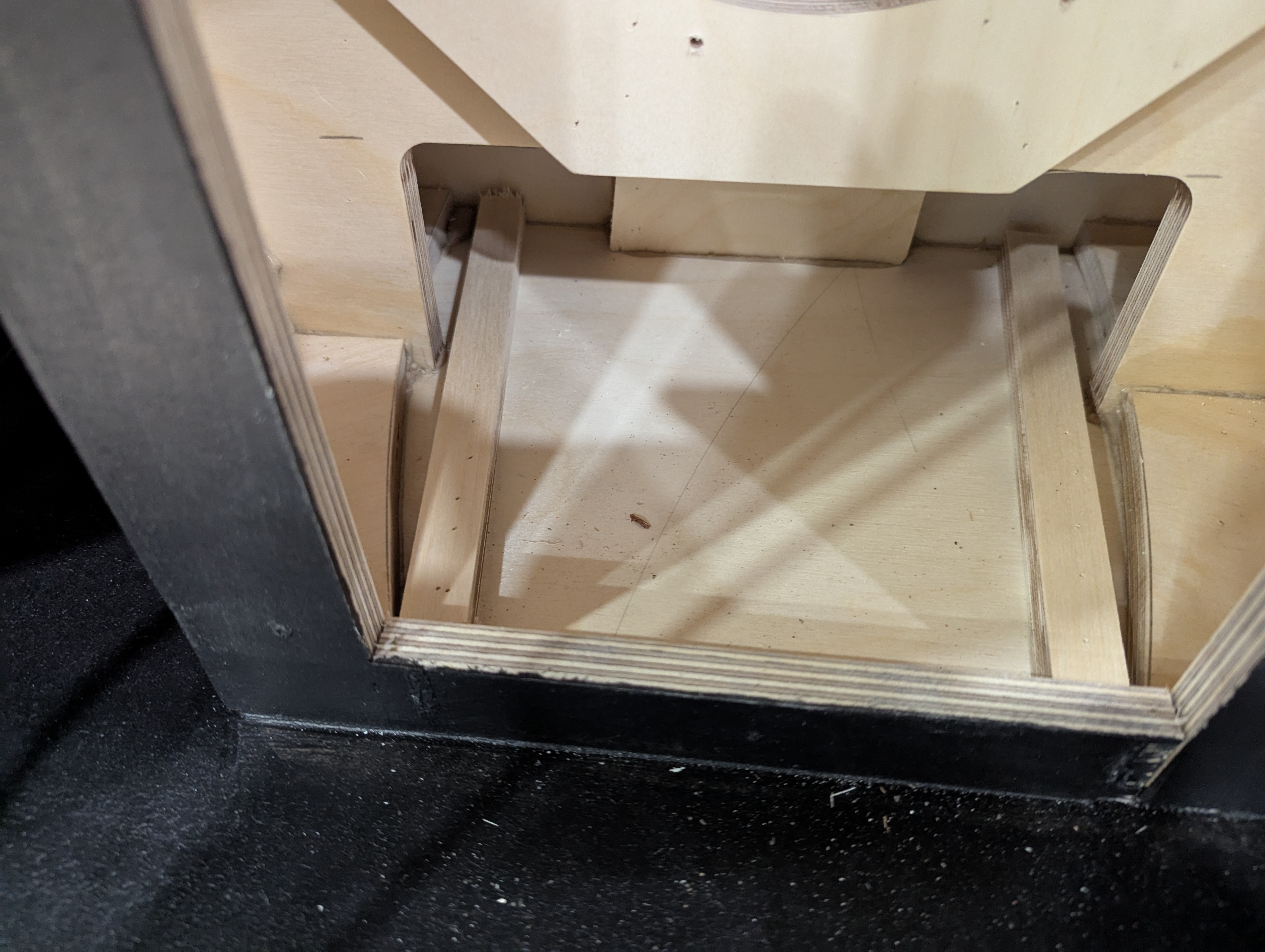

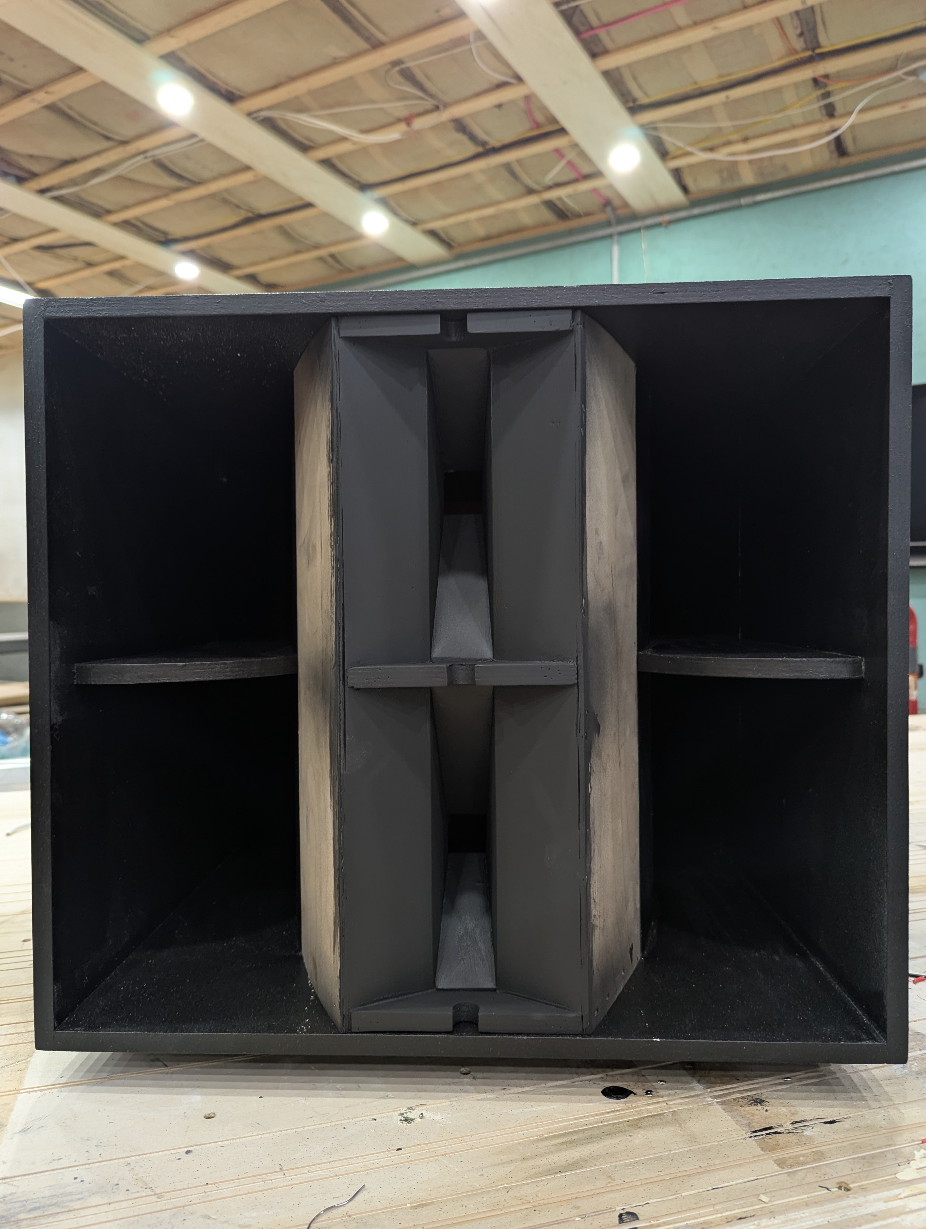

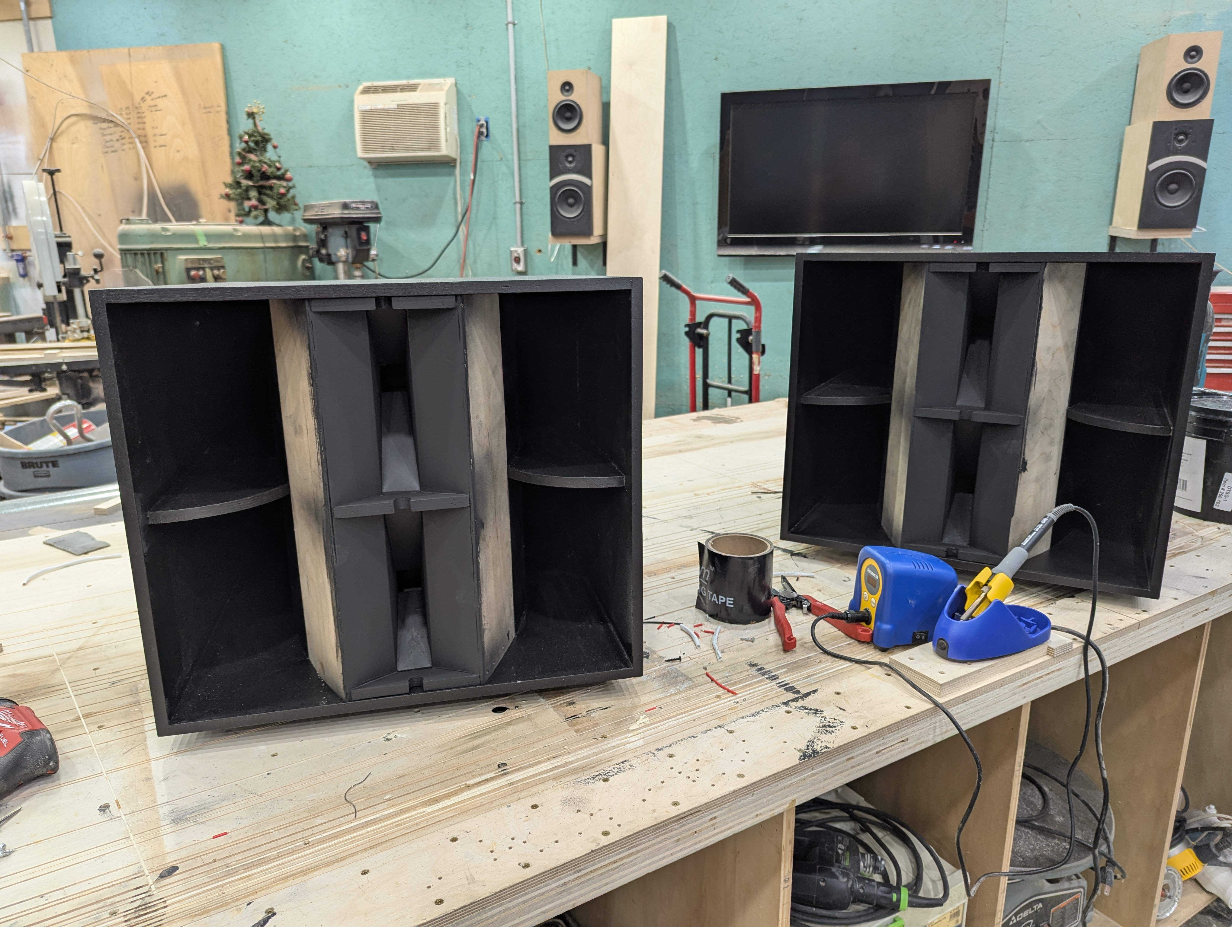

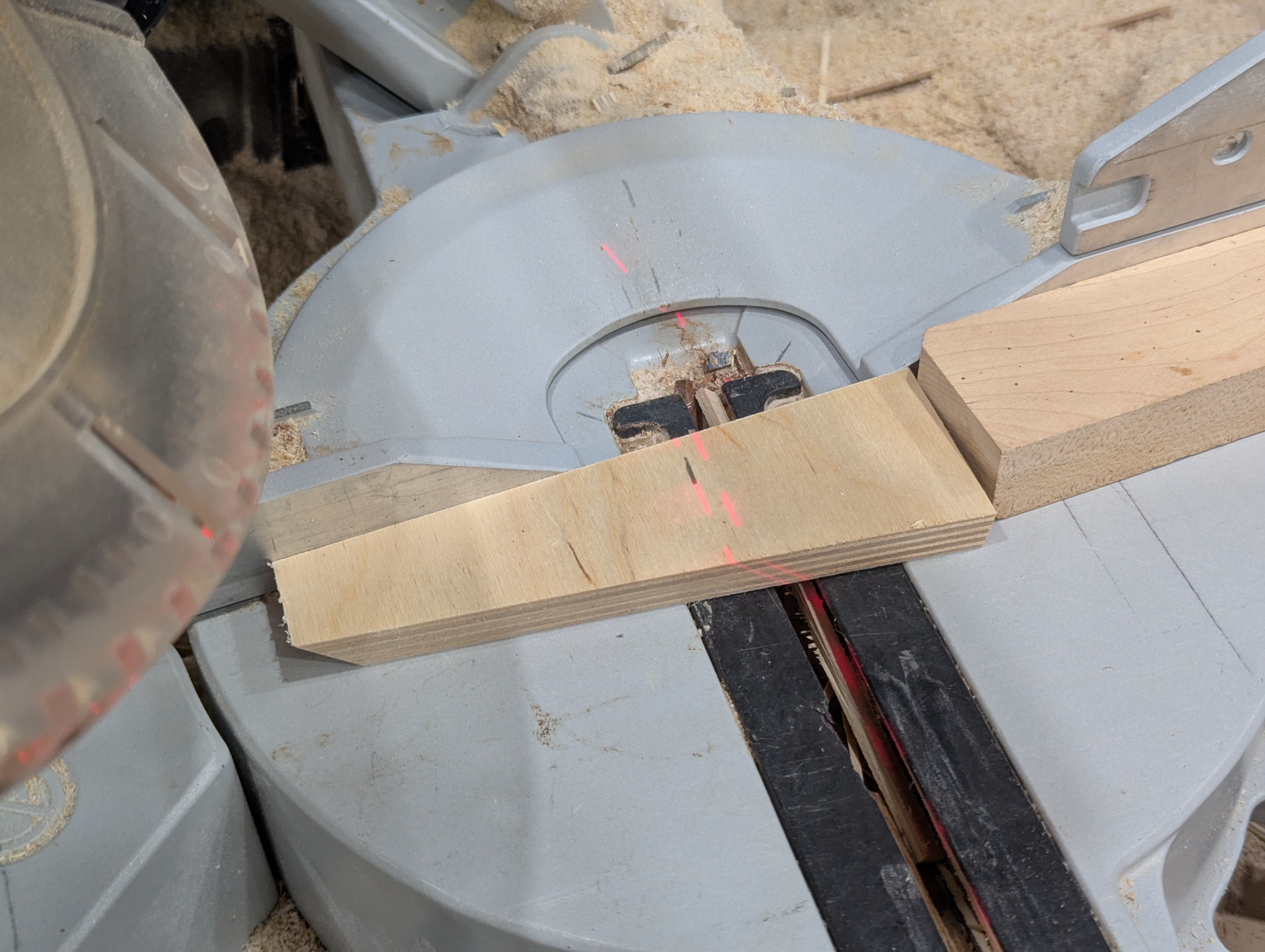

I didn't get many pictures from this point on. I was rushing to the end, but I did still manage to get some final shots. For the throat pieces, I was able to do everything right on my miter saw. Made quick work of things
Decided to spray the throat plate black instead of brushing things on. It's not the best method. So hard to sand those pieces after they are in place. Also, started getting my soldering equipment out, as the crossover is the next step.

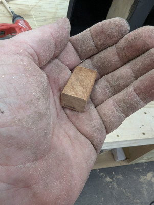

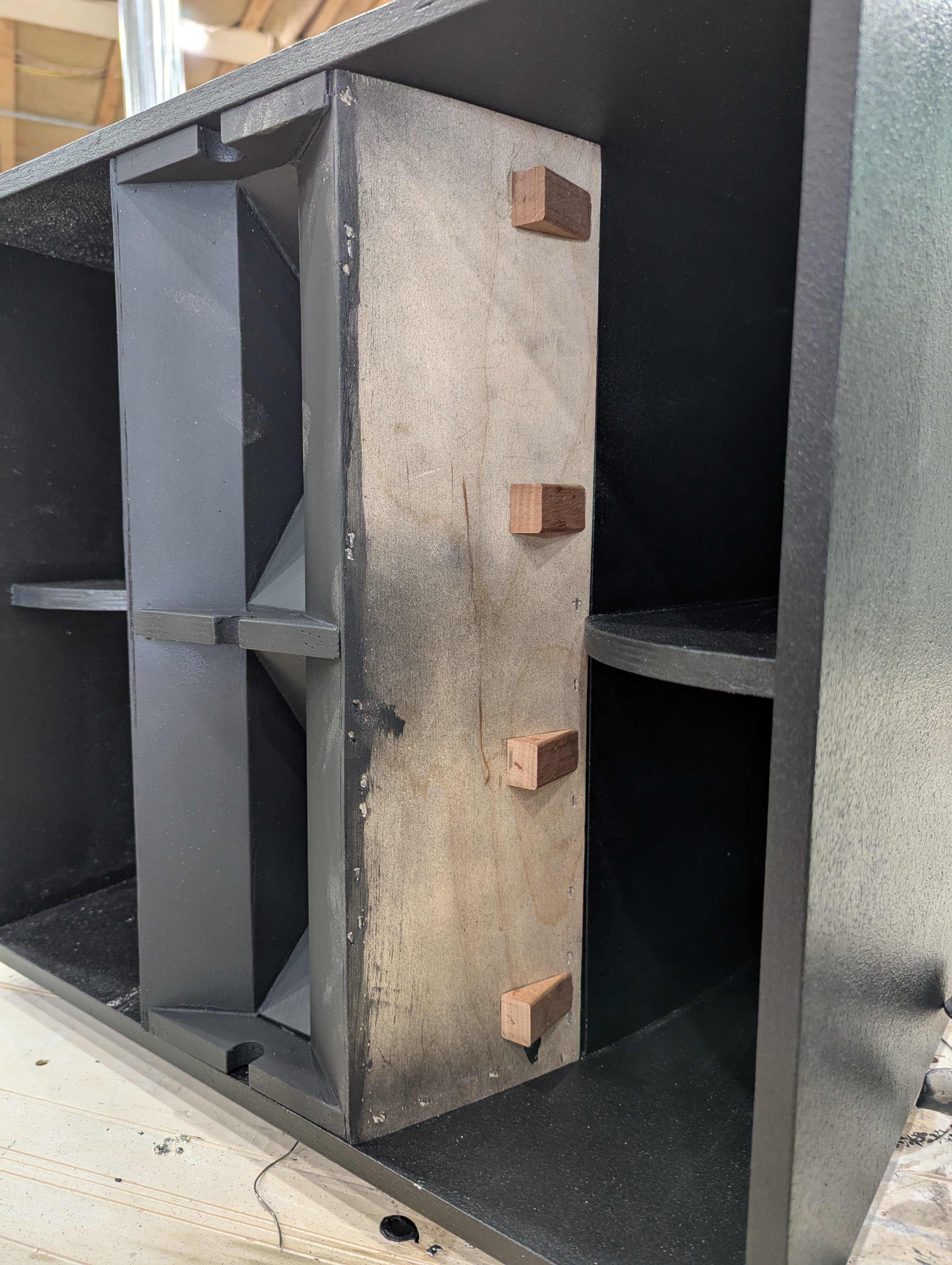

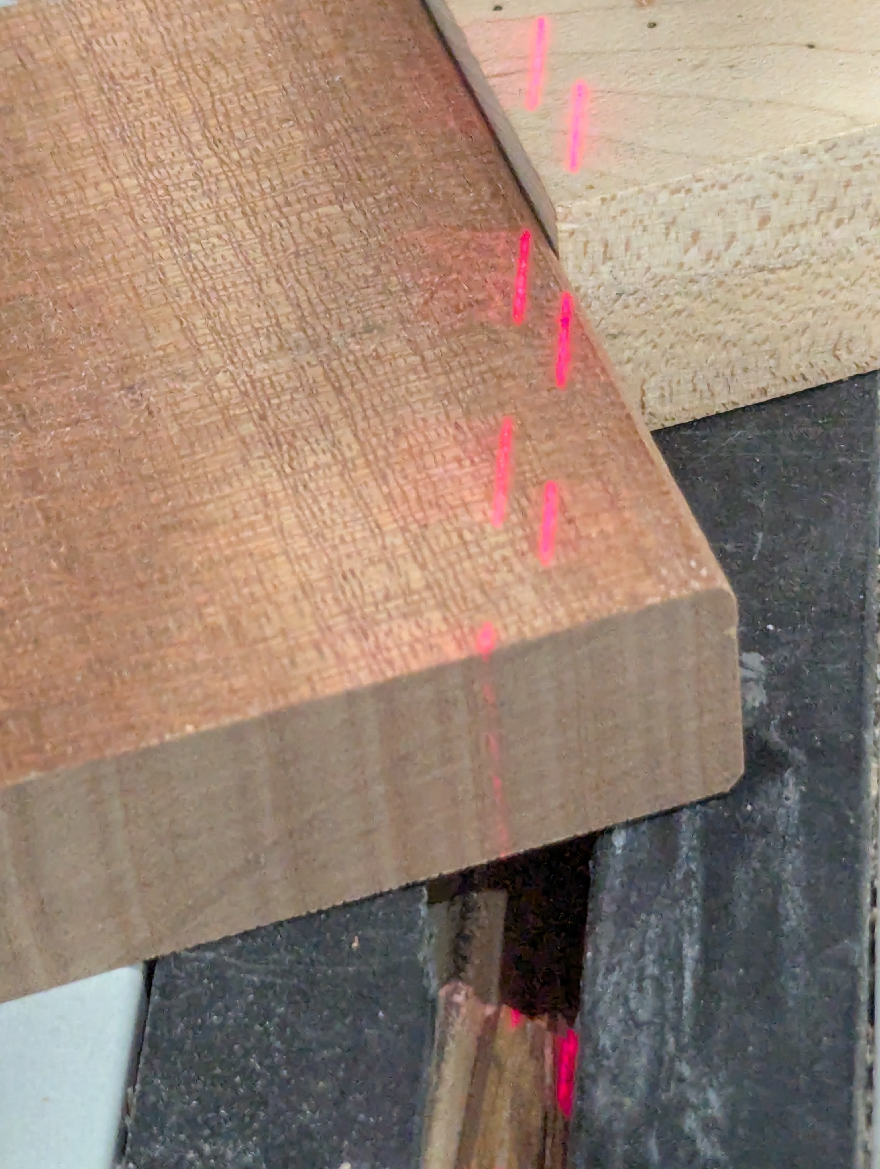

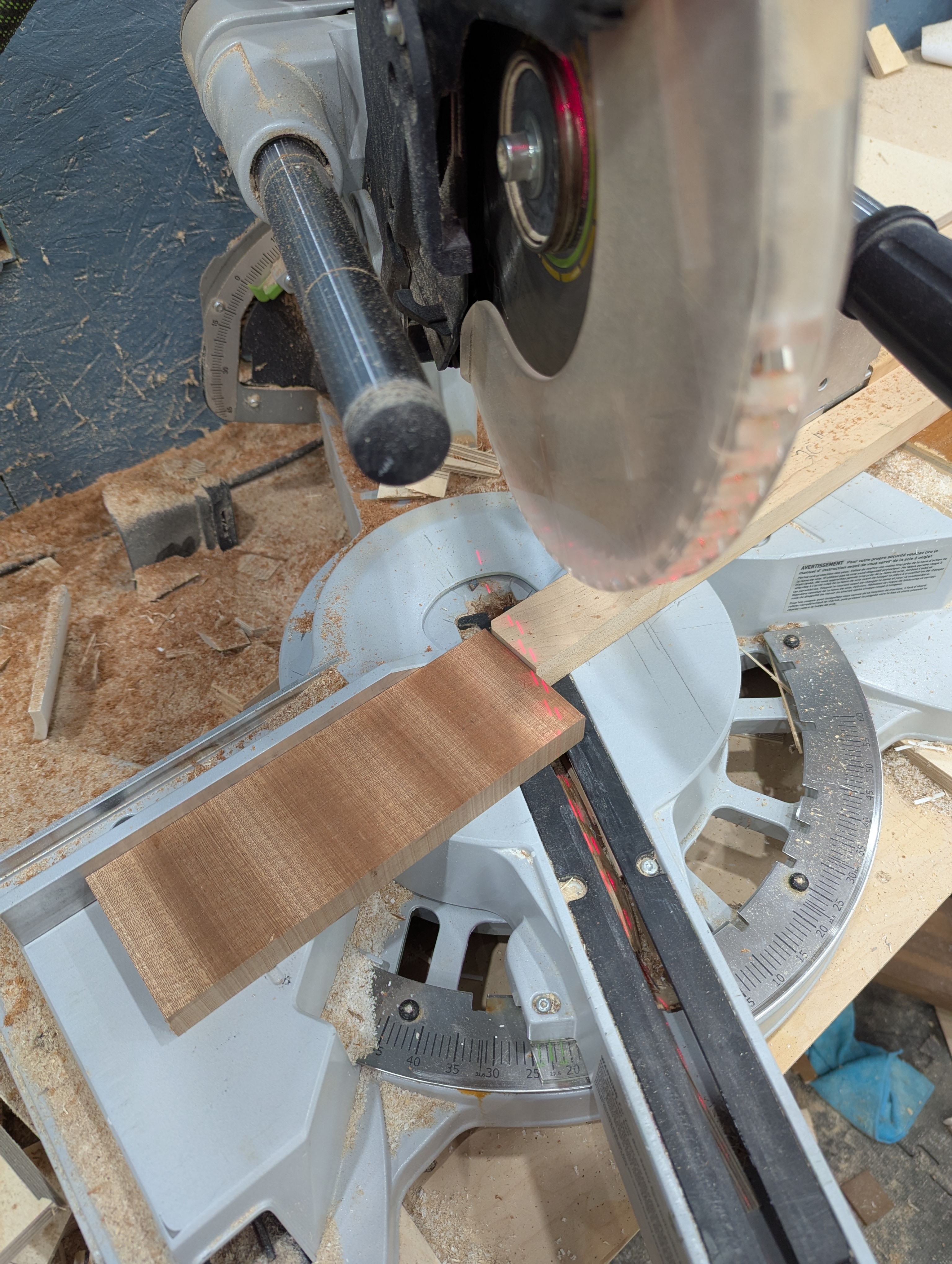

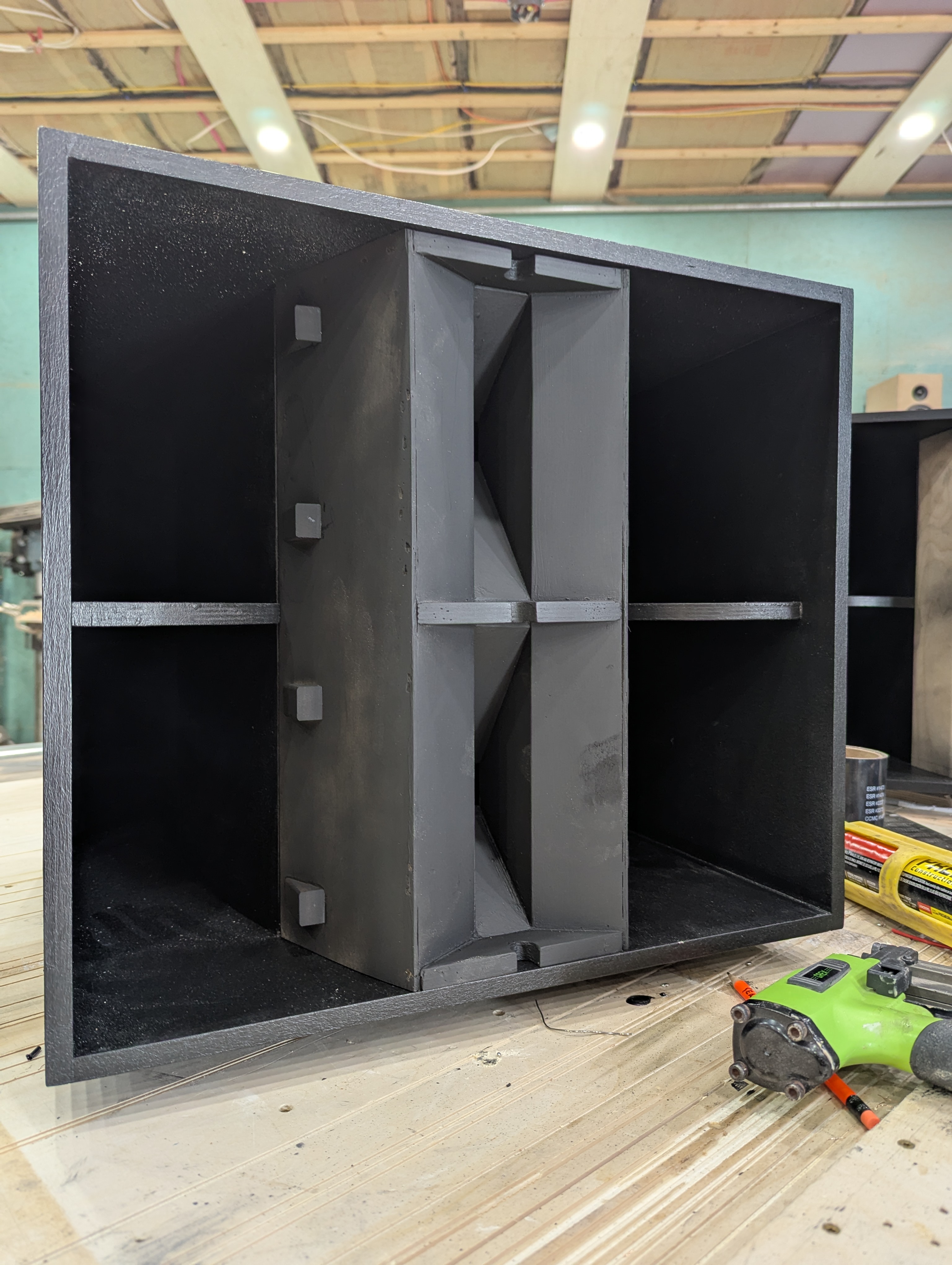

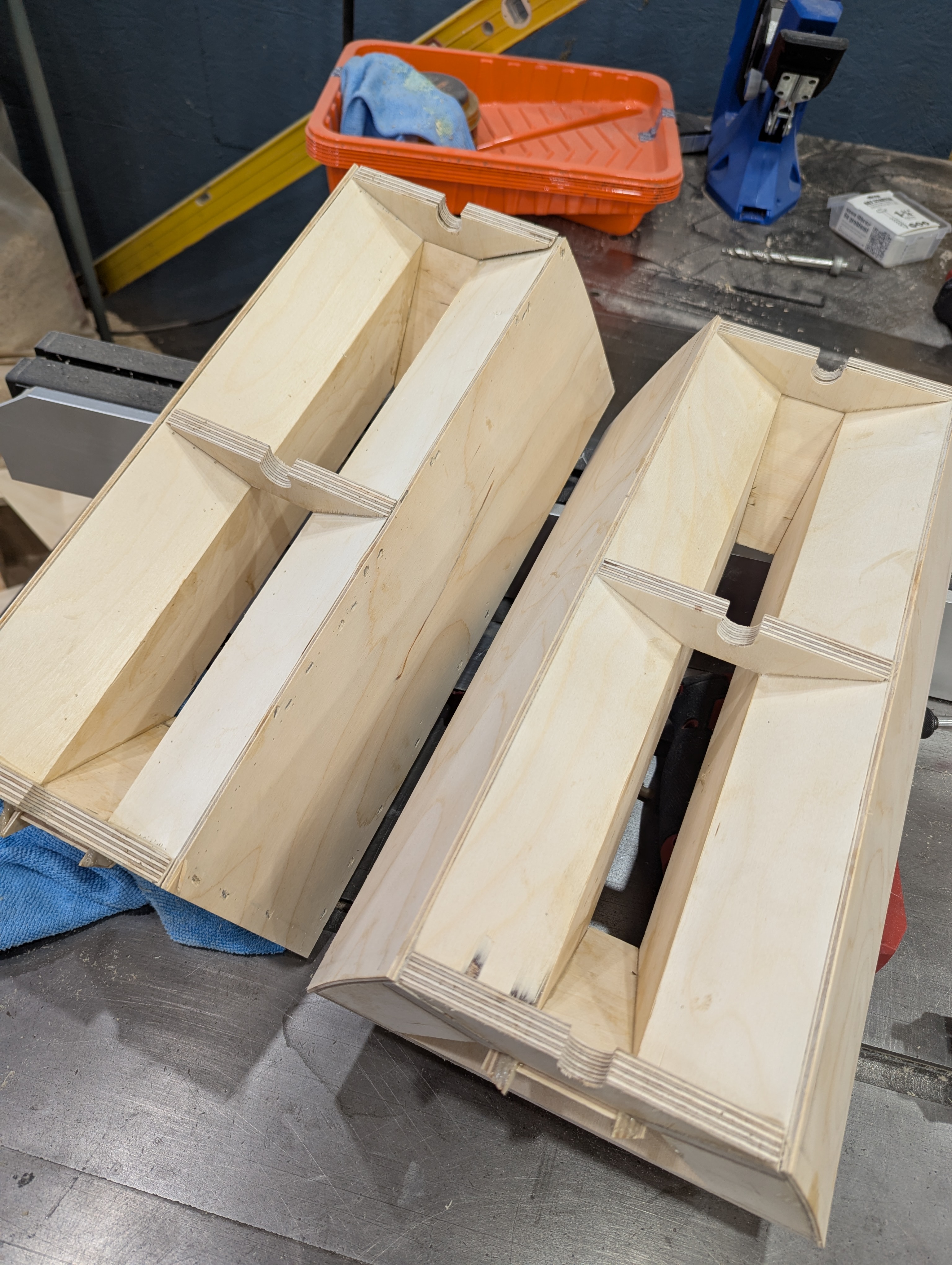

Time for nacelles. I made easy work of these on the miter saw again. Set up a stop and cut on the angle. Again, short on the pictures to show exactly what I did. Made from scrap Utile quarter sawn Utile
I was able to use a 23 gauge pinner to nail them on while the PL glue set. I offset where I placed the pins so I wouldn't drill into them

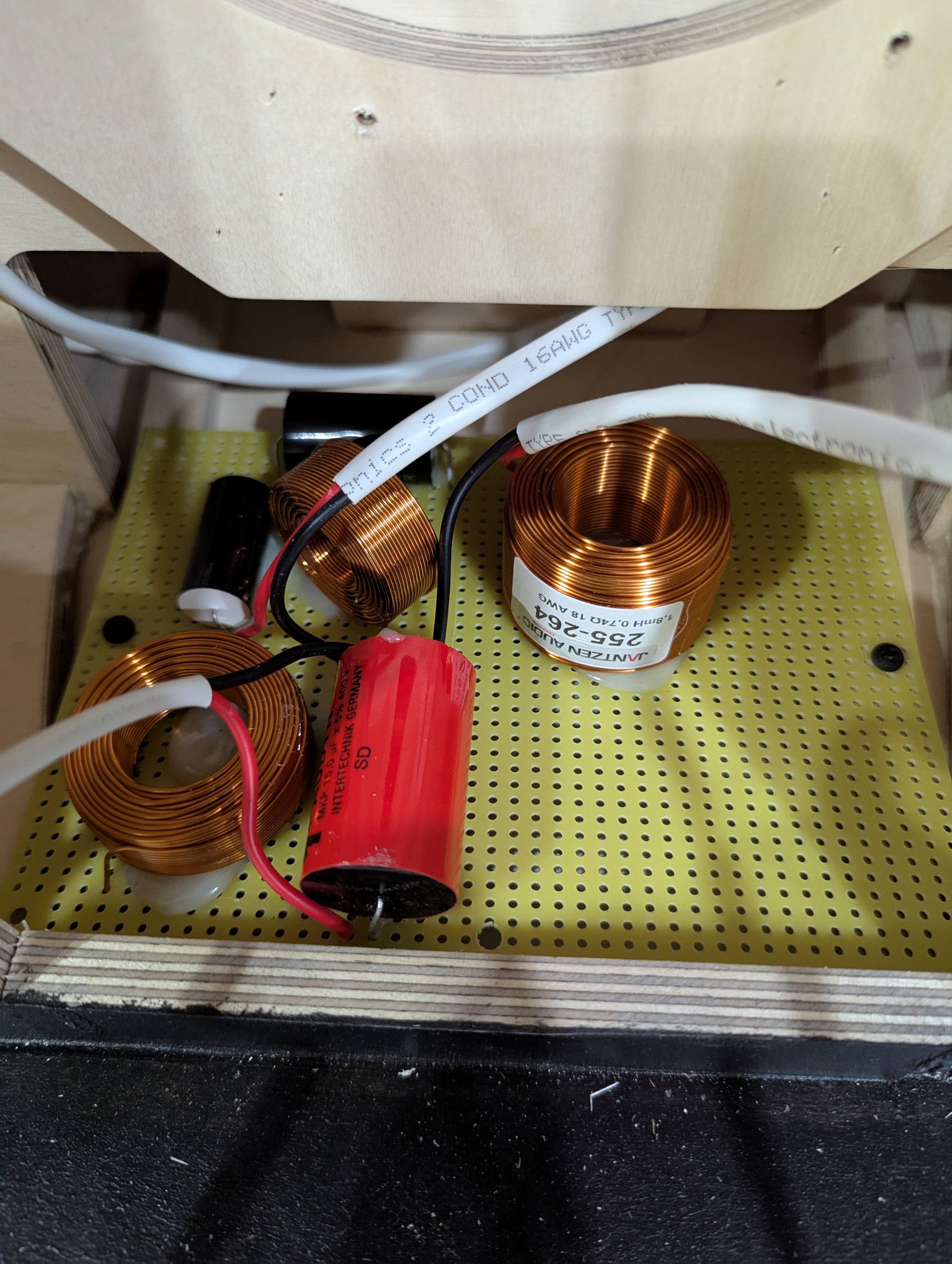

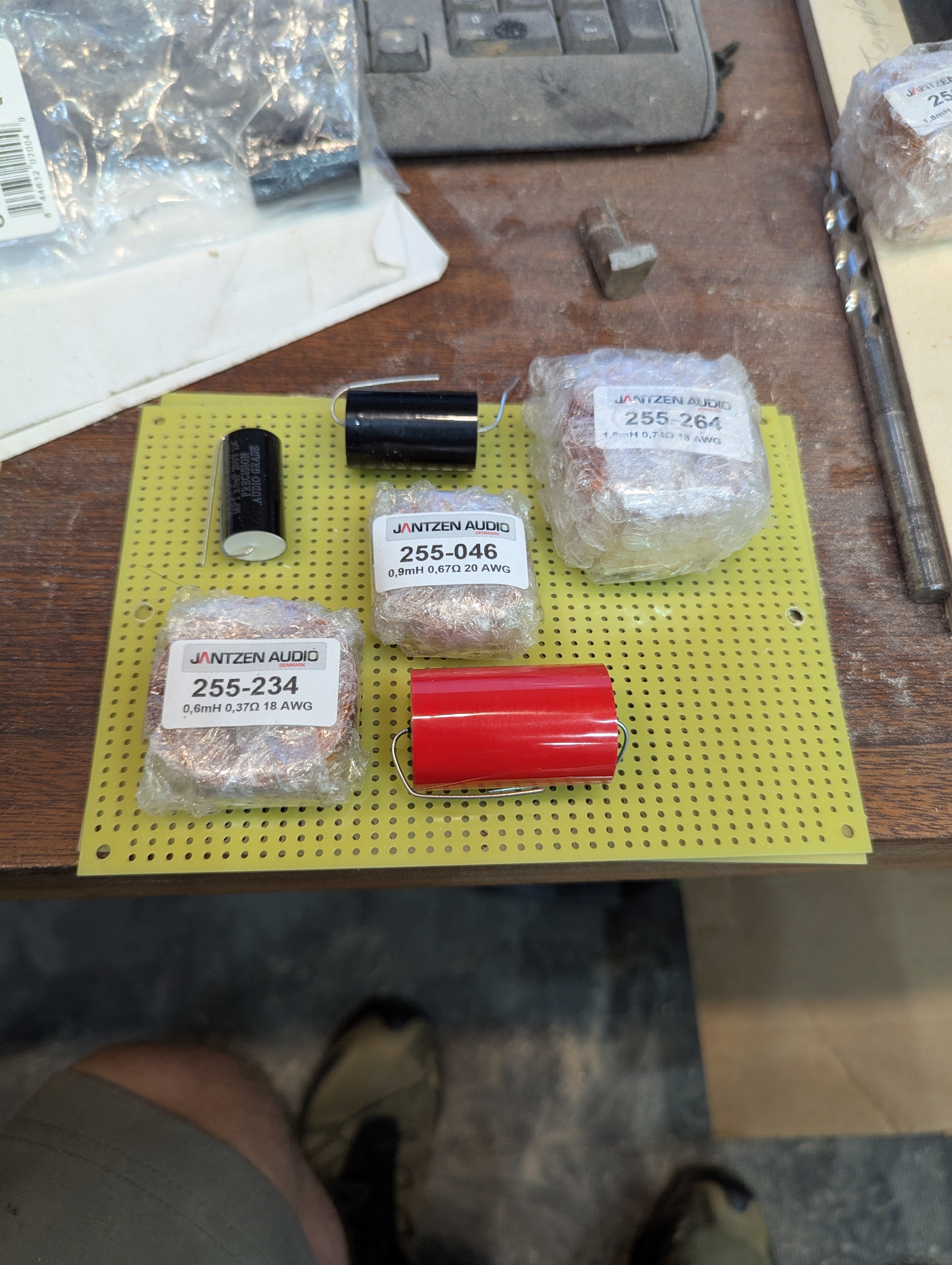

For my crossover, I put everything on one board just to make it simple for me. I know that might not be the best method having all those parts close together, but I've never had problems with my crossovers.

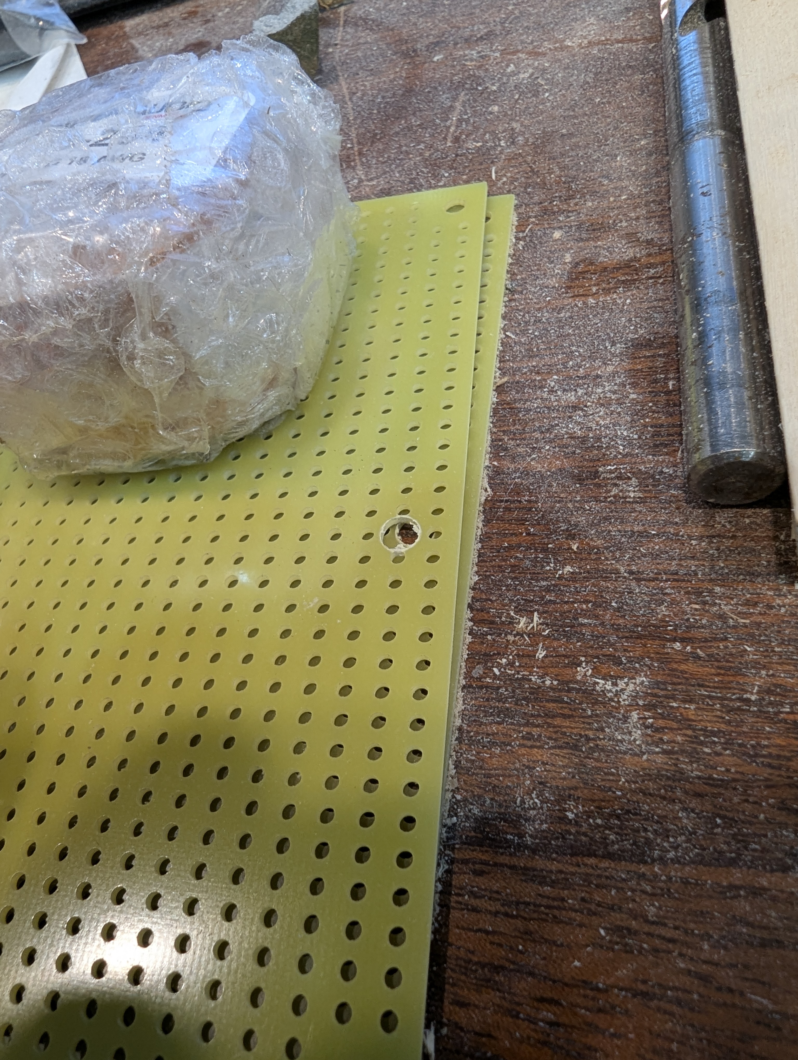

This was to screw the board down when I placed it inside the cabinet

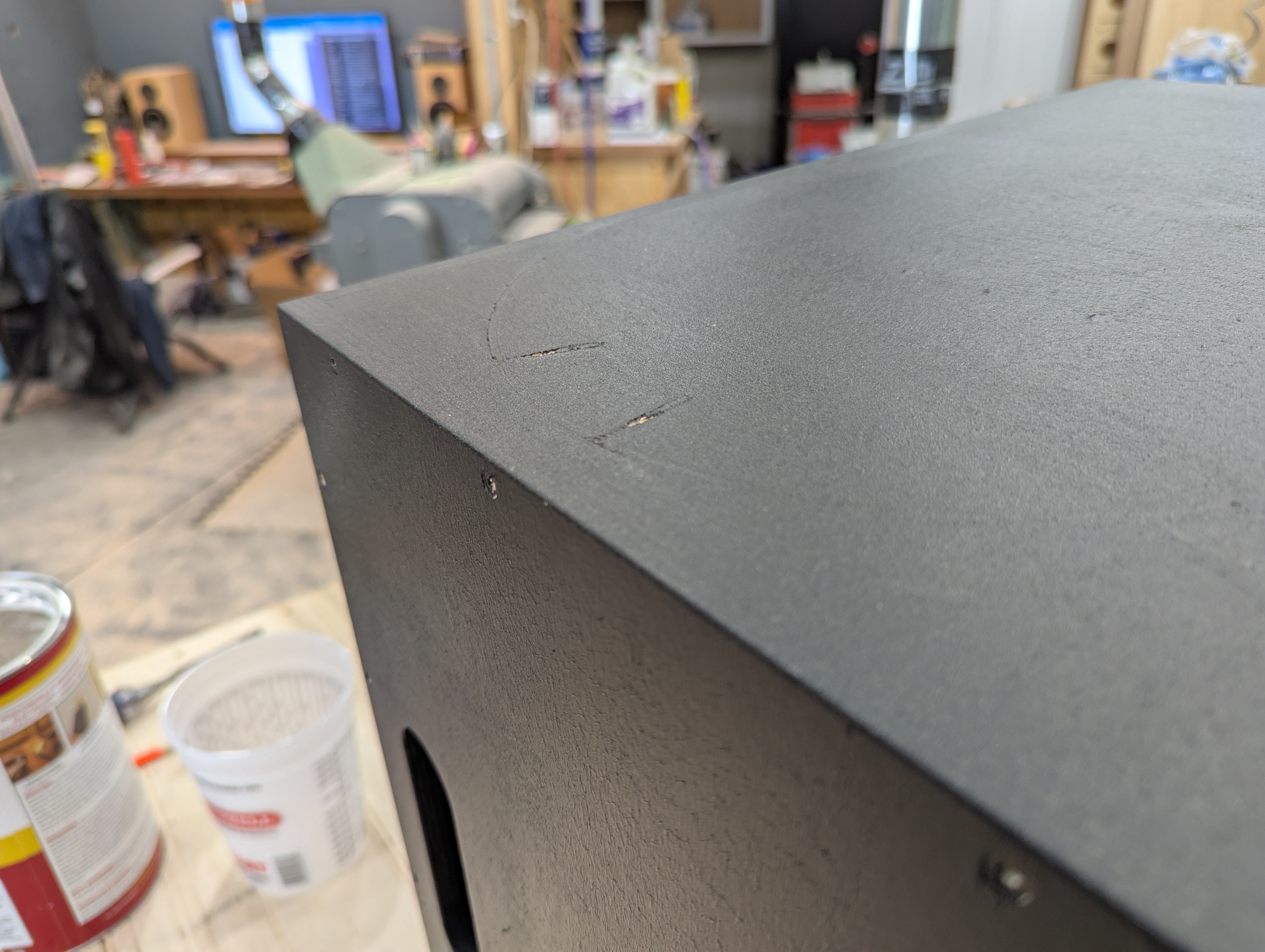

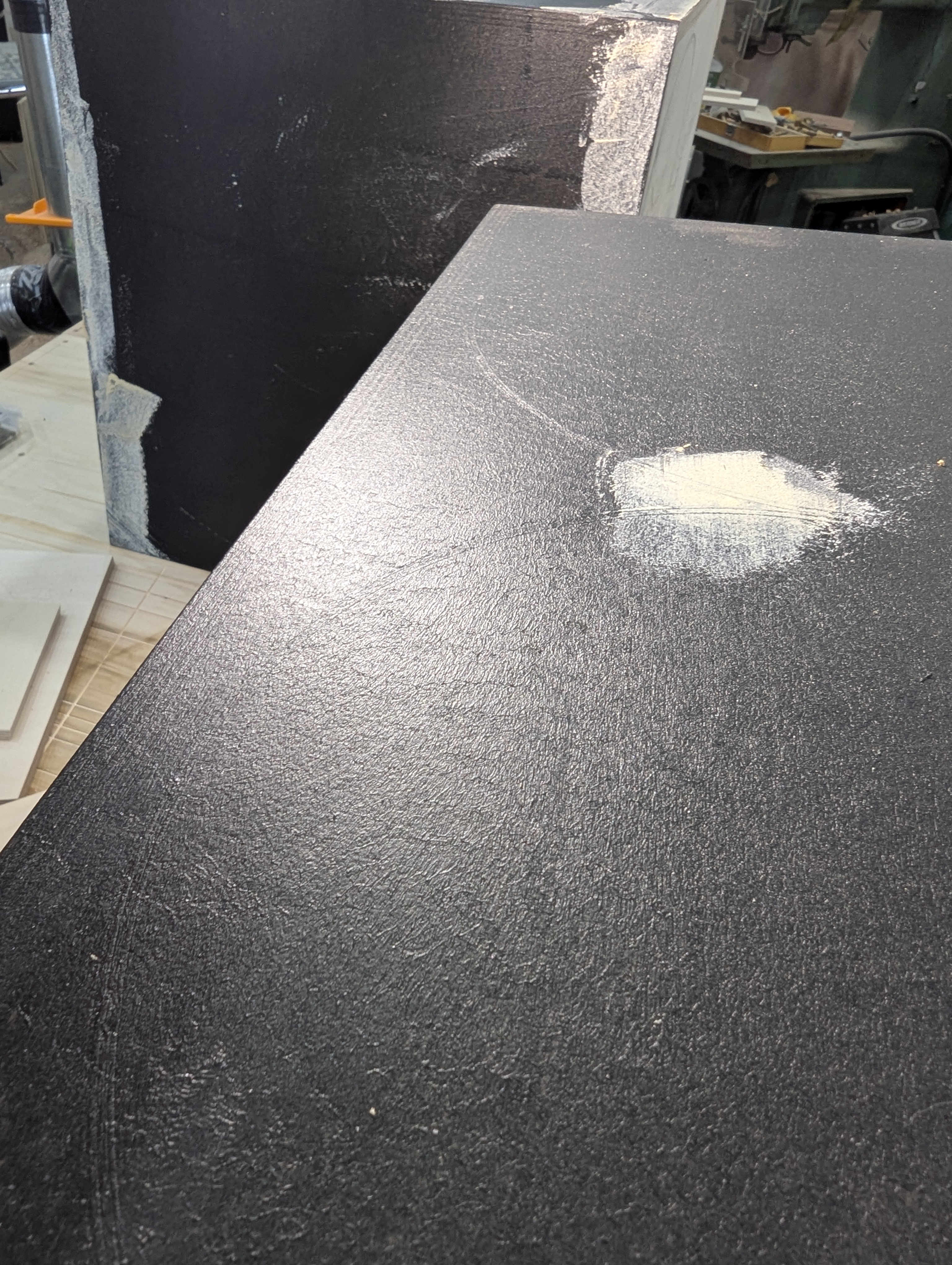

A little bit dusty, ready for the final walk through, clean it up, fill in holes, etc. Most of it is on the tweeter module, and unfortunately this is where my pictures stopped. I didn't get the final shot unfortunately. Total bummer.

That last picture is actually the final shot I grabbed before shipping it off to my customer. I got caught up rushing at the end and didn’t take nearly as many photos as I wanted. No interior shots of the high-frequency drivers—I just assembled them. They’ve got two solid Eminence compression drivers inside, so they’re built to perform.
I skipped grills and top hats because I like the raw look. The last photo you see is before I dropped in the dispersion rod on the HF module.
