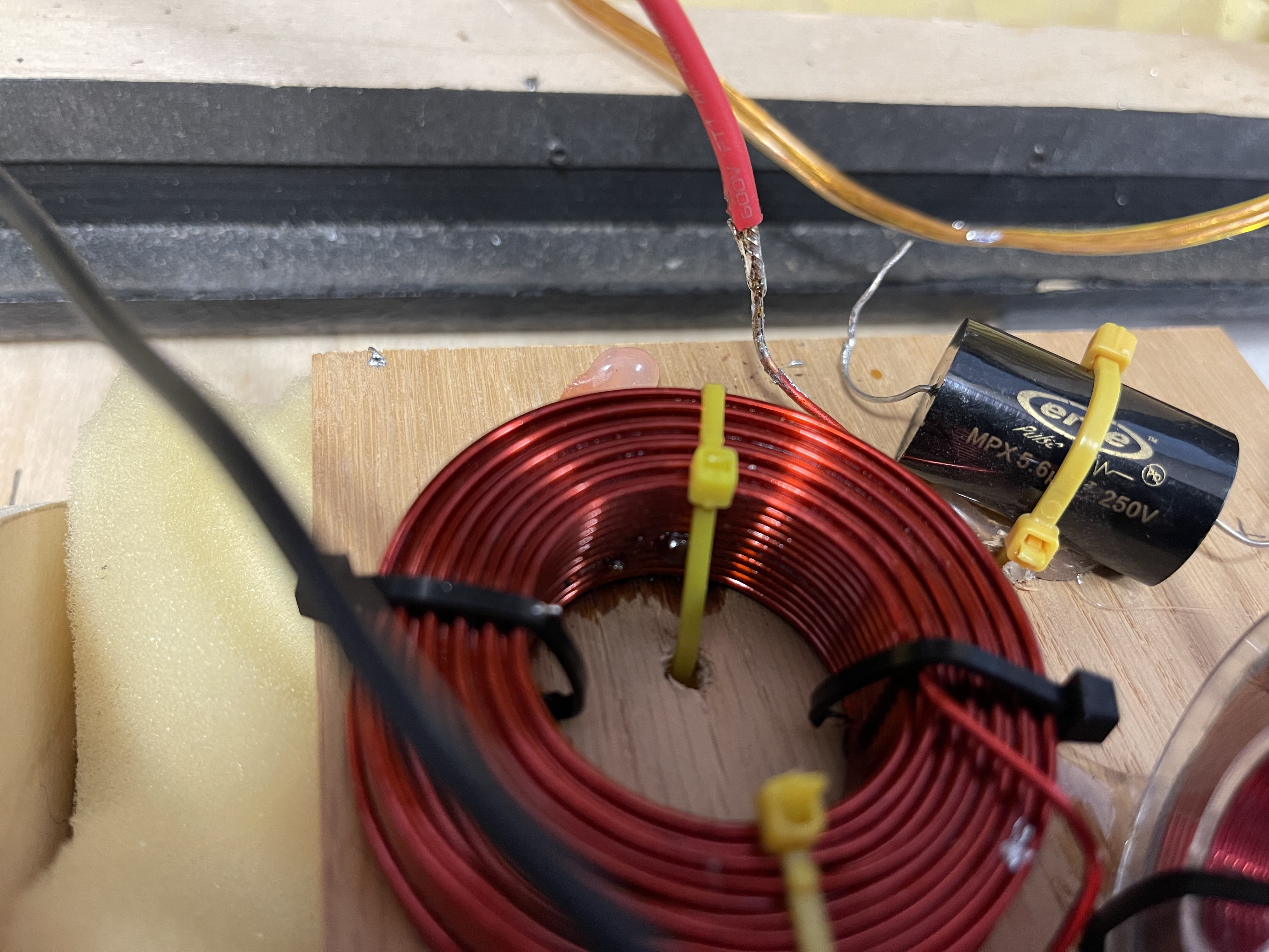

Well, Tom and Seth.....you're right!
So, been testing it and it's been good everytime. I decided to jut button it up and go from there. As I was checking one last time to make sure the crossover was secured properly, I decided to feel the end of the caps to see if anything was bulging....then I saw the problem...
Right now, you're probably wondering if the doddering old fool is blind, stupid, or both......well, you're wrong!
Here's the pic I took while it was acting up.
The lead from the cap was burned through. I guess that's when it gave up the ghost. Now, as to why it didn't do that at the show last Thurday and just started working - who knows?
What's surprising is that the cap is part of the low pass filter, not the high pass. We were all examining the top end.
I need to order one of those.......just as an aside ....... what would happen on the low pass if you took that cap out totally?

Well, you ain't gonna' believe this, but I installed the new cap......and the screeching is back. I guess the cap was the weak link and burned up. But, the problem is still there. Could the inductors or the other caps be the culprits?
I'm at a loss.
I'm at a loss.
- Posts: 8539
Re: Problem with OTop12
Okay, I did what Bill suggested in the beginning, I took out the highpass along with the array. Had just the low pass and the woofer hooked up......squealed like a pig.
Examined the inductor closely and saw some seepage on the inside of the coil. In the pic you can make out a little of it up by the yellow zip tie.
I guess I need to find one of those now....

Digging back through the plans becasue I seem to remember something about wire size of the coils....but, can't remember if it's to get the largest gauge or the smallest. And I can't find it - even looking at the old plans and the newer ones.
- Posts: 28916
It's not the gauge size that matters, it's that the DCR of the 0.6 mH coil no more than 0.4 ohms. A solid core may be less expensive than an air core.
- Posts: 8539
This one is just under .4 DCR.......does it look ok? It looks just like the one that's in the cab now.Bill Fitzmaurice wrote: ↑Thu Mar 27, 2025 4:39 pm It's not the gauge size that matters, it's that the DCR of the 0.6 mH coil no more than 0.4 ohms. A solid core may be less expensive than an air core.
That seems so weird. Not that I'm a electronics buff at all, but I've really gotta stretch my imagination to even begin to hypothesize how something like a short in the coil could cause the noise. Wow. Better call in Agents Mulder and Skully from The X-Files to investigate.
I am wondering if the coil was an on again/off again short, which reacted with the cap, causing an oscillation at the right frequency, while reacting with the amp. Just throwing darts.Seth wrote: ↑Thu Mar 27, 2025 7:33 pm That seems so weird. Not that I'm a electronics buff at all, but I've really gotta stretch my imagination to even begin to hypothesize how something like a short in the coil could cause the noise. Wow. Better call in Agents Mulder and Skully from The X-Files to investigate.
