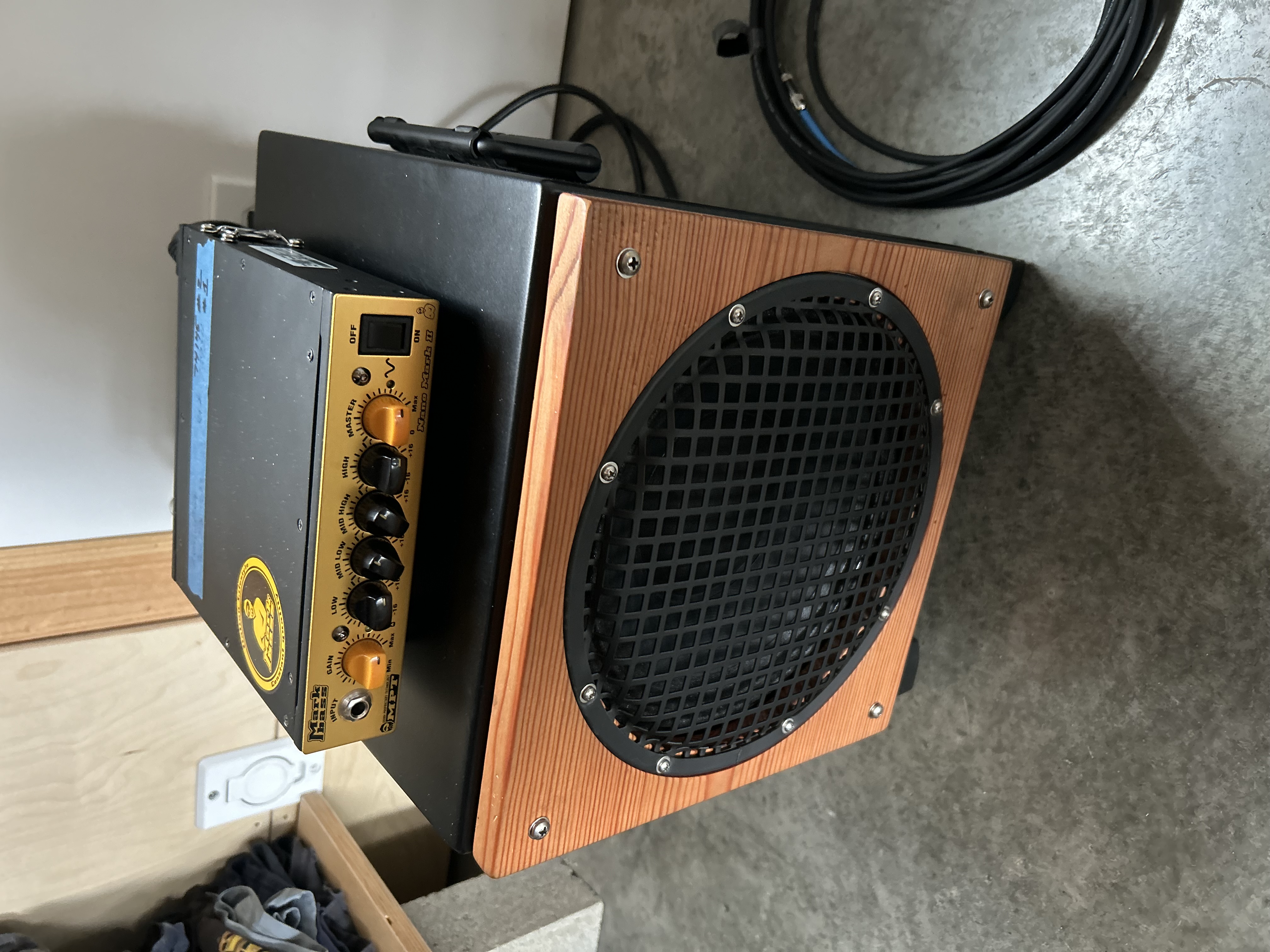

Hello All,
Lifelong drummer here having made the leap two years ago
to see what the other half of the rhythm section was all about. Settled on a G&L short scale with flats. Bought a small Markbass Nano amp and got creative salvaging a home stereo Martin Logan subwoofer cube. Pulled out the dead electronics and swapped the metal cone 10" driver for an
Emminence Deltalite 2510 ( 4 ohm darn). Works pretty good as a practice set up. But now time to up the cabinet situation. A 110 Jack lite seems a good starting point. Baltic delivering today.
Of all the questions I could ask, please let me start with this. Knowing some would say forget tweeters, could someone plz describe the audible difference between using the compression horn design vs the piezo melded array? My
instinct is to go with the horn and add an on/off switch. Want to keep options open as this cab might see use beyond just bass.
Thanks Bill & community!
